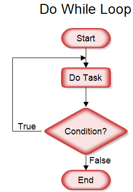

I still find your flowchart to be incorrect. To show waiting for something in a loop there should be a 'if' statement that loops backward like this:
