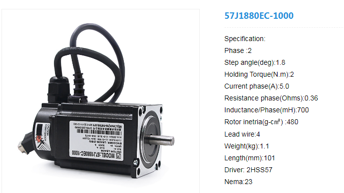

I have Kflop board and kstep board. using those boards we tried operating 3 stepper motors. But Now we bought 3 Step Servo Motors along with its drivers (57J1880EC-1000 with 2HSS57 (Maxima Stepservo Motor with Encoder)).
In this image the motor has two wires one is used for motor supply and other wire is for encoder feedback.

KFLOP should be able to provide Step/Dir signals to those drives using KFLOP's 5V open collector (common anode) mode. See here. Note your wires show +24V connected to the Drives. This should be changed to +5V or there may be damage to KFLOP.
KStep would not be needed.

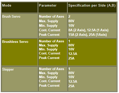

I need some clarification in this snap amp that in the manual they have stated
Each side (A, B) has 4 half bridge amplifiers capable of driving either:
1 stepper motor
1 brushless motor
2 brush motors
is it possible to run 4 servo motor(closed loop) with 1 snap amp orelse we need two snap amp.
It depends on the type of servo motor. 1 SnapAmp can drive (4) DC brushed Servo Motors or (2) 3-phase brushless DC Servo Motors.
