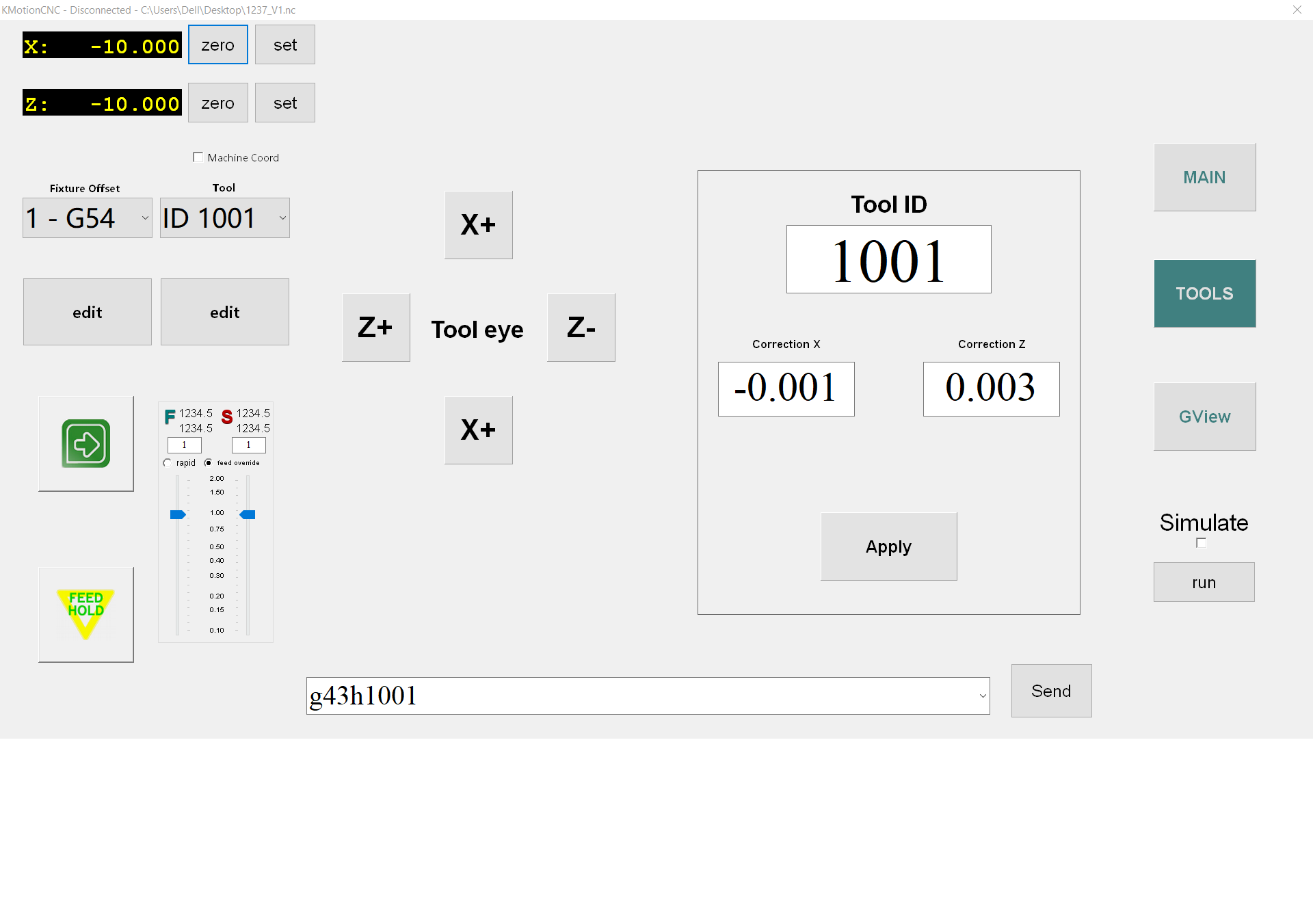

With a spec screen I want to be able to make tools correction as available on commercial lathes, spec screen is ready but I have issues (as usual) with the C program, reading the content of the Edit button works perfectly. But I do not manage to get the tool length or offsets. Rigth under the code with some lines in comments for simpler trials :

Hello Tom,
That unfortunately will not work as the tool to be corrected is not always (rarely) the active tool, target is really to be able to make corrections while a program is running (with bar-puller for example).
