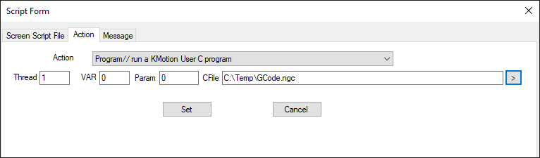

You can also define an Action to execute a Program and if the extension of the file is .ngc it will be executed as GCode instead of a C Program. Screen script can be used to define the Action.
Then executed from KFLOP with:
There isn't a method for entering text into the GCode Control.
It might be much simpler to just move the axes to a position with the C Program.
But there is an MDI command to execute one line of GCode.
if (ScreenScript("Action:4;1;0;0;0;0;C:\\Temp\\GCode.ngc"))
