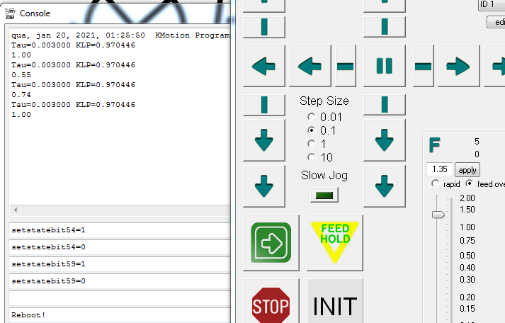

The safest is to go with a Hardware FRO of 1.
When using this setting and FRO over 1 in kmotion, is there a way to read it ?
Or the CS0_LastFRO just read <1 ?
Also, another question. On startup or reboot, are the persist.userdata always cleared? If I use one to set that the axis were homed, is garanteed that on startup it will be 0 ?
Thanks Tom
