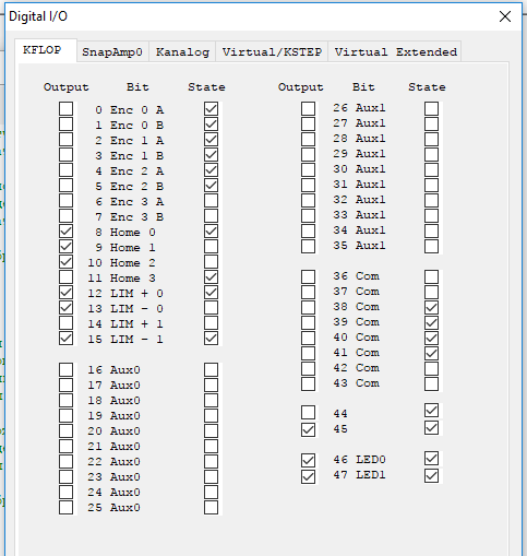

Hello everyone! Can't zero axes on Kflop+Kanalog board. I use virtual bits 36 and 37 of Kanalog Board JP2 terminals to zero axes by encoders' zero marks, but it doesn't work. SetDirectionBit(36,0) and SetDirectionBit(37,0) are announced. I've tried to use virtual bits 6 and 7 of JP1 terminal to zero axis and it worked, but I need them for another device. Kmotion version is 4.34j. Please help :!:

Bits 36 and 37 are not Virtual Bits. Those are real physical IO Bits. They default as inputs so it isn't necessary to set their direction, but it doesn't do any harm. When using Kanalog, KFLOP Bits 36 and 37 receive the differential signals connected to Kanalog JP2 A4 and B4. Do you have your Axis 0 Index Pulse wired to Kanalog JP2 pins 1 and 2? Do you have your Axis 1 Index Pulse wired to Kanalog JP2 pins 3 and 4? This is described here:
http://dynomotion.com/Help/SchematicsKa ... analog.htm
You will also need the RJ45 connection between KFLOP JP5 and Kanalog JP9 for this to work.

You might check KFLOP IO 36 and 37. Unplug Kanalog. Set IO 36 and 37 as Outputs. Toggle their state. Check if they change.
You might Flash New Version to remove any configuration changes or programs you might have made. Then power cycle and test before running any of your C Programs.
