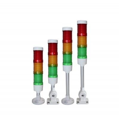

Hi tom ,
I want to make a CNC light indicator (Stack light) program which indicates different program states of the machine.
RED: Failure conditions such as an emergency stop or machine fault or alarm
YELLOW: and FEED hold condition Warnings such as over-temperature or over-pressure conditions (G code not running) , G code completed.
GREEN: Normal machine or process operation (G code running)
How to make that C program that monitor all above. ? and how to process with that ?
and how to integrate with KFLOP+KANALOG+KONNECT .

Hi Amit,
For this you might test any EStop you have or whether any of your axes are disabled (chx->Enable)
You should know what sensors you have on your system. JOB_ACTIVE being FALSE would indicate GCode not running
CS0_StoppingState != 0 would indicate a feedhold in progress.
JOB_ACTIVE being TRUE would indicate GCode running.

Hi Amit,
You might try something like:
include "KMotionDef.h"
#define RED 46
#define YELLOW 47
#define GREEN 48
void main()
	for (;;)					// forever loop
		if (CS0_StoppingState != 0)	// Feed hold ?
			SetBit(YELLOW);
			ClearBit(GREEN);
			ClearBit(RED);
		else if (JOB_ACTIVE)	// Job Active ?
			SetBit(GREEN);
			ClearBit(YELLOW);
			ClearBit(RED);
		else					// otherwise
			SetBit(RED);
			ClearBit(YELLOW);
			ClearBit(GREEN);
