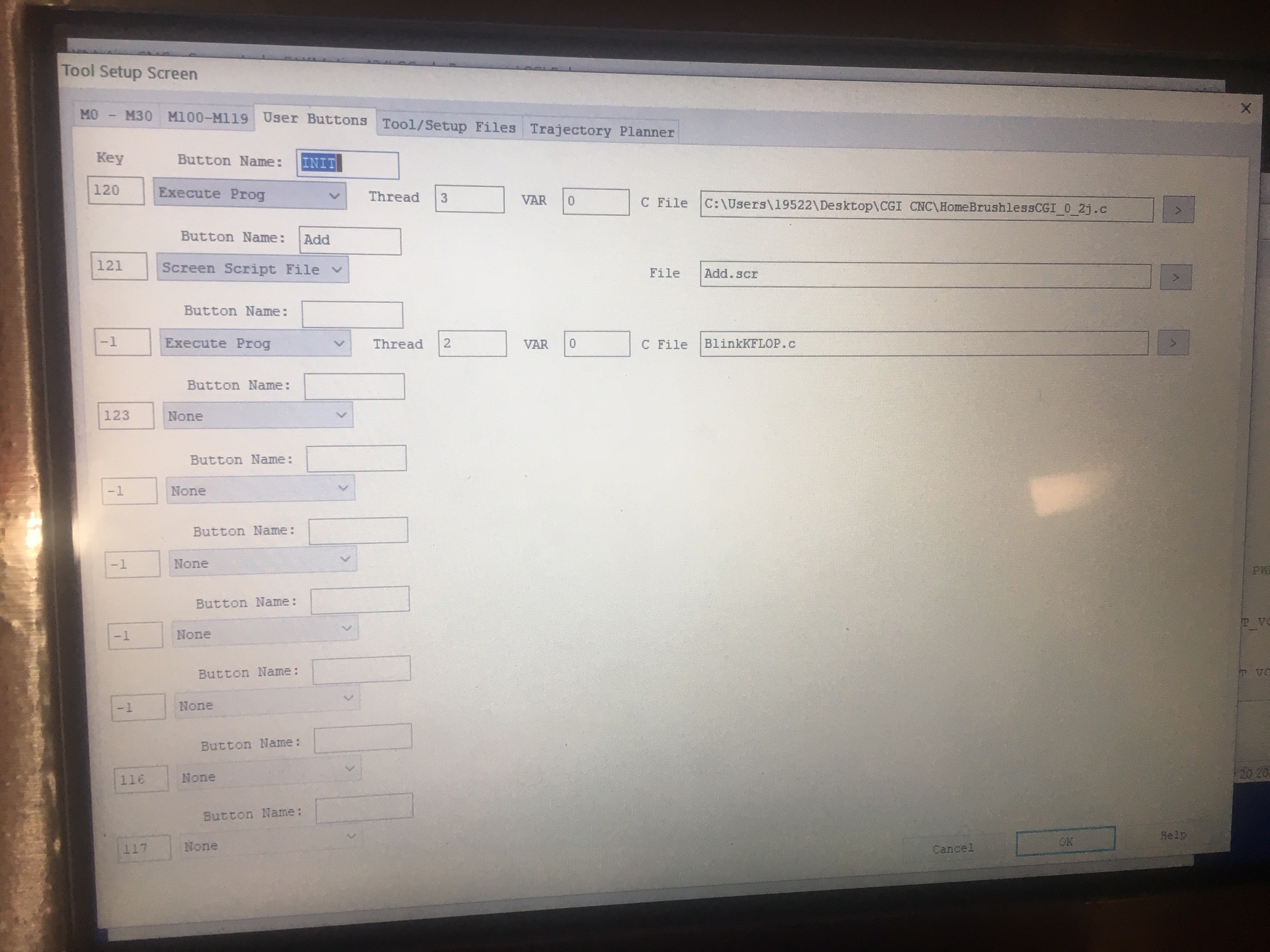

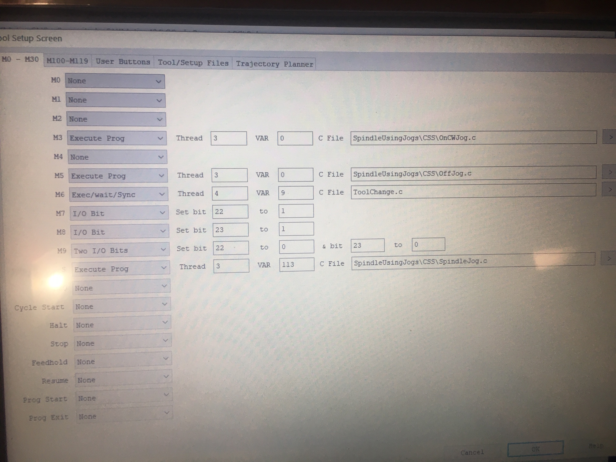

Re: C program stops when G code finishes
See attached photos. The C program is running in thread #3. I see where there are other C programs called by Mcodes and user buttons calling that same thread (#3) but I'm not activating those. I'm just running the G code program until it stops. Is there still some interference there?
AZ
AZ
- Posts: 2931
Hi AZ,
M2 causes the Program Stop and automatically turns off the Spindle by calling the M5 Action which you have set to use Thread #3.
