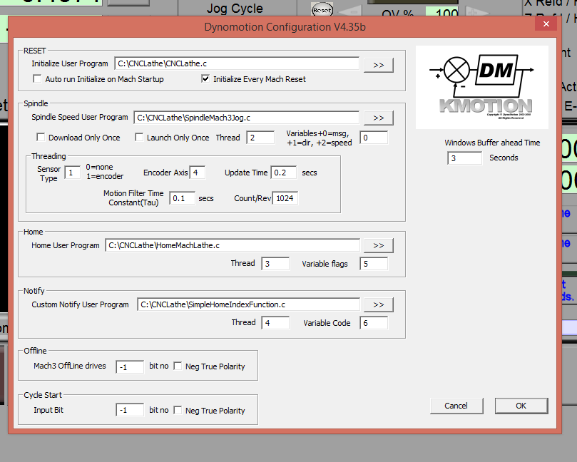

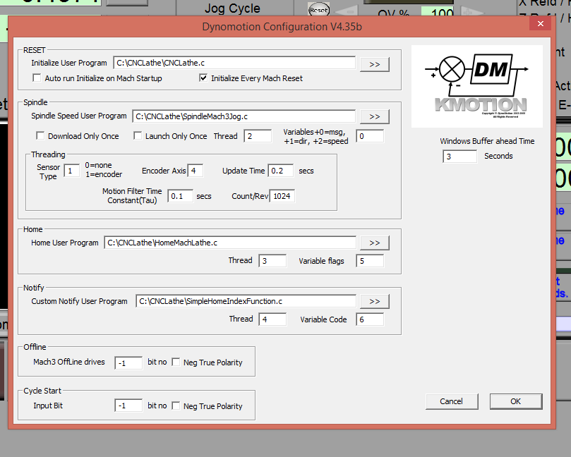

I think your Spindle Encoder is 2000 counts/rev not 1024 counts/rev as you have in the Mach3 Plugin Config. That would explain Threading not working.
Also Mach3 has this concept of "pulleys". So you would need to set which pulley is in use and set the max RPM for that pulley appropriately. Then make sure the Spindle C Program commands that speed when told to go 100% full speed by Mach3.

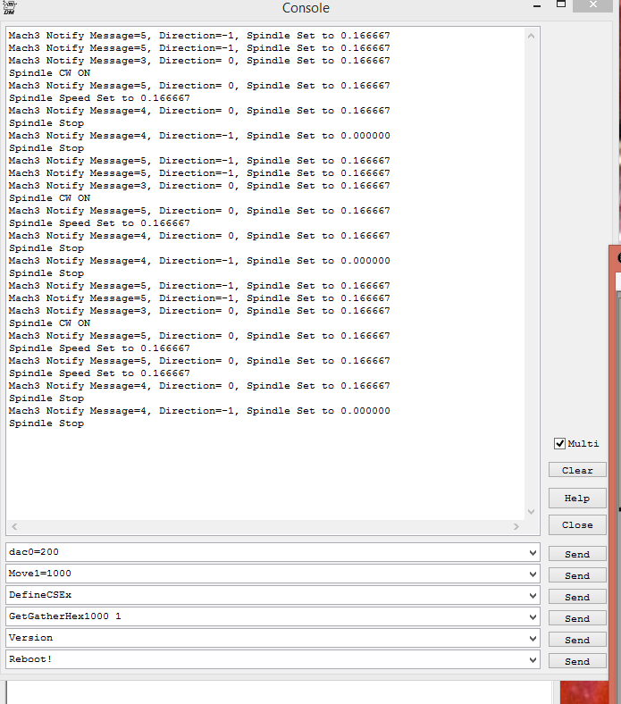

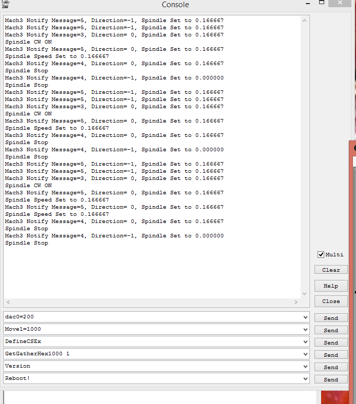

Thanks again Tom for your help. I missed seeing the incorrect count entry. I think the threading is now working correctly. In regard to the spindle not turning on all the time in Mach turn, I tried to get a better observation of the way it is acting. Once the spindle is on, changing the speed seems to always work. M05 always works. When M03 or M04 work, the console shows the actual running condition. When the command does not work, the console just shows M03 or M04. Observing the DAC output, when the spindle fails to start there is no indication of a change in output for the spindle. I know Mach is not your thing but thought this might mean somthing to you. I included a shot of the console readings.

- Posts: 2931
Re: Messed up program access
Hi Scott,
The attached program should command the Speed properly for a M3/M4 issued by itself.
I think your Spindle Axis acceleration might be too low. In CNCLathe.c I see:
ch4->Accel=10000;
So for example to change speed from zero to 1500 RPM will take:
1500 RPM / 60sec/min x 2000 counts/rev = 50,000 counts/sec
The time to accelerate (ignoring Jerk) would take:
50,000 counts/sec / 10,000 cnts/sec^2 = 5 seconds.
Command a low Spindle RPM then a high RPM (1500) and observe how long it takes the speed to change. Then try increasing the Acceleration to make it faster but not so much that it faults.
Additionally, the feedback gains are very low:
ch4->P=0.05;
ch4->I=0;
ch4->D=0;
Only P Gain = 0.05. This means it will take some time to generate a large enough error to output the needed DAC voltage to run at the desired speed. Try increasing this to get better response but not so much to have the speed become unstable.
Although these things would cause a slow, delayed, response not an opposite response as you seem to describe so possibly something else is also occurring. Please try these 2 things and see how things work.
I think the issue is that the way the C Program SpindleMach3Jog.c is written the S command is ignored when issued with the Spindle Off which is good and correct. But then if an M3/M4 (by itself) is issued to turn the Spindle On, the Spindle speed is not being set and remains zero.In regard to the spindle not turning on all the time in Mach turn, I tried to get a better observation of the way it is acting. Once the spindle is on, changing the speed seems to always work. M05 always works. When M03 or M04 work, the console shows the actual running condition. When the command does not work, the console just shows M03 or M04. Observing the DAC output, when the spindle fails to start there is no indication of a change in output for the spindle. I know Mach is not your thing but thought this might mean somthing to you. I included a shot of the console readings.
Lookahead shouldn't be a problem. KFLOP commands the spindle speed instantly based on the instantaneous X position.When trying to use the CSS it works correctly - adjusting the speed down when moving away from X center and speeds up when moving back in. In the attached example the spindle starts to slow back down 4 to 5 seconds before the X travel gets to the center or 0 position of X while moving in. That of course means I get a lower speed at the point I want the highest speed. It seem like the (look ahead?) is getting way out in front of the actual X position. Is there anything I can change or adjust in the program to get the actions to work together better?
