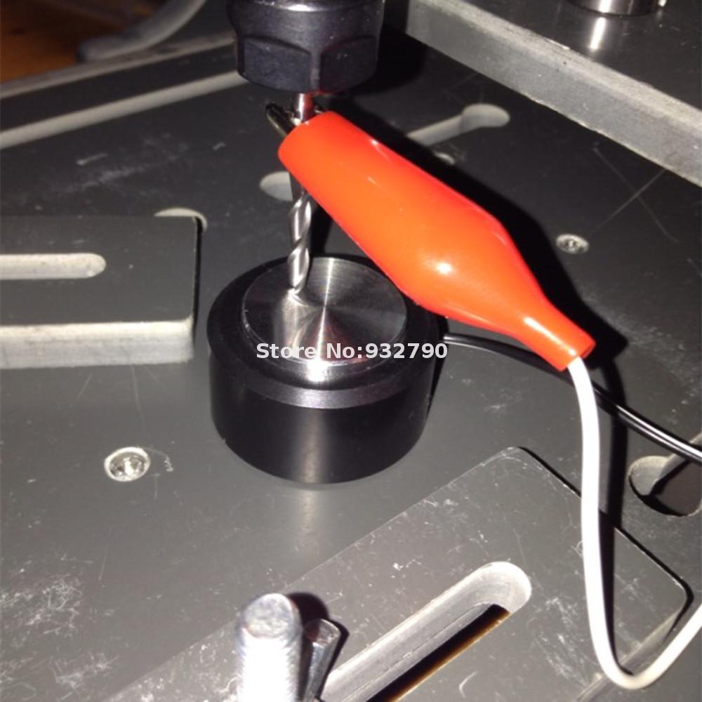

I bought a simple touch plate from Aliexpress for my 3 Axis router with Kflop control.
After reading some information about using DoPCFloat(PC_COMM_SET_X,0.0) I have more questions than answers.
The touch probe is connected via optocoupler board to Pin 6 of JP7. I need a C program that will work as follows:
1. I connect the sensor to an instrument
2. Press the button
3. Z axis starts moving down
4. When instruments touches the sensor it sets G54 Z work offset as 20mm (sensor's height)
5. Z axis moves up for 5-10mm
Most of hobby machines' users don't need a hassle with Tool Lenght Tables etc., just a simple routine like this. Thanks for an upcoming answer.

You might look at tthe ProbeZ.c example on how to move Z and stop when the probe triggers:
    Jog(2,-100);                       // move Z down slowly
    while (!ReadBit(1040)) ;           // wait for switch to go high
    Jog(2,0);                          // Stop
The SetFixtureZ.c example shows how to set the current Fixture Offset based on current Position which doesn't involve any Tool Offsets or Tables. You can include some probe offset if you wish.

Subtract 20.0 from NewOriginOffset.
Note a call to Jog requires only 2 parameters and needs a semicolon.
A MoveRelAtVel (axis, distance, velocity); would probably be more appropriate.
