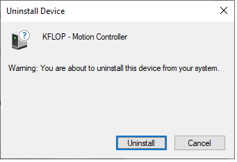

Re: USB driver not working
Posted: Sat Jan 19, 2019 9:17 pm
by Bernie
Here are some screen shots.
I then click uninstall, unplug the USB and plug it back in.
After KFLOP stops blinking windows tells me "that it is setting up the KFLOP Motion Controller,
and then, " device is ready - KFLOP Motion Controller is set up and ready to go"
Then it doesn't work.
Sorry to see you working on weekends.
Bernie
