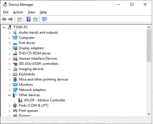

I am unable to get the USB driver working with KFLOP in Windows 10. When I connect KFLOP to a USB port after uninstalling the non functioning driver, Windows tells me "we're setting up KFLOP motion controller" and then, after a second or two, "KFLOP motion controller is set up and ready to go". When I then go to the Device Manager, I see the KFLOP motion controller under "other devices" with a yellow caution sign.
When I click on properties I am told "drivers for this device are not installed (code 28)". Going through the driver update routine does not work either.

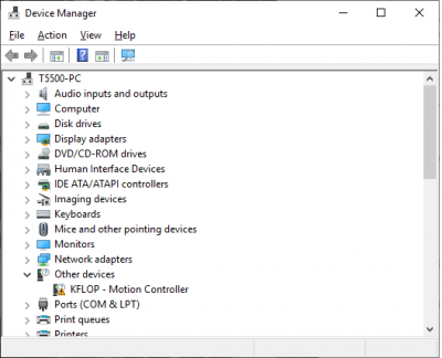

Post by Bernie » Sat Jan 19, 2019 9:17 pm
Here are some screen shots.
I then click uninstall, unplug the USB and plug it back in.
After KFLOP stops blinking windows tells me "that it is setting up the KFLOP Motion Controller,
and then, " device is ready - KFLOP Motion Controller is set up and ready to go"
Then it doesn't work.

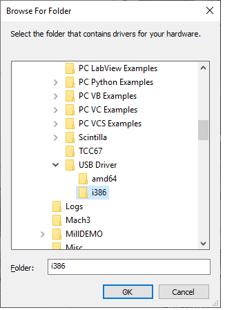

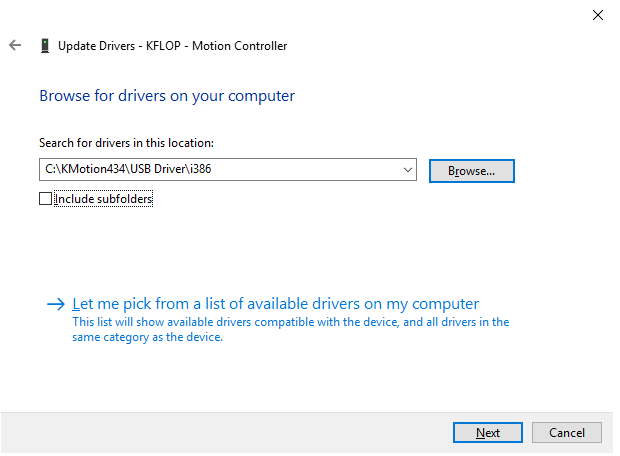

Post by Bernie » Sun Jan 20, 2019 4:28 am
When I click on the i386 folder no .inf file becomes visible.
When I use file explorer to look at the contents of the i386 folder I do see dynoport.inf.
When I right-click on dynoport.inf and then on "install", it gets installed but does't work.
You just gota love windows.
Bernie
Posts: 2913
Re: USB driver not working
Post by TomKerekes » Sun Jan 20, 2019 10:26 am
Hi Bernie,
Please select the “USB Driver” folder not the “USB Driver\i386” directory. You may need to check include subfolders. I386 is for 32-bit Windows. Is your OS 32-bits or 64-Bits?
