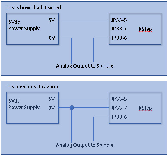

So my mistake was not connecting JP33-7 to PS ground. I looked at the KStep connector info but interpreted that if I was using it as a pot simulation I would need to connect the PS ground to pin7. I attached a wiring diagram...
