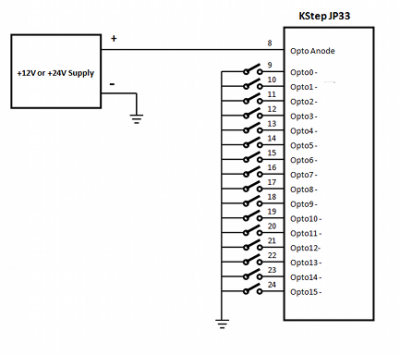

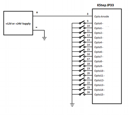

Now I want to connect the KStep and the Photoelectric switch by your suggestion. But I have another question for this picture.
I didn't deeply understand this part of the description. Is the 10K ohm series resistance already embedded in KSTEP ? How could I use it ?
The manual said "Shorting any of the OPTO- pins to GND will activate the input.", is that mean I need to short a not used pin to connect the GND pin(like the pin 24 connect to pin 26(GND), and I normally use the pin 10 to pin 23 to accept the signal from the photoelectric switch)?

Post by TomKerekes » Sun Jun 22, 2025 11:42 pm
Yes. The resistor limits the current so that when 24V is applied the LED has enough current to turn on but doesn't have too much to burn out.
This image in the Help shows how to wire the supply and switches. Note the GNDs shown are different from KFLOP or KSteps GNDS
