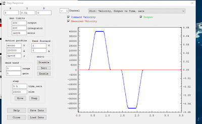

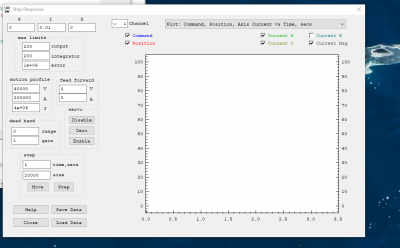

Itook screenshot of the step response but don't know how insert them.
Re: Stepper motor #1 axis
Posted: Tue Dec 10, 2024 8:42 pm
by DrillBitBob
Step response
Step response screenshot
Posted: Tue Dec 10, 2024 8:54 pm
by TomKerekes
Hi Bob,

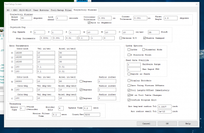

I don't see anything unusual. Post your KMotionCNC | Tool Setup | Trajectory Planner Screen so we can see the axis resolution and Jog Speeds.
Please describe the behavior more clearly. Is the problem a position related thing. ie any moves beyond 6 inches cause the "growl"? Or is it "growling" whenever moving 6 inches all at once?
What is the range of travel of your system? Could it be mechanically binding?

by DrillBitBob
trajectary planner
I changed the jog to .75 on the y axis and the growling disappeared. Not sure how that is going reflect maximum travel speed when I run a program.
I will continue to for mechanical binding but since it works great in step response for moves of 10 inches +- . Thank you for all your help. Happy Holidays
Posted: Wed Dec 11, 2024 4:53 pm
by TomKerekes
Hi Bob,
Sometimes a Stepper axis can have a resonance that is excited when moving at a particular speed. Higher or lower speed may not show any issue. You might try the Step Response Screen at a speed of 16238 steps/second which would be a speed of 1 inch/second to see it that speed is an issue.
Unfortunately a Milling machine should be able to move at all speeds without issue.
A test I like to do is to set the acceleration very very low. In this case the speed will gradually ramp up to test moving at all speeds.
Jog speeds have no effect while running a Job.
I see the Axis Parameter Speeds are limited to 10 inches/sec. That would be 162380 steps/sec. But you are only testing 40000 steps/sec in the Step Response Screen so maybe you should reduce those. This won't matter unless you command a Feedrate higher than the limits. Similarly Acceleration is set at 30 inches/sec2 but you only test 12.32 inches/sec2.
You might read this wiki article.
