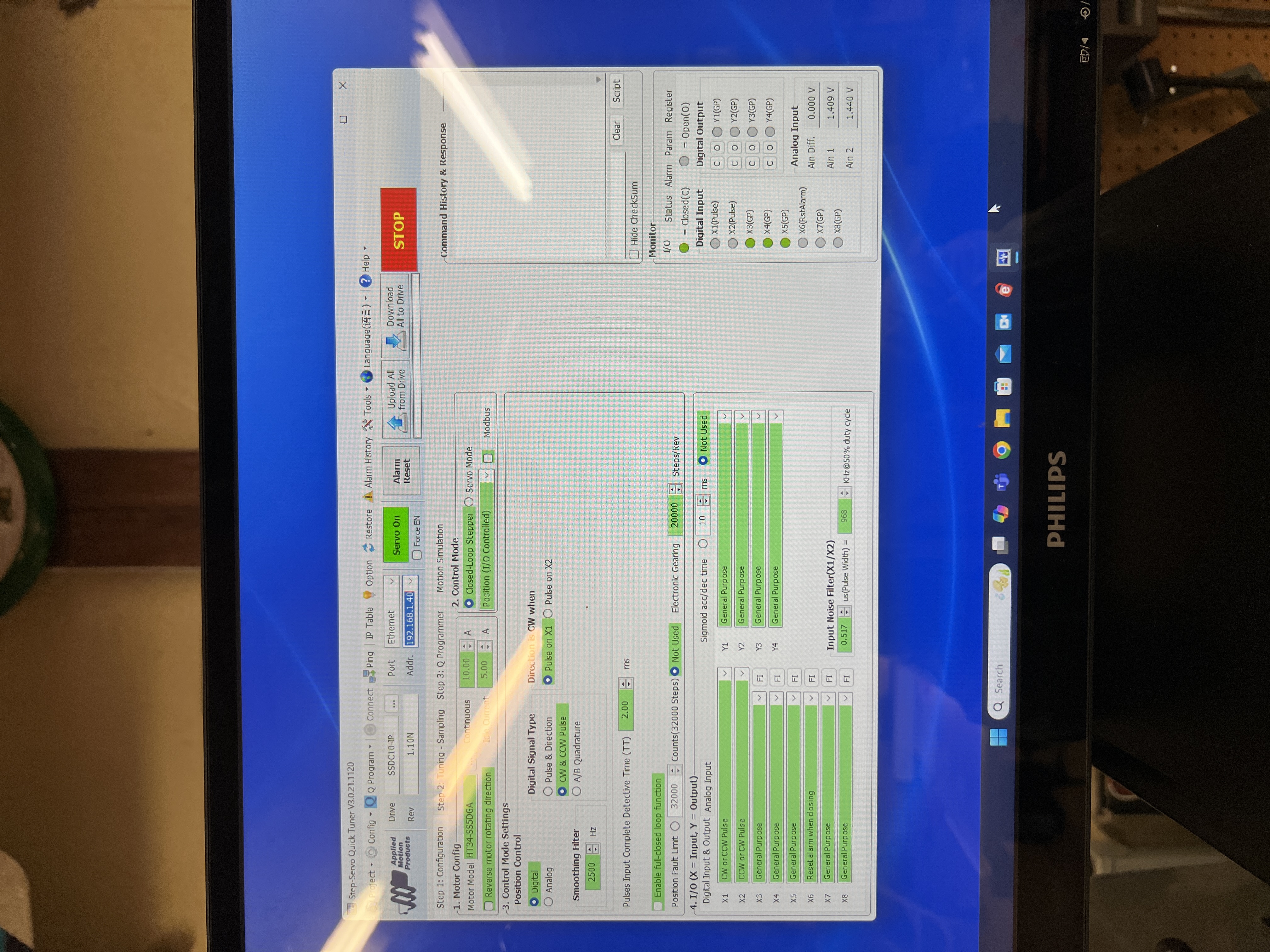

I have loaded KMotion immediately after this happens but see nothing except the position (encoder) pulse counts, without destination pulses counts, on the Axis screen. All axes are disabled. There is nothing displayed in the console window, except the normal startup message. I suspect this is because it only displays what happens AFTER the software is loaded.
Interestingly, when I turned it on just now to double check the names of the column titles on the axis screen, the Z axis motor (Ch2) turned on and ran until hitting the limit switch. This is the first time (that I can remember) that this axis was involved. Again, it's most often Ch1 and Ch3.
I am not sure if I flashed something to KFLOP inadvertently.....anything is possible. I will reflash the New Version now.

Hi Jim,
I'm not familiar with those drives, but I would think since they are closed loop if they somehow though they were supposed to be at some destination but the encoder position was somewhere else they would try to move to reduce the difference when enabled.
How are the CW CCW signals wired? Until the axes are configured these outputs would be floating so potentially could pick up noise to cause the Drives to step. I think this is unlikely but ideally the Drive enables would be interfaced to KFLOP. That way KFLOP could enable the drives only after everything is configured.
Do you have limits interfaced directly to the drives?the Z axis motor (Ch2) turned on and ran until hitting the limit switch.
You might have checked if the Axis were configured as default 'No Output' or something else.but see nothing except the position (encoder) pulse counts, without destination pulses counts, on the Axis screen. All axes are disabled.

The CW CWW inputs to the drives are wired directly to the KFLOP outputs for each axes. Your thought that they may be 'floating' and picking up interference is a great one. Having the drives enabled by KFLOP is a also a very good idea and I think the hardware/wiring part would be easy, as I have already routed each drives' 'servo on' wiring to a central location.
How would I go about this within the KFLOP software? Is there a way to insert a command into KFLOP's initialization program to send a signal to one of the SW pins on the Kanalog board? I already have SW3 connected to an unused relay that could easly be used to enable the drives....

SetBit() and ClearBit can be used to control Outputs.
Often a forever loop is used to monitor the axis enable and if it is disabled then the Drive is also disabled. See the 'watchenable.c' example.
SetBit(152); // activate Kanalog FET Switch #0HTH

Thank you Tom.
I made some simple wiring changes and now all of the drives can be enabled using SetBit(155);
I looked at the watchenable.c script and can see how it would be very useful.
How is the program called?
Is it added to the initialization program?
Jim

Yes. It can be added to the end of the Initialization C Program so that after KFLOP is initialized the loop is executed continuously. See here.
Re: Stepper motor runaway at startup
Hello Tom,
Everything now is working as expected. The startup runaway problem was solved by having KFLOP enable the drives - Thanks again!
Is there a way to have the KFLOP also disable the drives when KMotion or Mach3 is closed, rather than when the KFLOP board is rebooted or powered down?
The way I have it set up now is that the drives are enabled/disabled within the initialization program, using the watchenable program, whenever any axis is enabled/disabled. I've noticed that if I cut power to the drive/VFD circuit, and KFLOP is still powered, the SetBit activated relay that enables/disables the drives remains in the 'ON' position - it only resets to 'OFF' when KFLOP loses power or is reset.
It is rare that, when the CNC machine is being used, that KFLOP might remain 'ON' while the drive power circuit is 'OFF', but it could happen. If it did, the drives would power-up 'enabled' rather than 'disabled' and the runaway problem might rear its ugly head again.
Didn't know if there was also another software failsafe fix to this avoid this potential hardware occurrence.
Jim

Whenever Mach3, KMotionCNC, or, KMotion is running status is continuously being polled from KFLOP. KFLOP maintains a counter of the number of status requests that have been made. StatusRequestCounter. When al the PC apps are terminated, or the PC is turned off, the status requests will stop and this can be detected and used to do whatever you wish. See the WatchdogStatusRequests.c example.Is there a way to have the KFLOP also disable the drives when KMotion or Mach3 is closed, rather than when the KFLOP board is rebooted or powered down?
Well I don't think KFLOP has any way of knowing that Drive Power has been turned off. Is there a Drive Ready signal or something that could be interfaced to KFLOP so it can be aware of this? If so KFLOP could detect loss of Ready and disable all the Axes and Drives.The way I have it set up now is that the drives are enabled/disabled within the initialization program, using the watchenable program, whenever any axis is enabled/disabled. I've noticed that if I cut power to the drive/VFD circuit, and KFLOP is still powered, the SetBit activated relay that enables/disables the drives remains in the 'ON' position - it only resets to 'OFF' when KFLOP loses power or is reset.
I don't think watching for the Apps being closed solves this problem. The Apps might remain open but power to the Drives switched off and back on. In this case KFLOP remains configured so the Step/Direction Outputs would remain driven (not floating), so maybe that solves the runaway problem. It seems we never determined why the drives were running away.It is rare that, when the CNC machine is being used, that KFLOP might remain 'ON' while the drive power circuit is 'OFF', but it could happen. If it did, the drives would power-up 'enabled' rather than 'disabled' and the runaway problem might rear its ugly head again.
