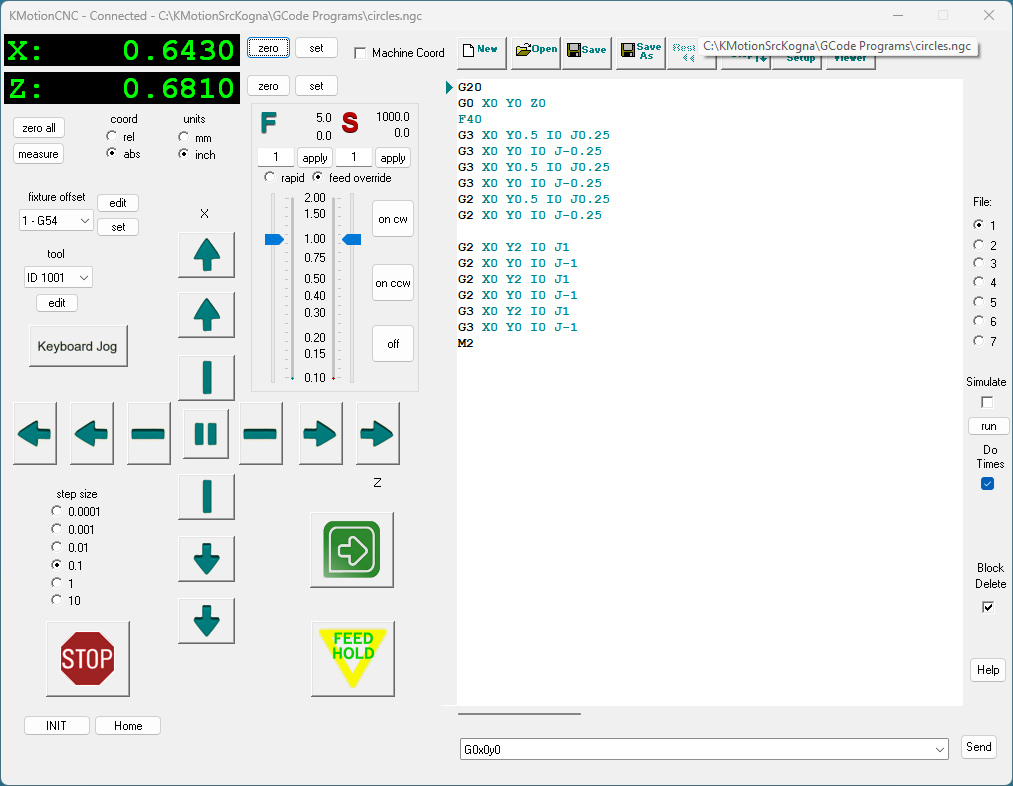

Dear All,
I'm looking to implement a 2 axis turning cnc machine operator panel, interested in examples and suggestion etc.
Option1 : Use a touch monitor with basic external buttons like Inti, Start, Stop, Feed-hold, E-stop and Reset.
Option2: Build a button based panel similar to industry standard and interface via Konnect Optical I/O Expansion Board.
In using option 2, i have few questions as to how does one assign kmotion screen icon buttons to Kconnect like below icons.
1. Zero all icon button.
2. measure icon
3. single step
4. Tool setup
5. Feed and Speed over ride icons
6. Jog icons
7. Jog step size
8. Tool
9. Fixture offset etc
Thank you

- Posts: 2943
Re: Kflop machine operator panel ?
Hi Sahil,
Option 1 wouldn't then be external buttons would it?
You might see the ExternalButtons.c, JogWithTogglesAndPot.c, and KFLOPtoKMotionCNCScreenScript.c examples.
That was my last option and less work too.Option 1 wouldn't then be external buttons would it?
Thanks will study the C program examples.
Sahil
From where can i get the screen script for basic 2 axis lathe. I'm beginning to understand how screen editor works and want to assign hotkeys.
Sahil
Sahil
- Posts: 2943
Hi Sahil,
I created it for you. See attached.
- Basic 2 Axis lathe.scr.txt
- (66.39 KiB) Downloaded 1120 times
