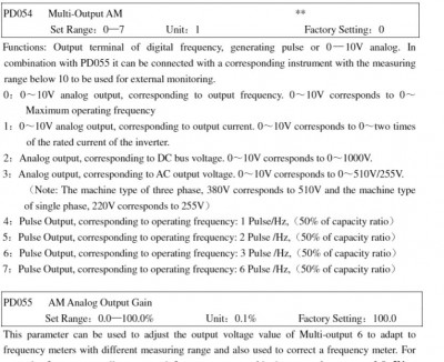

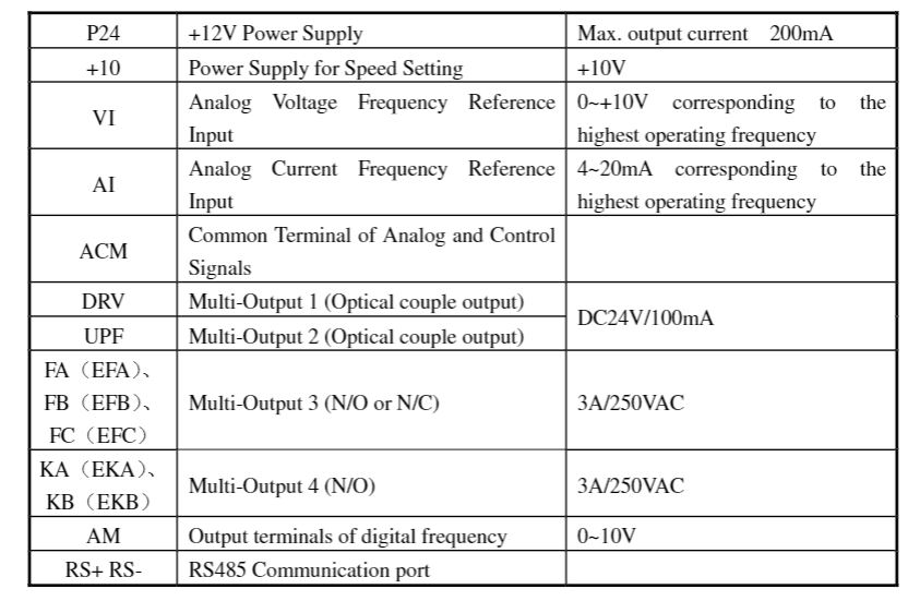

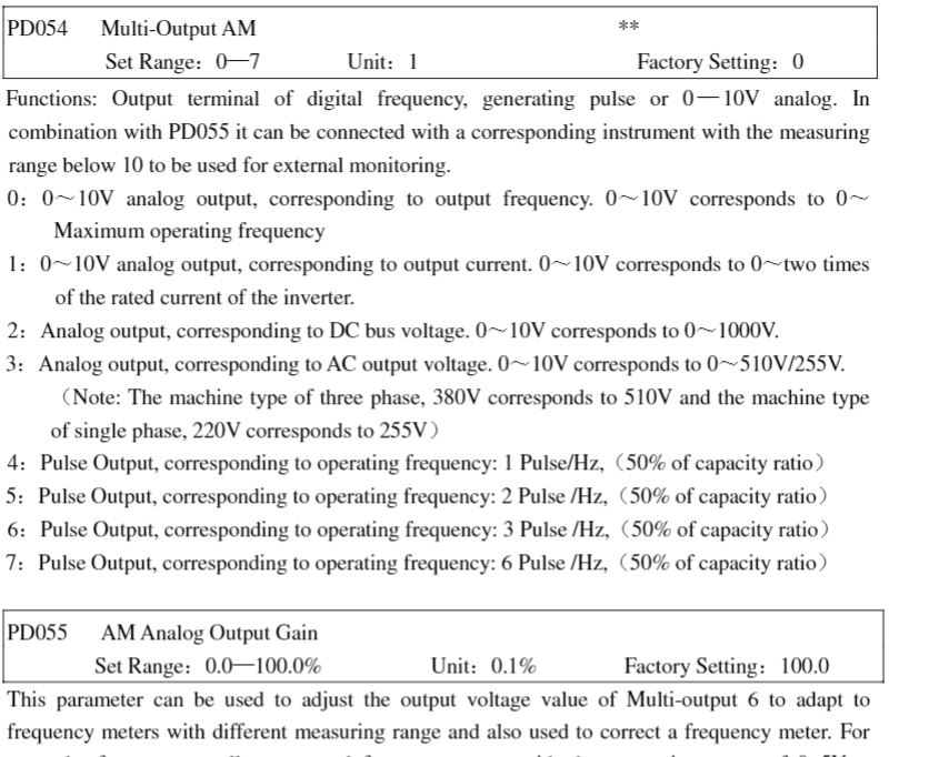

It does appear that there is an output that could be used for feedback to the Kflop with a couple of different operating modes. See attachment. This is all the documentation I can find at the moment. Is there a sample C program that I might be able to use for this feedback loop?

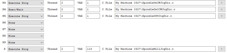

Usually you are required to modify those program's defines for your system. Please post the exact 4 programs you are using.
Also post KMotionCNC's Tool Setup's configuration for those files.

See Attached.Usually you are required to modify those program's defines for your system. Please post the exact 4 programs you are using.
See Attached.Also post KMotionCNC's Tool Setup's configuration for those files.
