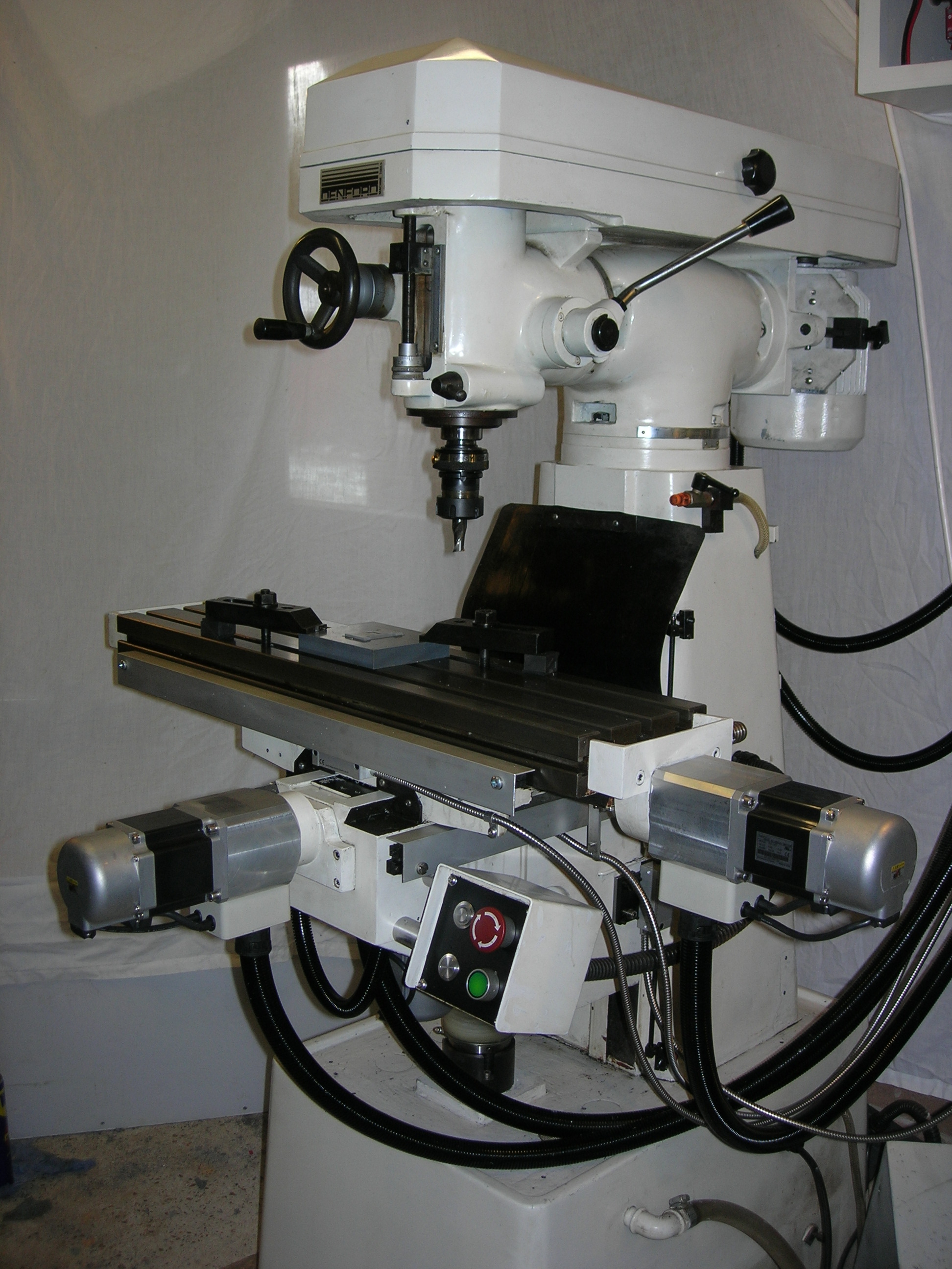

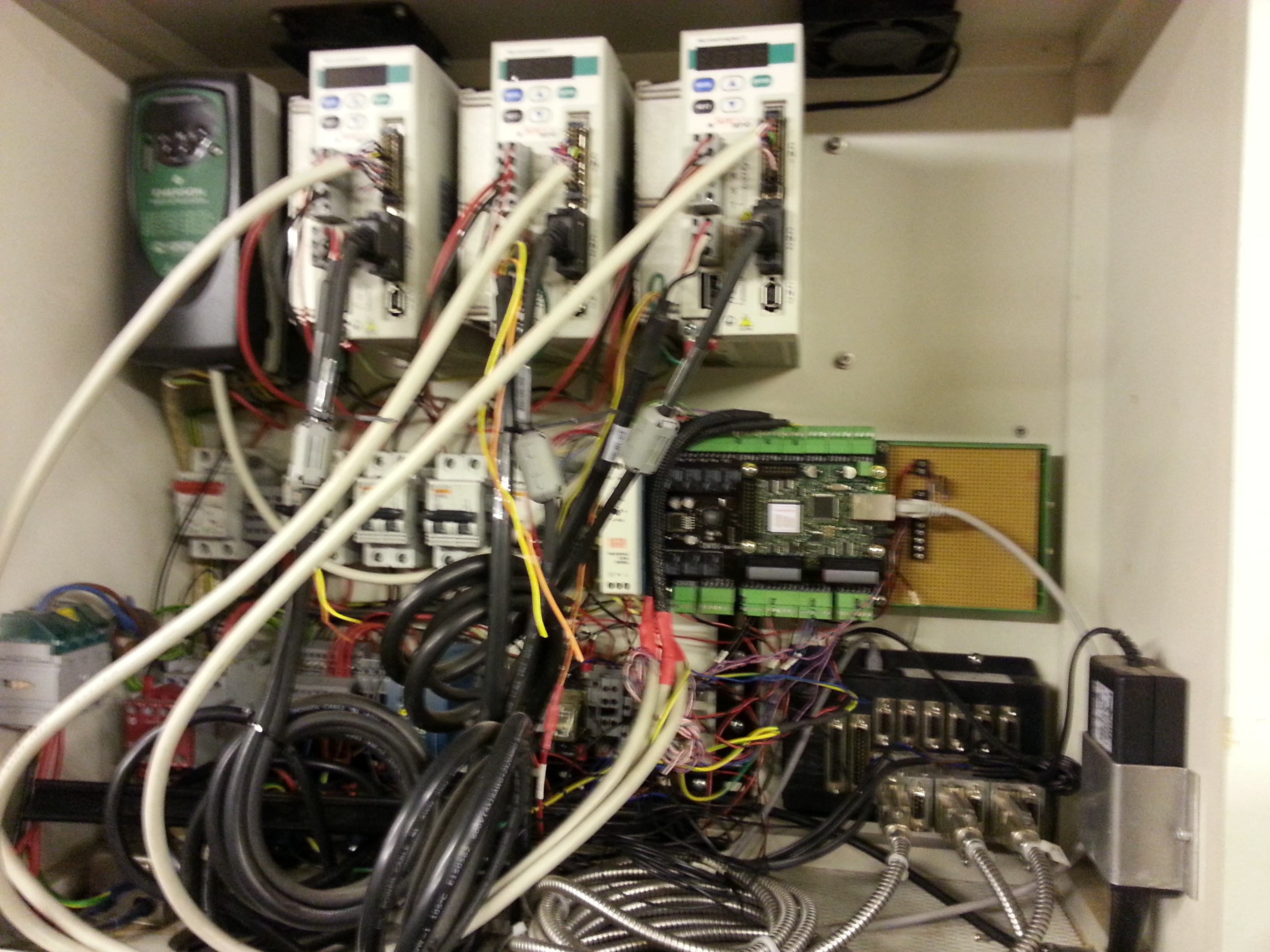

I've attached a couple of photos to show the kind of machine and setup I've got. It's a very capable metal cutting mill, but it's potential is being limited by the motion controller.
