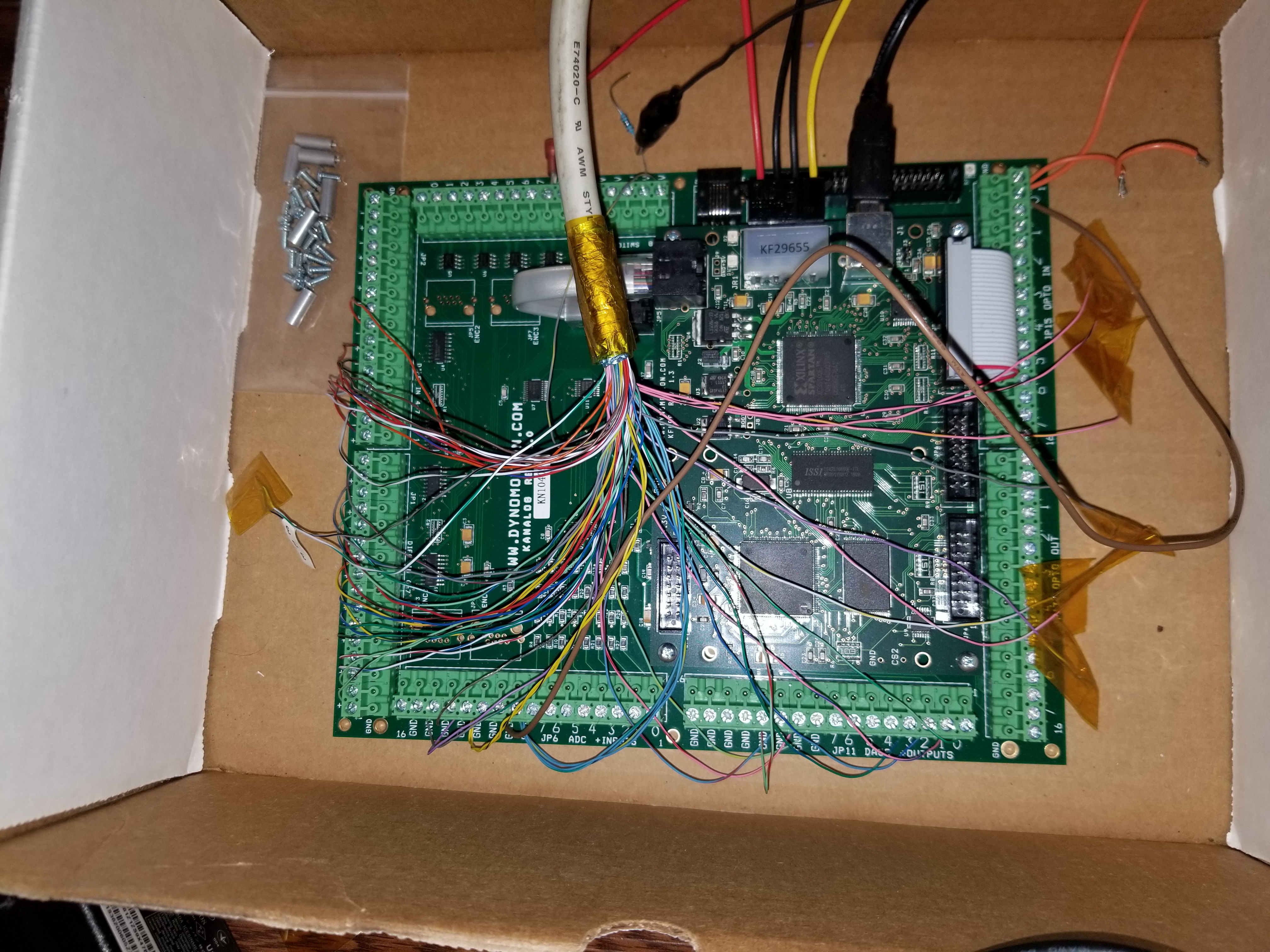

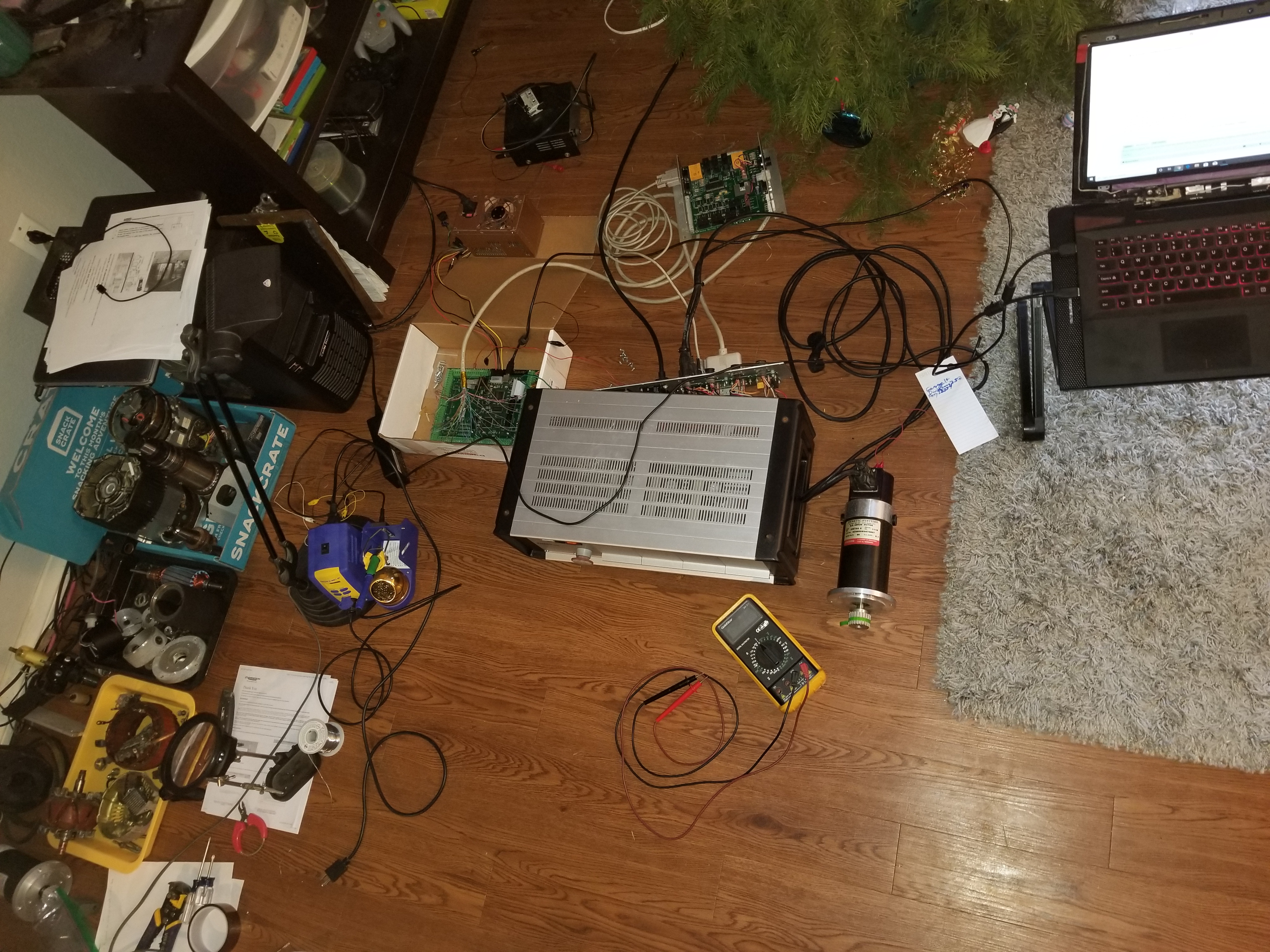

Hello Tom! It seems that you field all of the support for the Dynomotion product line. I guess this is the best forum section to start this particular string of questions and to start off my project utilizing your board. I came upon the kflop because I recently bought a techno Isel router table at auction which was missing the PCI "brain" board, and needed a motion control solution that could handle analog dc brushed motors. I have scratch built a 3d printer and another router table that worked under 2 different motion controllers but this is my first foray into servo motors and C+ based firmware. I have broken down the SCSI cable that acts as the wired connection between the box which houses the power supply and servo amps and the original PCI "controller" card, and connected it to what I think are the appropriate screw terminals on the kanalog board. I have tested the servo amps directly with 1.5V battery as analog input and gotten a motor to turn. Now I am at the point where I want to get a motor to turn via a jog button in the control software and I am playing with the Kmotion interface. I loaded Kmotion and configured the 0 axis and hit the save, compile, download, run button. My first couple questions arise from the following, I figured out that the opto in at J15 needs power so I took 5V+ from the kanalog and hooked it to 0+ and made the limit switch for the axis I am testing (the limits on this machine are 2 micro switches wired in series for home and limit per axis) brake ground on the 0- terminal. When I go to the digital I/O tab in Kmotion all of the home and limit state boxes randomly cycle on and off but the kanalog opto in bit 136 functions as I expect (depress a limit microswitch and state check mark goes away, release switch it comes back) I don't know if that is normal or not for state boxes on the kflop page to cycle. The cycling of state on the home and limit boxes freaks me out. I have crashed my other machines more than once because of limit switch issues. My other question is based on the encoder and dac side. When I first connected via laptop to the kanalog and started poking around Kmotion, I got a voltage reading on the DACs side of analog I/O when I manually turned the encoder but after loading a config onto the board and dorking with wiring to the limit switches now I don't see a change there. I do get a change in position on the axis page though. Am I ready to try a jog button for this axis in KmotionCNC or do I have a problem with the home and limit and or encoder? Thank you in advance for any help. Sincerely, Dave.

That all sounds normal. The home and limits marked are just possibilities for systems without Kanalog. Limits are configured in software and any IO bit can be used. See here. With Kanalog those bits are used to communicate with Kanalog and so will toggle at high speeds. Ignore this.When I go to the digital I/O tab in Kmotion all of the home and limit state boxes randomly cycle on and off but the kanalog opto in bit 136 functions as I expect (depress a limit microswitch and state check mark goes away, release switch it comes back) I don't know if that is normal or not for state boxes on the kflop page to cycle. The cycling of state on the home and limit boxes freaks me out.
If the axis is configured properly and enabled, then turning the encoder should create an position error and some DAC output should be present.My other question is based on the encoder and dac side. When I first connected via laptop to the kanalog and started poking around Kmotion, I got a voltage reading on the DACs side of analog I/O when I manually turned the encoder but after loading a config onto the board and dorking with wiring to the limit switches now I don't see a change there. I do get a change in position on the axis page though. Am I ready to try a jog button for this axis in KmotionCNC or do I have a problem with the home and limit and or encoder? T
