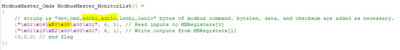

I have already show you where to but the address you want, with this picture.The highlighted area is the transmited address. In high byte you have to write 06 and in low the 02.

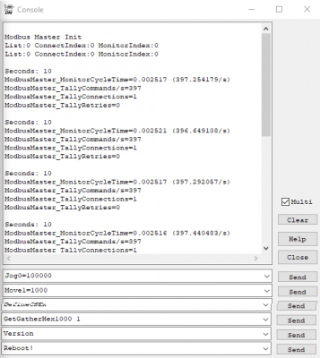

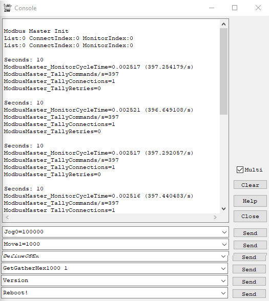

I got one rs485 to rs232 converter without flow control and i have done wiring according to the description mentions in kflop and leadshine manual and after running modbus master init v1, i am getting attached console response.
Please tell me how to send the 0x602c, this address. this register holds the current absolute positions of motor in leadshine.
I have modified some code in modbus master init v1 and attached same.

Posts: 2923
Re: How to use a servo with in built 23bit Absolute encoder with kflop
Post by TomKerekes » Wed Feb 17, 2021 4:04 pm
Hi Amit,
It now seems to be communicating without errors.
You told us it worked with the PC but never told us anything about what you did or what kind of data you received.
Right now your code:
	{"\x01\x04\x60\x2C\x00\x01", 6, 0},	// Read inputs to MBRegisters[0]
Reads one 16 bit register. To get 23 bits of data you will need to read more than one 16-bit register. So you probably need to change to read 2 registers:
	{"\x01\x04\x60\x2C\x00\x02", 6, 0},	// Read encoder data to MBRegisters[0] and MBRegister[1]
Then change the RegUnload function to put the data somewhere for you to view. Such as:
// marshal and move values read from PLC/Slave into MBRegisters to KFlop memory
void ModbusMaster_RegUnload()
    persist.UserData[150]= MBRegisters[0];  // put read encoder registers into global memory
    persist.UserData[151]= MBRegisters[1];
Then display the global registers in the Console to see if they make sense with:
GetPersistDec150;GetPersistDec151
