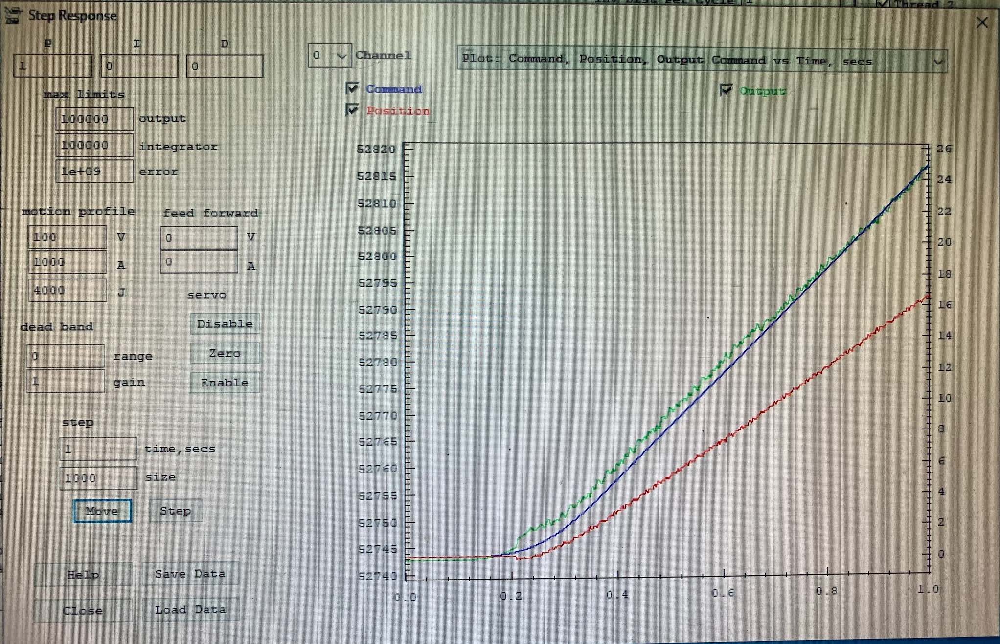

This is the situation I talked about: I press "move" with proper speed and acceleration values. The machine moves ok and this plot is shown.
Should the movement (red line from the encoder) be exactly coincident with the blue command line? If so, which parameters should I adjust?
They should match up better than that. The plot shows a significant scaling error of about:
3000/2800 = 1.07 -> 7% scaling error

When I force a stall with a speed set too high, I can observe the position fails to follow the command, the red line seems to reflect the failed movement:
PID values are 1,0 and 0, but results don't seem to change when I set non-zero values for Integral and derivative.
As stated in my previous post you must set the Output Mode to "CL Step" for there to be any closed loop corrections.
As stated before please start with I gain only.
Note that feedback is unlikely to help with motor stalls. In some cases it can help dampen resonances. But in general once the motor stalls the feedback will command the motor faster to try to catch up, but this will likely make matters worse as trying to go too fast is the problem in the first place.

I understand my encoders are working, but I am missing something, because the output green line is always flat.
Am I correct? should the green line (output) reflect the adjustment to be made to the movement?
You are probably not in CL Step mode as described above and in my previous post.

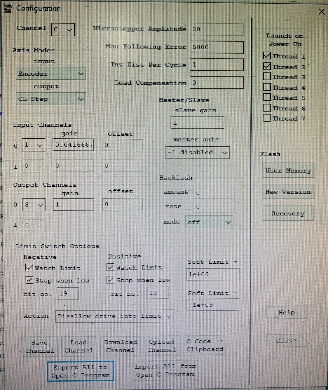

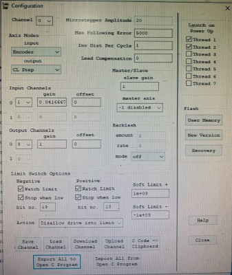

You were right (as usual). I changed back to CL STEP and now I can see command, position and output curves being plotted accordingly.
My settings:
I tried to set the encoder gain to 0.041666 because:
Stepper 200ppr, encoder 1600 pulses per rev. plus 3:1 ratio toothed belt, so 200/1600/3 = 0.041666

It seems your InputGain0 is wrong. The encoder seems to be counting about half what it should be. Hard to tell because your graph is only of the very beginning of the move.
Please test open loop Moves (P=I=D=0) until the encoder is working and configured correctly.

The encoder position looks somewhat noisy. How do you have the encoder interfaced to KFLOP? I found a spec on H38S400B and it says the outputs are open collector. So a pull up resistor would be needed to work reliably.
