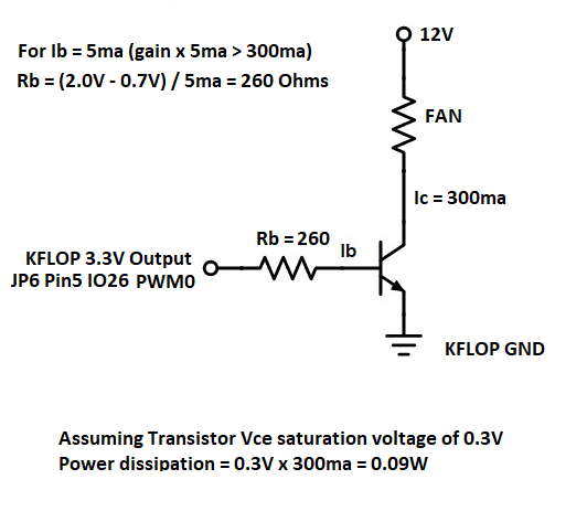

Here is a Resistor+Transistor circuit connected to a KFLOP 3.3V Digital Output to turn the Fan on and off. If the Transistor has a gain (hfe) of 100 then only 3ma of base current is needed to fully turn on the Fan of 300ma. To control Fan speed you will need to pulse the fan on and off at some frequency and vary the duty cycle (% of time on) this is called PWM (pulse Width Modulation). If you have JP6 pins available a KFLOP Hardware PWM can be used to make things easy. Otherwise you will need to write software to pulse the output on and off.
Note this circuit is not optically isolated like the Analog Output is. The 12V supply GND must be common GND with KFLOP +5V GND. This means any noise picked up in the fan wiring or 12V supply might possibly cause problems. If so you should add some opto isolation.

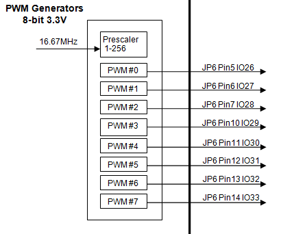

How to do that ?
As i have checked that i have 3 out of 10 I/O available for Fan control Kflop hardware PWM. I have JP6 - IO 27,28,29 available.

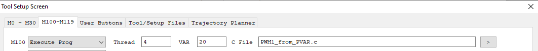

Here is code to control PWM #1 on IO27 based on persist variable 20
#define FVAR 20 // desired fan speed MCode P word is passed as float % in FVAR
#define PWMN 1 // use PWM #1 on JP6 Pin6 IO27
float speed = *(float *)&persist.UserData[FVAR]; // value stored is actually a float
// printf("Fans speed = %f\n",speed);
if (speed > 100.0f) speed = 100.0f; // limit from 0-100%
if (speed < 0.0f) speed = 0.0f;
SetBitDirection(26+PWMN,1); // define bit as an output
FPGA(IO_PWMS_PRESCALE) = 65; // divide clock by 65 (1 KHz)
FPGA(IO_PWMS+2*PWMN) = (int)(speed * (255.0f/100.0f)); // duty cycle
FPGA(IO_PWMS+2*PWMN+1) = 1; // Enable
KMotionCNC configured for M100 to execute above program in Thread #4 and pass P parameter in persist variable 20
- M100 executes PWM1.png (6.55 KiB) Viewed 4217 times
GCode to set fan to 50% duty cycle
M100 P50 (set Fan to 50%)
Note it isn't clear if your fan will have any problem or issue with being switched on and off to control the speed or what switching frequency would be best. You would need to ask the fan manufacturer or run experiments.
Also note the above code sets the PWM frequency to 1KHz (PRESCALE). All PWMs must run at the same frequency. It isn't clear whether you are using any other PWMs and at what frequency.

I was talking about Rb. How to calculate it and in my case which one should i use. ?
Waiting for your kind reply.
Thank You
AMIT KUMAR
- Posts: 2892
Post
by TomKerekes » Fri Nov 22, 2019 9:45 pm
Hi Amit,
See the calculation in previous posted diagram for Rb.
It depends on the current gain of your transistor (hfe). If the transistor gain is > 80 then 270 Ohms should work.
