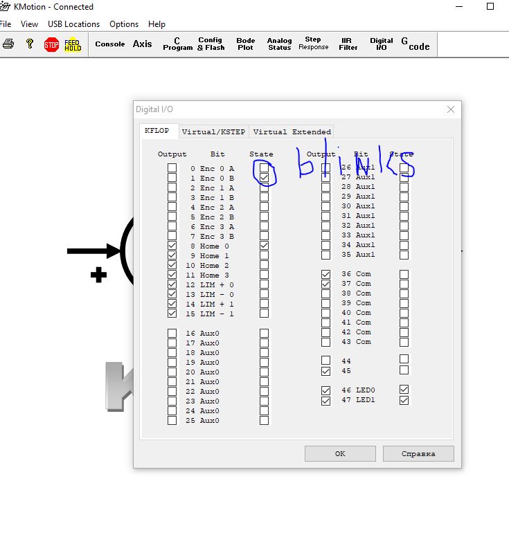

The Encoder stops working because you are somehow setting Bits 0 and 1 to be Outputs not Inputs. All IO used as encoder inputs must be configured as inputs not outputs. Probably your HOME Program is doing this.

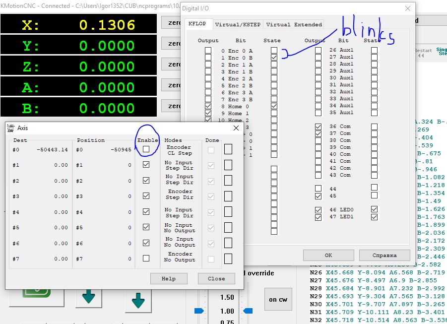

Step 1 - I have a servo stepper motor leadshaine HBC 2206/the driver has a microstep 19200 (64). In the program kflop 97500 pulses... The 290 mm test is good. Has a ruler accuracy of 0.001mm. Motor is connected to 15-16 pin. Digital line is connected to 7-8 pin.
Step 2 - I start Kmotion, I see the state of AB pins flash alternately. this correct state?

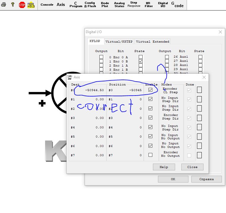

Opening the tab (AXIS), seeing the state -50944.50/-50945 is the correct state?
Step 3 - I run the KmotoinCNC program. I see the position of the Х-12,7492 axis. Zero X coordinate by pressing "ZERO" button (set)
Step 4 as you move the axis in any direction, the X axis becomes inactive (yellow) here is the final screenshot
I don 't understand what I 'm doing wrong. According to my motor parameters, you can specify which parameters to test?

Yes if the Encoder is moving any amount.Step 2 - I start Kmotion, I see the state of AB pins flash alternately. this correct state?
You have not configured anything yet.Opening the tab (AXIS), seeing the state -50944.50/-50945 is the correct state?
Do not run KMotionCNCStep 3 - I run the KmotoinCNC program.

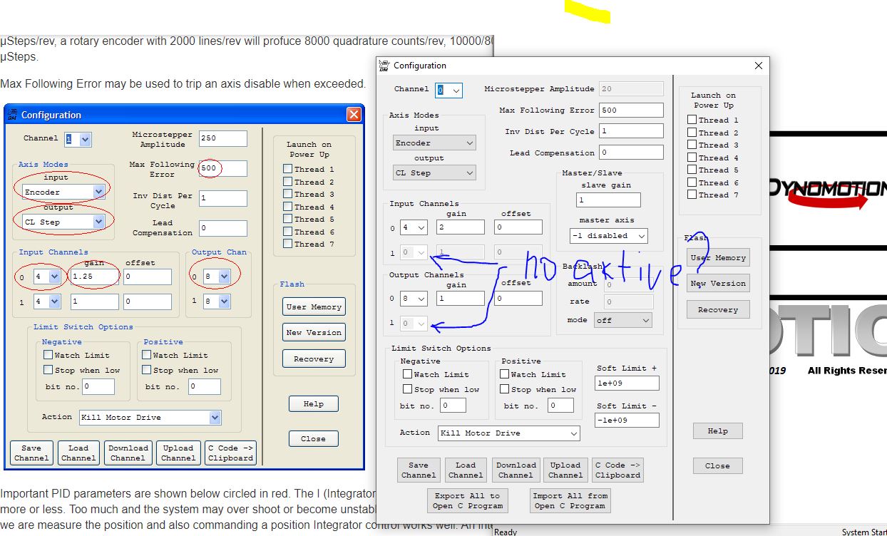

Regarding "No active" - that is correct. The mode only has one Input and one Output
Regarding "blinks" - correct whenever the encoder moves
Regarding "Enable off" - Your Input and Output channels are wrong. So you get a following error.
Change Input Channel to 0
Change Output Channel to 0
Change Max Following Error to 1000000000
Push "Zero" on the Step Response Screen
Push "Move" on the Step Response Screen
Post the Plot
Post all your Screens.

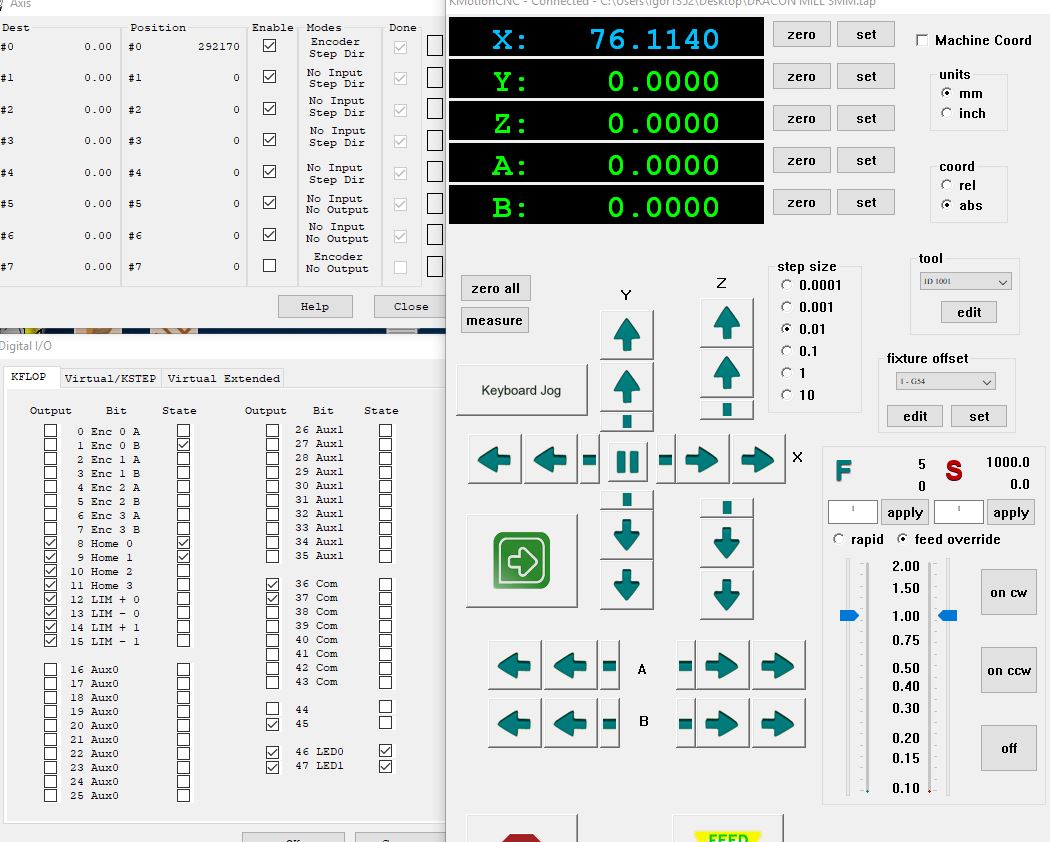

Good afternoon Tom. I have a problem, and I don 't understand how to solve it. Digital line of long 293 mm (operating stroke) shows the value of 292176 pulses = 293mm (11.5354.. Inch) is not displayed correctly in the program. Output of 76.1156 mm when the expired value is 293mm! How to solve this problem. thanks
Question - in the holding mode data from the digital line are not taken into account?

It seems we are miss-communicating. Do you have a friend that speaks English? Please follow my instructions in my last email. Please do not run KMotionCNC.
We also need the specifications on the encoder resolution and your mechanics (Step resolution) to set the InputGain to match the encoder counts to the motor steps. Then verify it is correct with KMotionCNC Step Response Screen.
