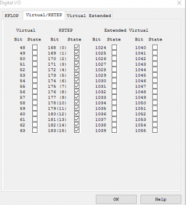

3. Checked the status of the digital Inputs using the Digital I/O screen and found that all inputs in KSTEP are shown as active
(ie check box marked)

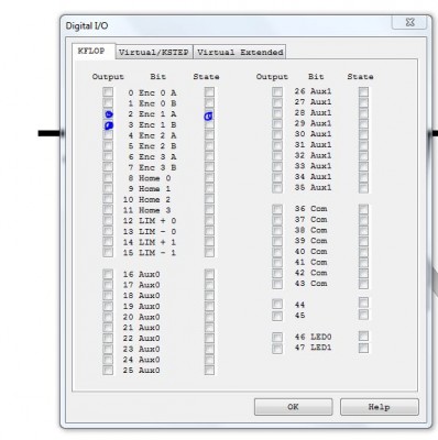

The KStep Inputs are multiplexed into KFLOP 4 bits at a time using KFLOP IO Bits 2-7. Bits 2 and 3 are KFLOP Outputs and toggle to select each bank of 4 bits. Bits 4-7 are KFLOP Inputs and should always be high (with no connections to KStep JP33). Please look at the KFLOP Digital IO Screen bits 2-7 to see what is happening. Bits 2 and 3 should be Toggling Outputs and 4-7 High Inputs. This is all configured automatically when KStepPresent=TRUE; is set.

(2) Run our test C code (refer attachment) and then checked the status of Digital Inputs and found all the inputs to be active
==> without even we grounded any of the inputs
Note: No change in input state is observed when we grounded pin 9 of KStep
Attached files for reference
- Screenshot of KStepDigital Inputs, when we enable KStep
- Screenshot of KFLOP IO Bits, when we enable KStep

Apologies , not sure why that attachment is missing, will attach tomorrow from my test bench. We noticed that the KFLOP bits 2-3 status were toggling in Digital I/O screen and output status were enabled. Please refer this attachment colored by me to show the happenings.
