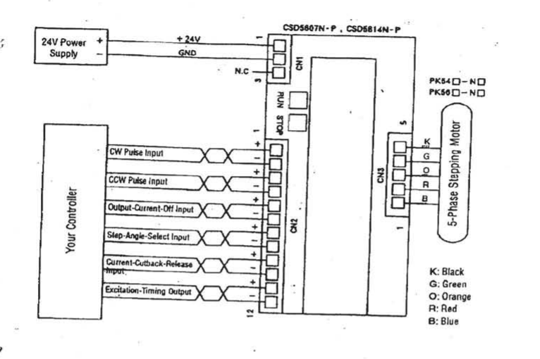

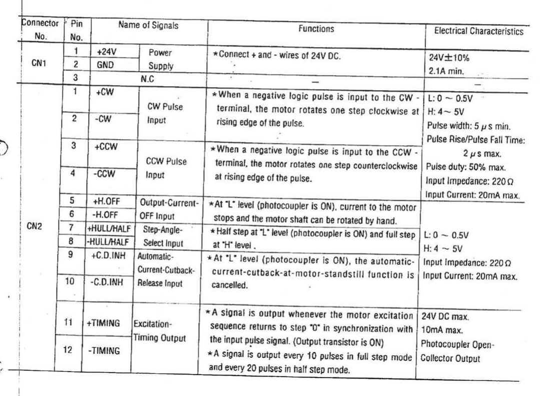

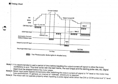

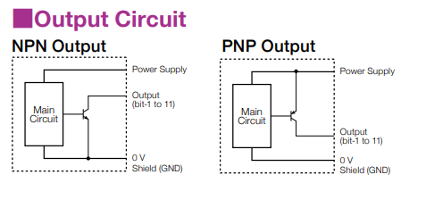

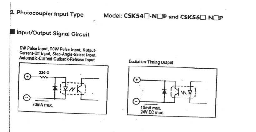

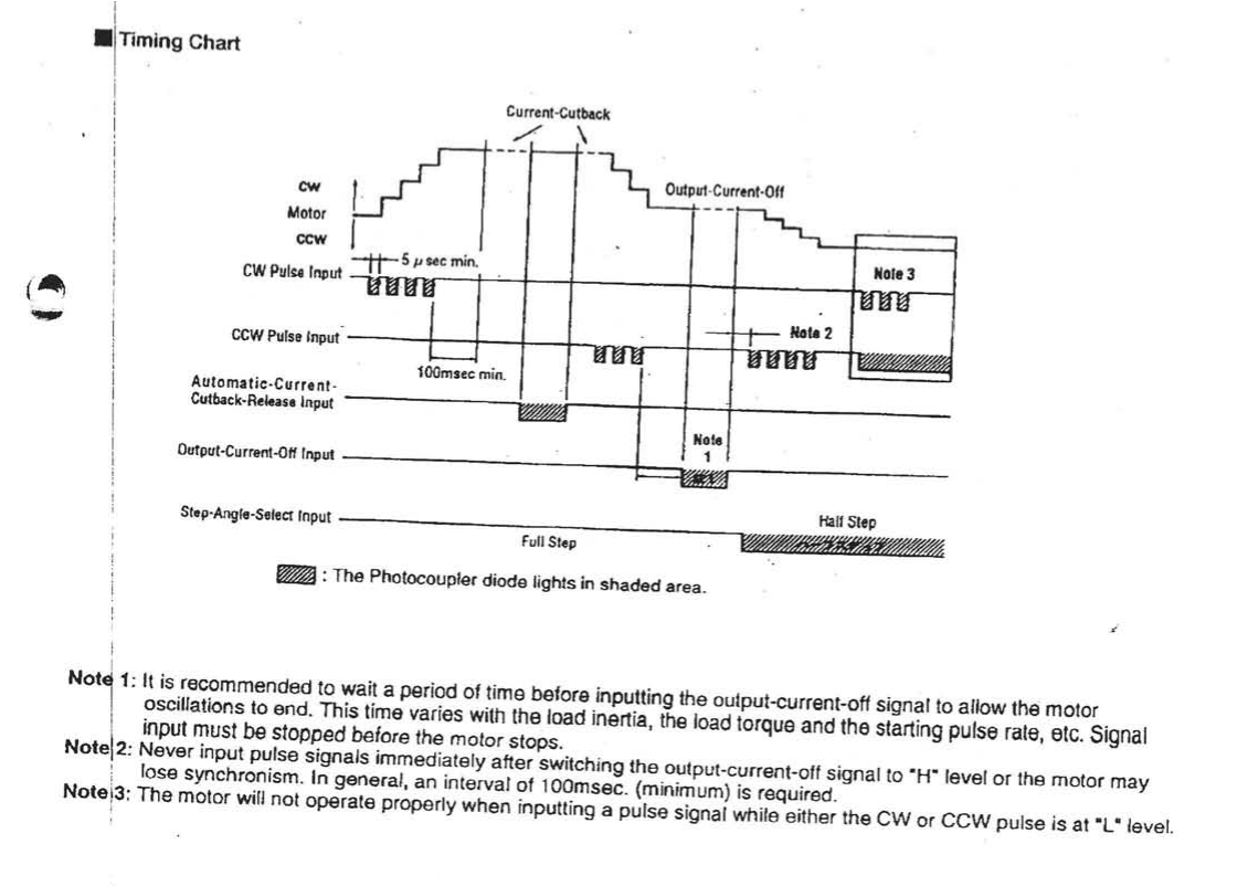

I attached some images. The encoder is a KOYO TRD-3A1024-2610. So it has 1024 positions per 360°.
I have no manual,I assume the outputs are Open Collector type.
The driver is from Vexta (CSD5807N-P)

Last question: The drivers have differential inputs. What card combination do I need to have differential outputs on KFLOP?
Thanks for your help.

But unfortunately the Drives Specify CW/CCW pulses of 5us minimum. KFLOP's pulses are a maximum of 3.78us. So they are incompatible and probably won't work reliably. The only way to make them compatible would be to add an external pulse stretching circuit.

KFLOP (or any of our option boards) do not have differential outputs. The drive's inputs are basically an LED so you probably don't need differential drivers. KFLOP's 5V open collector mode would drive them.The drivers have differential inputs. What card combination do I need to have differential outputs on KFLOP?
You might read this.
