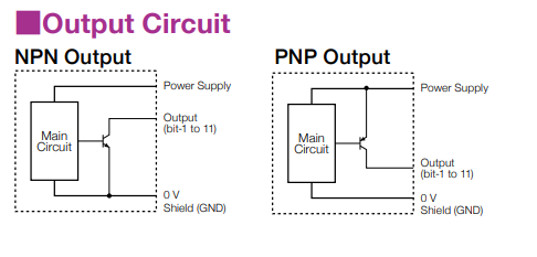

I attached some images. The encoder is a KOYO TRD-3A1024-2610. So it has 1024 positions per 360°.
I have no manual,I assume the outputs are Open Collector type.
The driver is from Vexta (CSD5807N-P)

The encoders have only 24V VCC and 10Bit outputs (total 12 wires, each axis)
