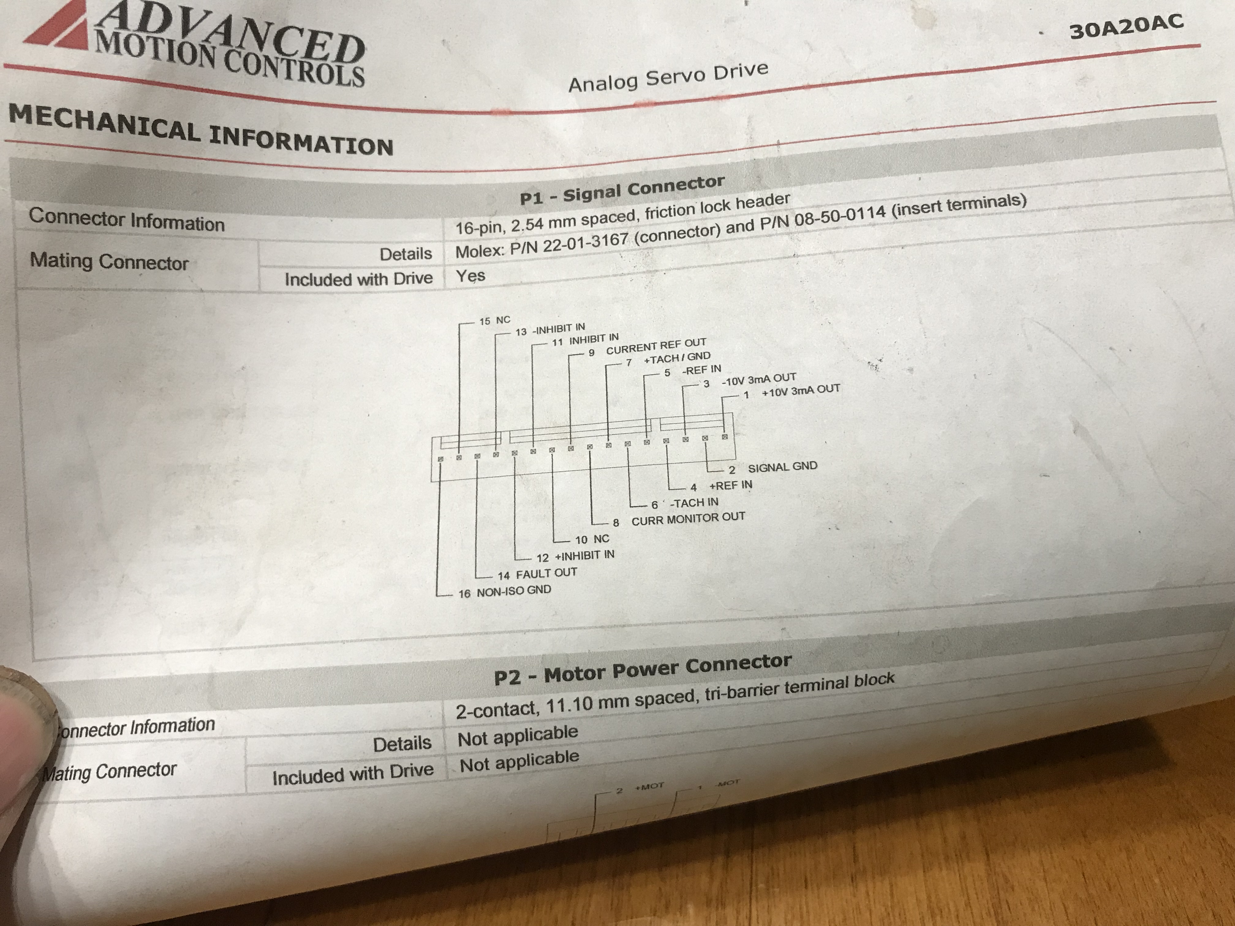

Looking for 16 pin , 2.54 spaced single row to match my Advanced Motion servo drive
I hate small wires. Connector header # Moldex 22-01-3167
Will need 4 assemblies about 18 in long with one end without a connector to go to the KFLOP

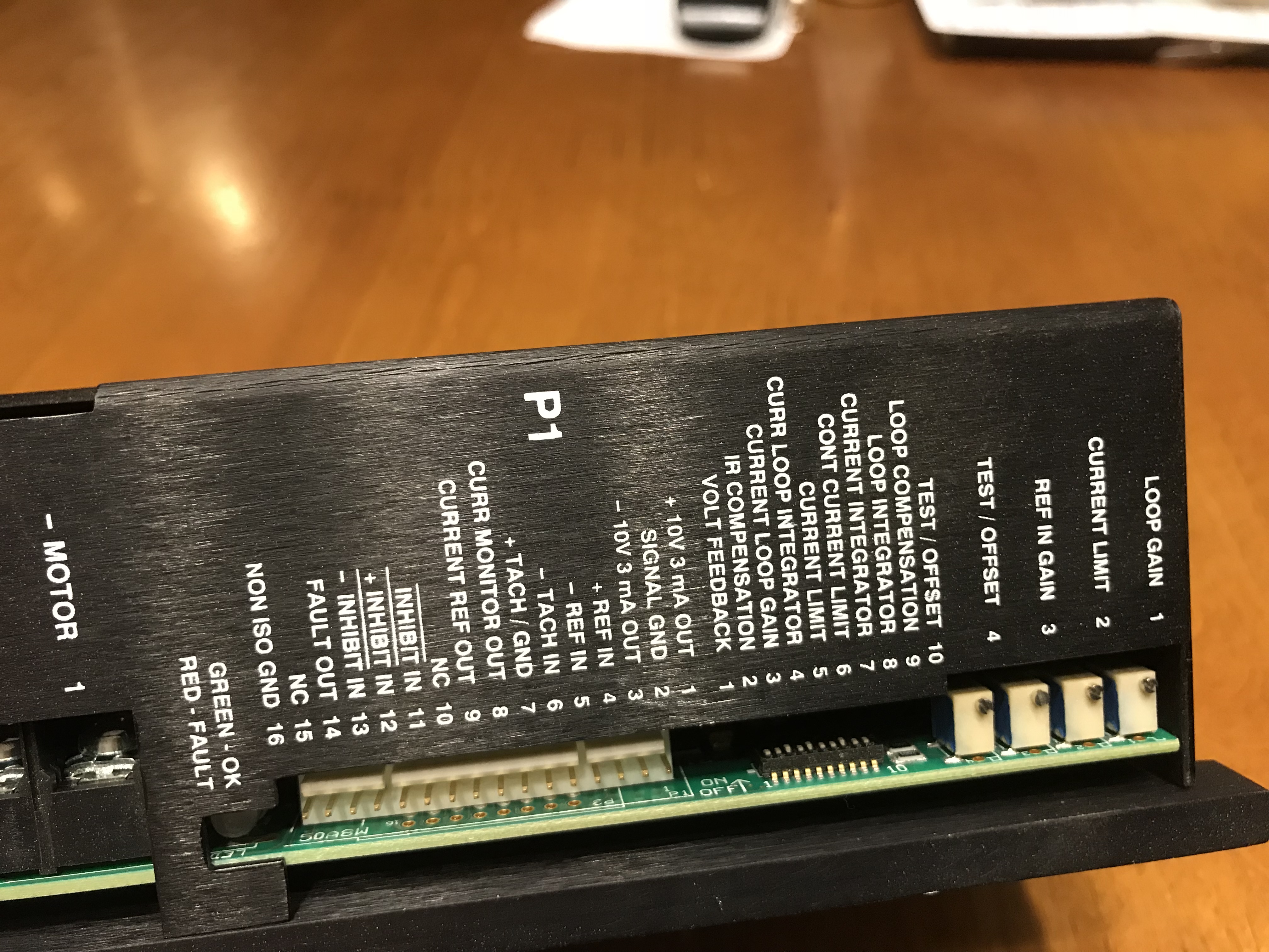

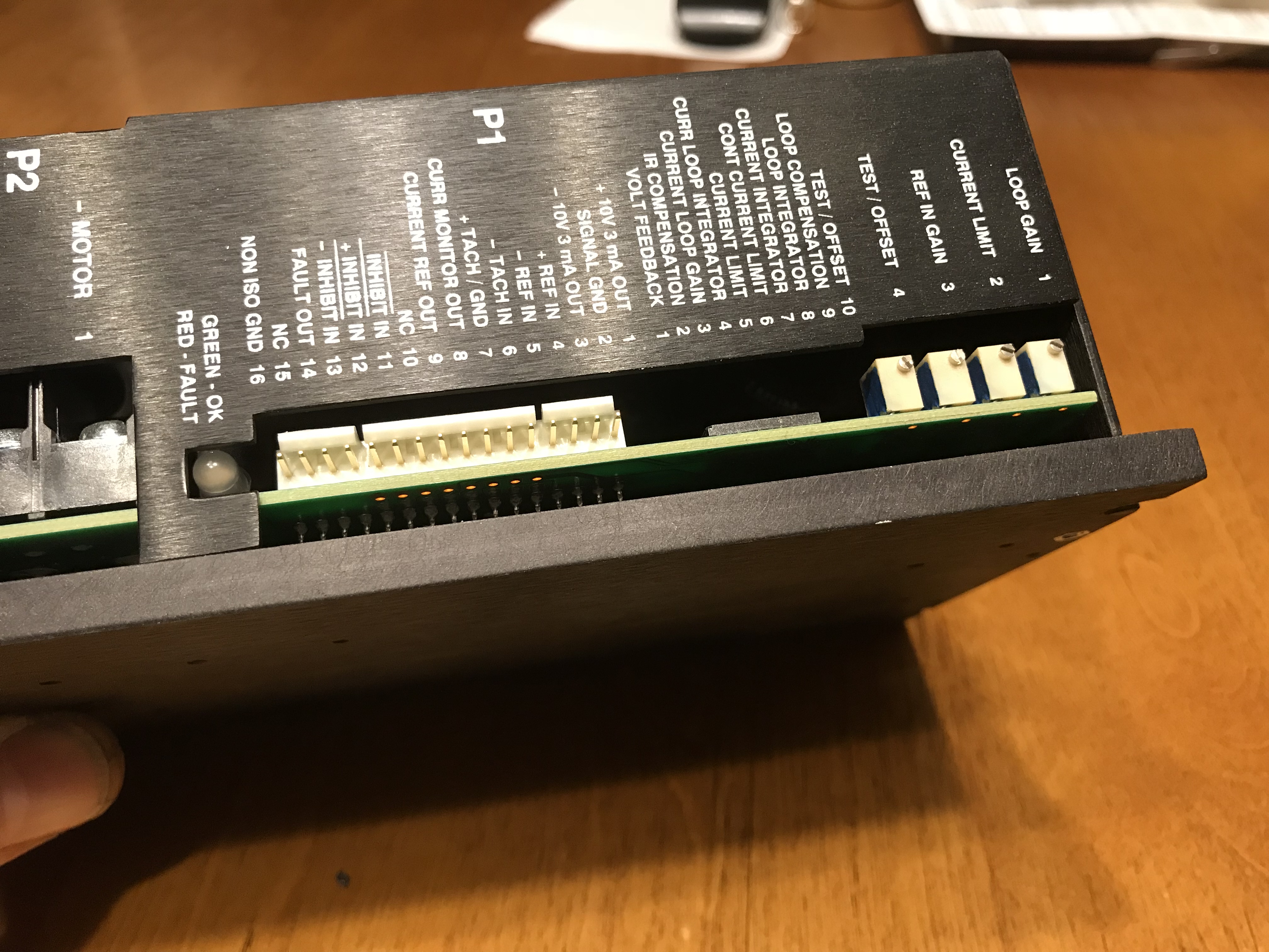

Hi Tom
Advanced servo drive has a 16 pin 2.54 space single row male pins in the unit I have to get all my signals from there to the correct screw terminals on my KFLOP BREAKOUT BOARD
I can find the correct ribbon wire and the correct Molex connector and female PCs to tin nd crimp and make but I want to buy a pre made 16 pin single row 2.54 etc
I also don’t understand why Advanced would use a connector like this I’ve been putting this stuff off because of this

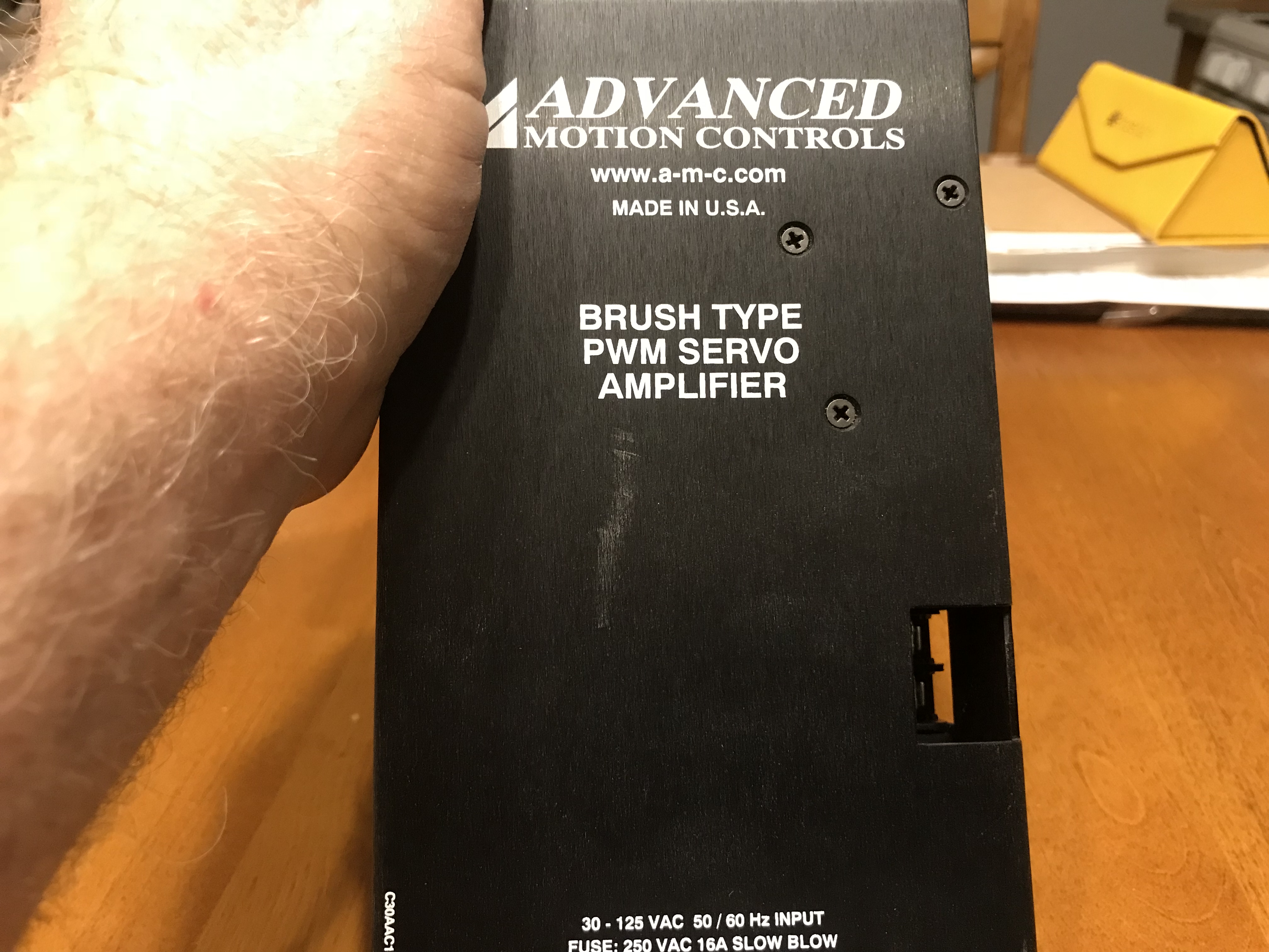

How can I attach a pic of my control?

Re: Pre made wire assemblies
Oops missed it being single row.
That is an Advanced Motion Control.
http://a-m-c.com You might ask them.
Otherwise you will probably need to make a cable. It shouldn't be that hard. I found these tools:
https://www.moddiy.com/products/Profess ... cQQAvD_BwE
https://www.mouser.com/ProductDetail/Mo ... xtr5pY5jFX
