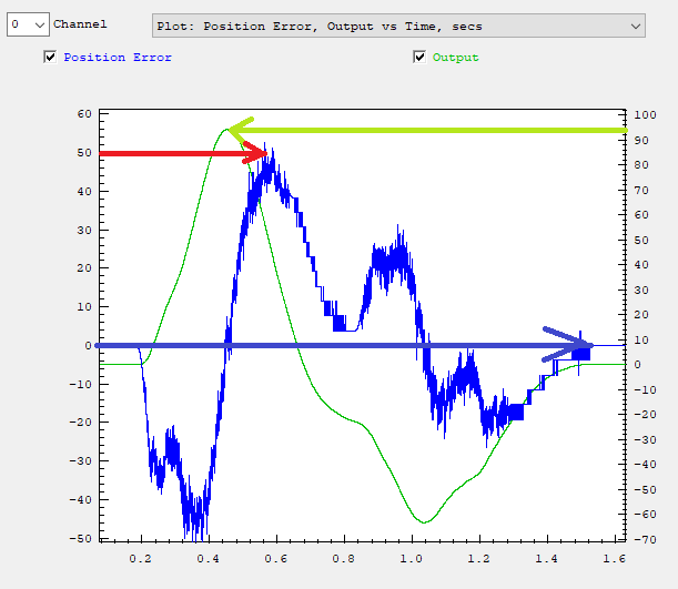

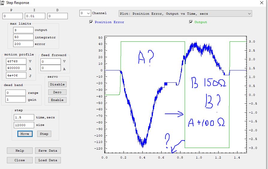

Below is a plot of the error while moving.
Note the maximum error is 50 x 3.84 = 192um (red)
Corrections of 90 x 3.84 = 345um are being made (green)
Final Error is zero (blue)
Do you understand this? Please describe what you understand.

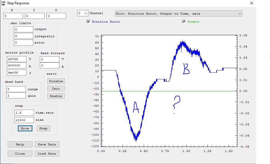

Now set P = I = D = 0 and plot the error with out any correction from the scales.

Yes test.txt is the Step Response Data we have been asking for.

Good afternoon Tom, I don 't quite understand the idea you 're trying to convey to me. But that the blue line should be at zero?
Too large between 192 and 345. Should these values ideally be the same?

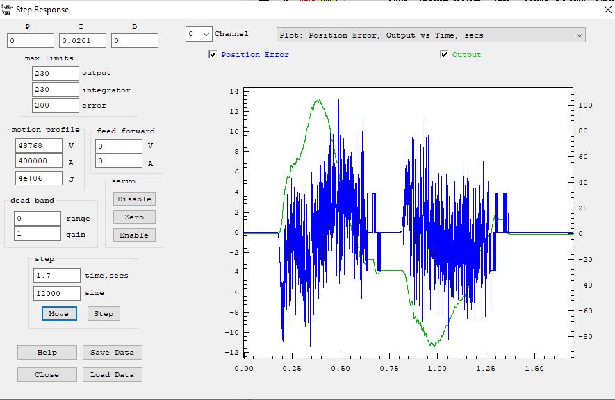

Hi Igor,
Note 0.0201 is essentially the same as 0.02. So it is sort of silly to use 0.0201.
The Output (green) is the amount being corrected. That should be whatever is necessary to correct the mechanics (leadscrew, backlash, stepper error, etc...)

You ignored my request to set P=I=D=0. The idea is to see the errors of your mechanics with no corrections of the linear scales. Only use the scales for measurements of the open loop system.
It is at zero. The blue line/arrow shows at the end of the move the error is zero. Which is good. Or did you mean the blue plot not the blue line? Please use more words in your responses to be more clear.But that the blue line should be at zero?
No. The 192um error should be reduced as much as possible. Your new plot with I=0.0201 has the error reduced to 12 steps * 3.84um/step = 46umToo large between 192 and 345. Should these values ideally be the same?

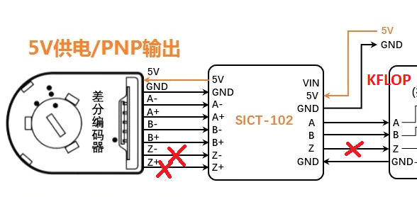

You can judge which type of converter I choose.
1 - https://aliexpress.ru/item/32436865218. ... b201603_53
2- https://aliexpress.ru/item/32995400915. ... EHdPn&mp=1

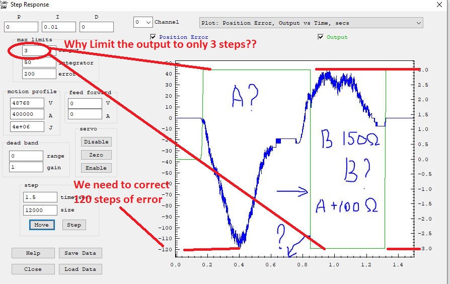

Ok. The first plot is the open loop errors. +/-10 steps when stopped +/- 110 steps when moving.
I don't know why you set max limit output to only 3 steps. We need to correct ~120 steps of error.
Why do you refer to resistors? What is A and B?
#2 should work as a differential receiver. You probably don't need the Z index pulse.

Yes I use an interpreter, English is not my native language. And B channels of encoder output. I put up an exhibition. To see what happens. And I see a phase skew. And I want to know how to fix it. I will try to order a converter from your link. They only have RJ45 on sale?
