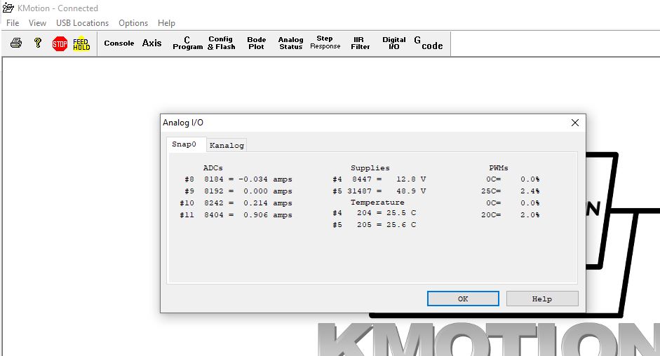

SnapAmp has lots of diagnostic capability to tell you what is going on. The KMotion.exe Analog Screen shows the Supply Voltages and Current measurements for both coils of both stepper motors. Please tell us what the 6 values are before turning on VS2 and afterward.

When I connect the power supply to the VS2 input, the Analog I/O reads the proper input voltage of the power supply within .5% with a slight bobble. For instance when I have the 48volt supply hooked up both voltages read 48.1 to 48.3 volts. When I hook the 12 volt supply to either VS1 or VS2, the Analog I/O reads and displays the proper voltage.

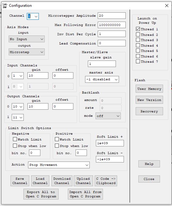

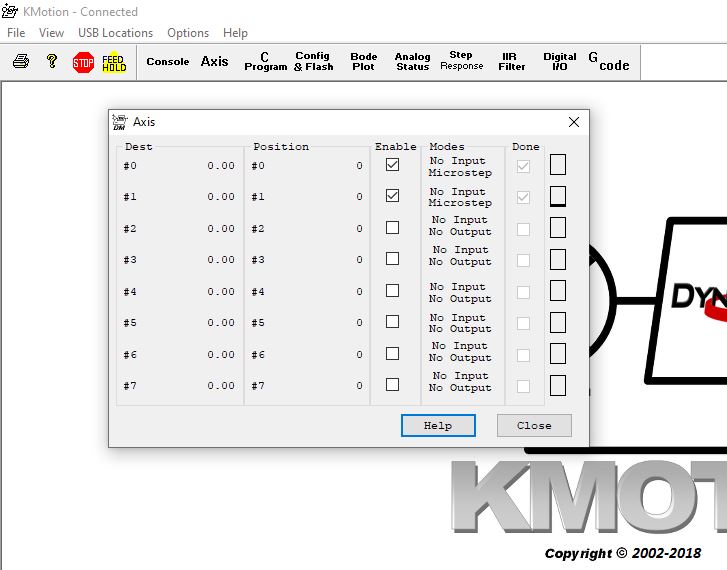

- Posts: 2676
Re: Snap Amp with Stepper Motors
Hi Paul,
I don't see anything specifically that would explain Axis 0 not working.

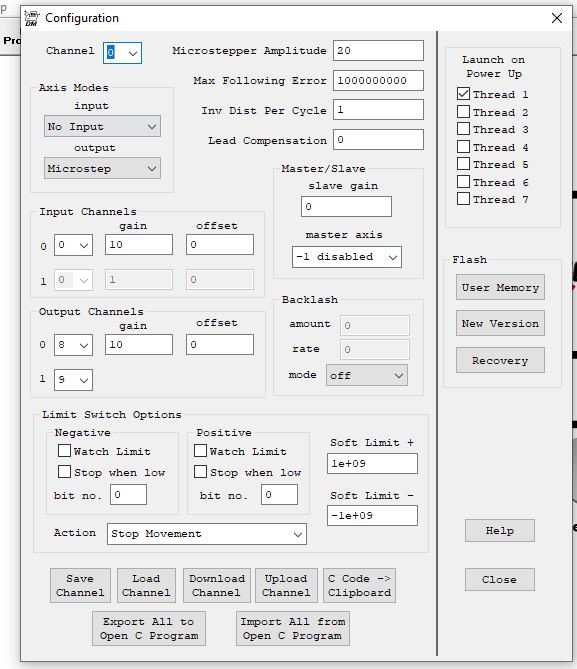

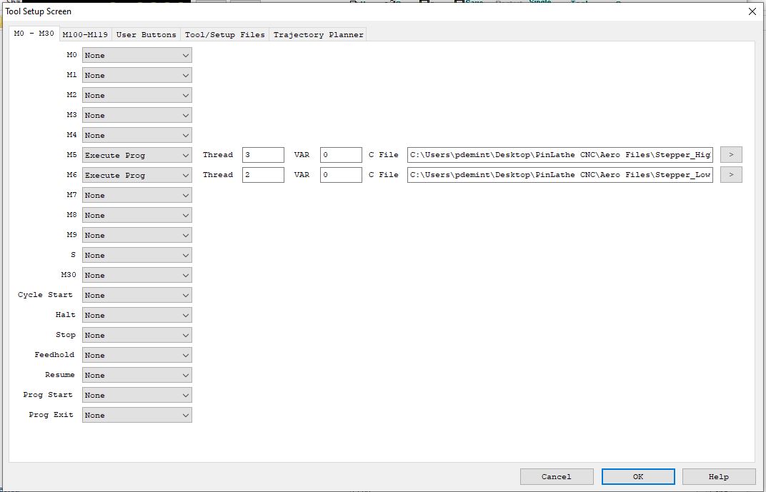

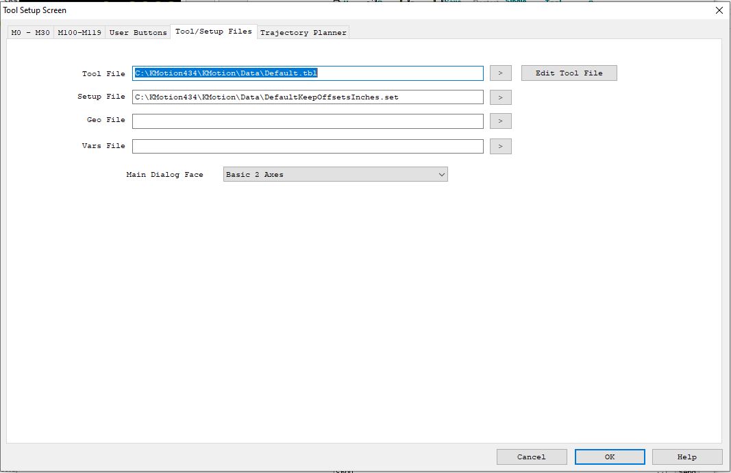

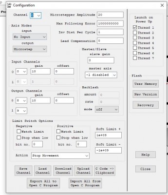

The Screen shots don't really help if you don't explain under what conditions they were taken and what you did beforehand.
I would like to do the minimal steps that should work but don't and demonstrate the problem to simplify things.

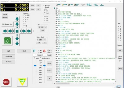

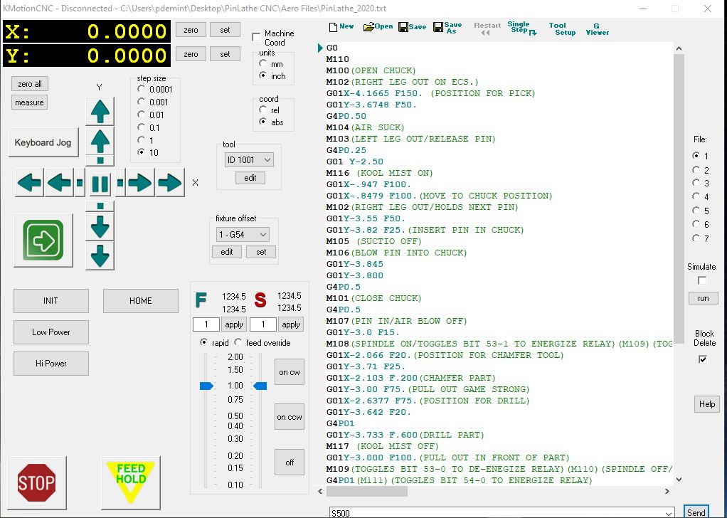

Please don't run or include information on KMotionCNC until after you have your motors working in KMotion.exe its just a distraction.
We don't recommend Flashing anything into KFLOP. If you do then it is hard to know what state KFLOP is actually in. it seems you have Flashed KFLOP with something as Launch Thread #1 on Startup is set. Please reset KFLOP to its default state by Flashing New Version and do not Flash any programs or configuration into KFLOP.
I see the Initialization program has a few things that don't match the Configuration Screens:
-Output Gains are set to 10 instead of 1.
-Axis 0 is slaved to Axis 1.
-Axis 1 is slaved to itself (Axis 1).
-Various Stepper Amplitudes
-Various SlaveGains
