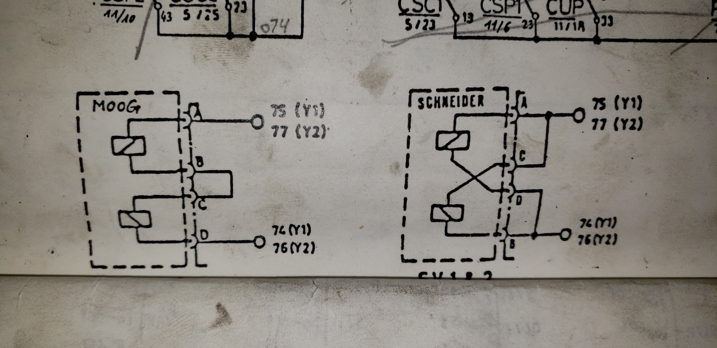

The solenoid coils have from 17 to 25 ohms of resistance if I remember correctly. I will have to learn about the PWMR mode also. I have enclosed a picture of the coil schematic - I have the Schneider servo valve on the right. It somewhat shows the relationship of the coils and how they are opposed electrically with only 2 leads going to the control. https://www.dynomotion.com/forum/downlo ... iew&id=562

Perhaps what I'm trying to do isn't how it's supposed to be done according to your message. What I'm envisioning is the +/-10v DAC servo control output from Kanalog being sent to the SnapAmp which subsequently takes that signal and converts it to a PWM output that is sent through the OUT0/OUT1 on the SA PWM channel 8 (for one of the servo valves, channel 9,10,11 for other axes) to the valve solenoid. The signal would be varying constantly as needed to maintain or achieve whatever position is desired by the control based on the linear encoder input.
