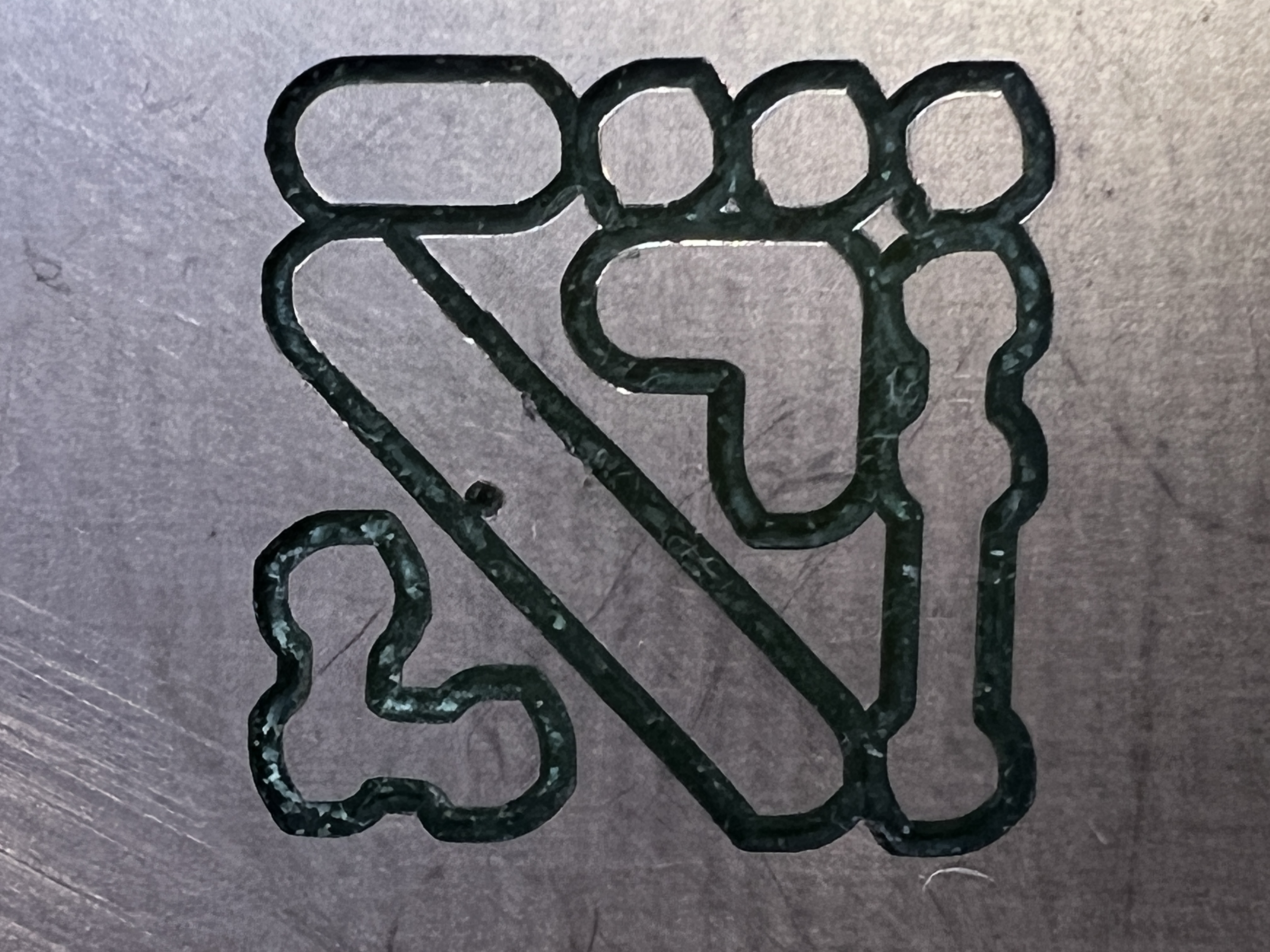

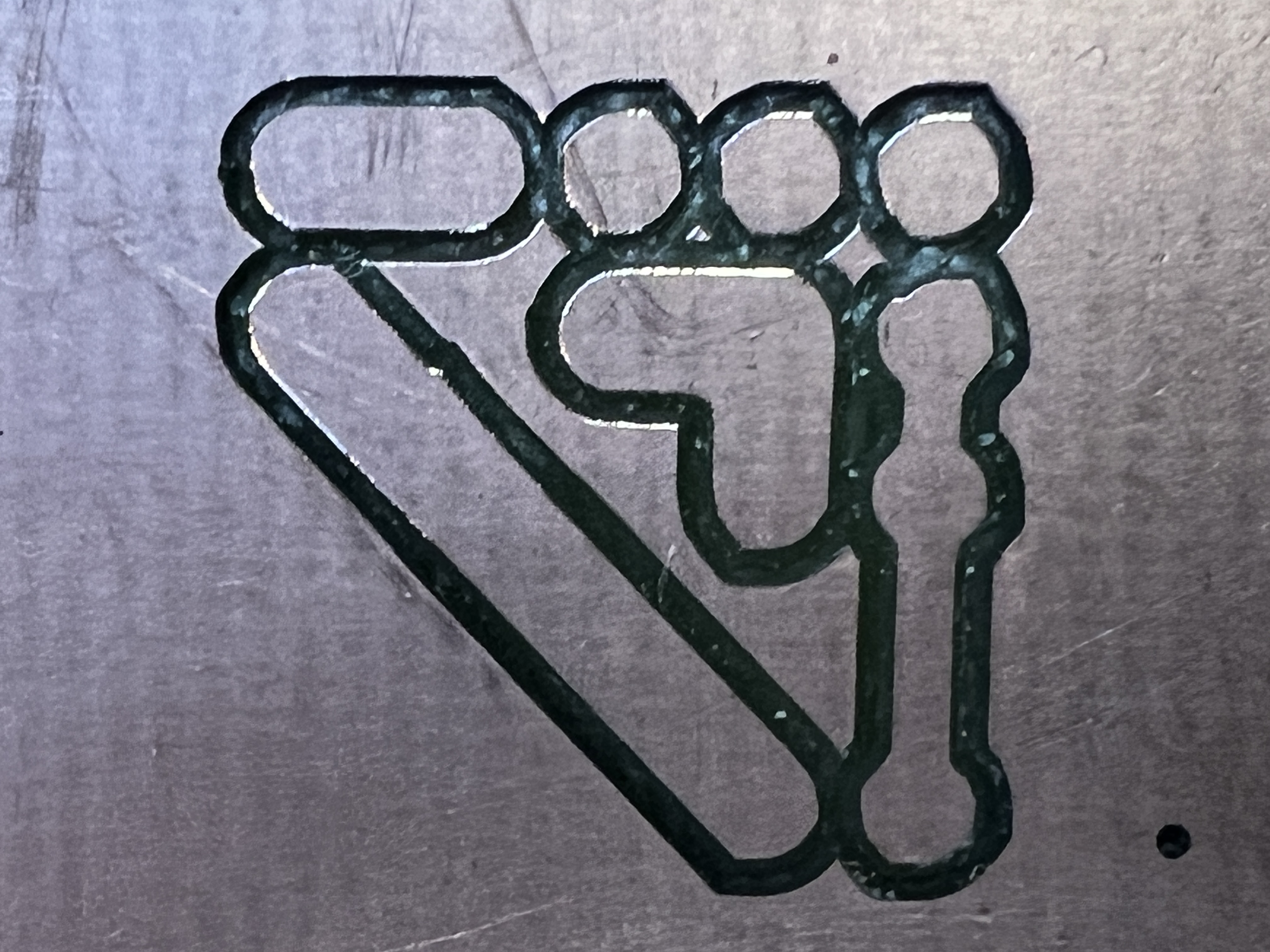

I’ve been using my SuperMax knee mill with KFLOP and closed-loop steppers to CNC mill printed circuit boards. I’m running the spindle at 2500 RPM with carbide end mills and drills. At a feed rate of 1 inch per minute, the results are very acceptable (photo attached).
However, as I increase the feed rate, the circular pads become increasingly irregular — I’ve attached photos at 5 IPM and 20 IPM for comparison.
I’ve tried a variety of adjustments but haven’t found anything that allows for higher feed rates without compromising quality.
While I’m fine working at 1 IPM since I don’t plan to produce a large number of PCBs, it would be nice to improve the feed rate if possible.
I suspect this may be a limitation of my hardware, but I’m also curious if there might be something in the configuration or software contributing to the issue.
I’d appreciate any thoughts or suggestions.

This is my initialization program:
[code]#include "KMotionDef.h"
// Defines KFLOP channels 0-4 as axes X-C
// Disables and Zeros all axes
// Defines axis parameters
// Enables all axes and sets positions to Zero
// Sets them as an XYZAC coordinate system for GCode
// Watchenable loop turns servos ON/OFF when axes are ENABLED/DISABLED
// or when Control Program (i.e. Mach3) is loaded/ended
// Each axis is disabled when a limit switch is tripped
// To reactivate, manually move axis away from switch then reload Control Program
void ServiceWatchdogStatus(void);
void WatchdogTripped(void);
void WatchdogOK(void);
void WatchLimits(void);
#define X 0
#define Y 1
#define Z 2 // Quill
#define C 3 // Knee
#define A 4 // Rotary
#define WATCHDOG_DELAY 2.0 // Script to disable drives if/when Control Program is closed
int ControlProgramActive = 1;
int XLimit;
int YLimit;
int ZLimit;
int CLimit;
int main()
DisableAxis(X);
Zero(X);
DisableAxis(Y);
Zero(Y);
DisableAxis(Z);
Zero(Z);
DisableAxis(C);
Zero(C);
DisableAxis(A);
Zero(A);
FPGA(STEP_PULSE_LENGTH_ADD)=32 + 0x40 + 0x80;
ch0->InputMode=ENCODER_MODE;
ch0->OutputMode=CL_STEP_DIR_MODE;
ch0->Vel=200000;
ch0->Accel=1e+06;
ch0->Jerk=1e+07;
ch0->P=0;
ch0->I=0.001;
ch0->D=0;
ch0->FFAccel=0;
ch0->FFVel=0;
ch0->MaxI=1e+06;
ch0->MaxErr=1e+09;
ch0->MaxOutput=1e+06;
ch0->DeadBandGain=1;
ch0->DeadBandRange=0;
ch0->InputChan0=0;
ch0->InputChan1=0;
ch0->OutputChan0=56;
ch0->OutputChan1=0;
ch0->MasterAxis=-1;
ch0->LimitSwitchOptions=0x120;
ch0->LimitSwitchNegBit=136;
ch0->LimitSwitchPosBit=136;
ch0->SoftLimitPos=1e+09;
ch0->SoftLimitNeg=-1e+09;
ch0->InputGain0=-46;
ch0->InputGain1=1;
ch0->InputOffset0=0;
ch0->InputOffset1=0;
ch0->OutputGain=-1;
ch0->OutputOffset=0;
ch0->SlaveGain=1;
ch0->BacklashAmount=0;
ch0->BacklashRate=0;
ch0->invDistPerCycle=1;
ch0->Lead=0;
ch0->MaxFollowingError=5000;
ch0->StepperAmplitude=20;
ch0->iir[0].B0=1;
ch0->iir[0].B1=0;
ch0->iir[0].B2=0;
ch0->iir[0].A1=0;
ch0->iir[0].A2=0;
ch0->iir[1].B0=1;
ch0->iir[1].B1=0;
ch0->iir[1].B2=0;
ch0->iir[1].A1=0;
ch0->iir[1].A2=0;
ch0->iir[2].B0=0.00075647;
ch0->iir[2].B1=0.00151294;
ch0->iir[2].B2=0.00075647;
ch0->iir[2].A1=1.88998;
ch0->iir[2].A2=-0.89301;
ch1->InputMode=ENCODER_MODE;
ch1->OutputMode=CL_STEP_DIR_MODE;
ch1->Vel=200000;
ch1->Accel=1e+06;
ch1->Jerk=1e+07;
ch1->P=0;
ch1->I=0.001;
ch1->D=0;
ch1->FFAccel=0;
ch1->FFVel=0;
ch1->MaxI=1e+06;
ch1->MaxErr=1e+09;
ch1->MaxOutput=1e+06;
ch1->DeadBandGain=1;
ch1->DeadBandRange=0;
ch1->InputChan0=1;
ch1->InputChan1=0;
ch1->OutputChan0=57;
ch1->OutputChan1=0;
ch1->MasterAxis=-1;
ch1->LimitSwitchOptions=0x120;
ch1->LimitSwitchNegBit=137;
ch1->LimitSwitchPosBit=137;
ch1->SoftLimitPos=1e+09;
ch1->SoftLimitNeg=-1e+09;
ch1->InputGain0=46;
ch1->InputGain1=1;
ch1->InputOffset0=0;
ch1->InputOffset1=0;
ch1->OutputGain=-1;
ch1->OutputOffset=0;
ch1->SlaveGain=1;
ch1->BacklashAmount=0;
ch1->BacklashRate=0;
ch1->invDistPerCycle=1;
ch1->Lead=0;
ch1->MaxFollowingError=2500;
ch1->StepperAmplitude=20;
ch1->iir[0].B0=1;
ch1->iir[0].B1=0;
ch1->iir[0].B2=0;
ch1->iir[0].A1=0;
ch1->iir[0].A2=0;
ch1->iir[1].B0=1;
ch1->iir[1].B1=0;
ch1->iir[1].B2=0;
ch1->iir[1].A1=0;
ch1->iir[1].A2=0;
ch1->iir[2].B0=0.779671;
ch1->iir[2].B1=-1.55685;
ch1->iir[2].B2=0.779671;
ch1->iir[2].A1=1.55685;
ch1->iir[2].A2=-0.559341;
ch2->InputMode=ENCODER_MODE;
ch2->OutputMode=CL_STEP_DIR_MODE;
ch2->Vel=200000;
ch2->Accel=1e+06;
ch2->Jerk=1e+07;
ch2->P=0;
ch2->I=0.001;
ch2->D=0;
ch2->FFAccel=0;
ch2->FFVel=0;
ch2->MaxI=1e+06;
ch2->MaxErr=1e+09;
ch2->MaxOutput=1e+06;
ch2->DeadBandGain=1;
ch2->DeadBandRange=0;
ch2->InputChan0=2;
ch2->InputChan1=0;
ch2->OutputChan0=58;
ch2->OutputChan1=0;
ch2->MasterAxis=-1;
ch2->LimitSwitchOptions=0x120;
ch2->LimitSwitchNegBit=138;
ch2->LimitSwitchPosBit=138;
ch2->SoftLimitPos=1e+09;
ch2->SoftLimitNeg=-1e+09;
ch2->InputGain0=-35.45;
ch2->InputGain1=1;
ch2->InputOffset0=0;
ch2->InputOffset1=0;
ch2->OutputGain=-1;
ch2->OutputOffset=0;
ch2->SlaveGain=1;
ch2->BacklashAmount=0;
ch2->BacklashRate=0;
ch2->invDistPerCycle=1;
ch2->Lead=0;
ch2->MaxFollowingError=2500;
ch2->StepperAmplitude=20;
ch2->iir[0].B0=1;
ch2->iir[0].B1=0;
ch2->iir[0].B2=0;
ch2->iir[0].A1=0;
ch2->iir[0].A2=0;
ch2->iir[1].B0=1;
ch2->iir[1].B1=0;
ch2->iir[1].B2=0;
ch2->iir[1].A1=0;
ch2->iir[1].A2=0;
ch2->iir[2].B0=0.000768809;
ch2->iir[2].B1=0.00153762;
ch2->iir[2].B2=0.000768809;
ch2->iir[2].A1=1.92081;
ch2->iir[2].A2=-0.923885;
ch3->InputMode=ENCODER_MODE;
ch3->OutputMode=CL_STEP_DIR_MODE;
ch3->Vel=100000;
ch3->Accel=75000;
ch3->Jerk=1e+06;
ch3->P=0;
ch3->I=0.001;
ch3->D=0;
ch3->FFAccel=0;
ch3->FFVel=0;
ch3->MaxI=1e+06;
ch3->MaxErr=1e+09;
ch3->MaxOutput=1e+06;
ch3->DeadBandGain=1;
ch3->DeadBandRange=0;
ch3->InputChan0=3;
ch3->InputChan1=0;
ch3->OutputChan0=59;
ch3->OutputChan1=0;
ch3->MasterAxis=-1;
ch3->LimitSwitchOptions=0x120;
ch3->LimitSwitchNegBit=139;
ch3->LimitSwitchPosBit=139;
ch3->SoftLimitPos=1e+09;
ch3->SoftLimitNeg=-1e+09;
ch3->InputGain0=-85.3;
ch3->InputGain1=1;
ch3->InputOffset0=0;
ch3->InputOffset1=0;
ch3->OutputGain=-1;
ch3->OutputOffset=0;
ch3->SlaveGain=1;
ch3->BacklashMode=BACKLASH_OFF;
ch3->BacklashAmount=0;
ch3->BacklashRate=0;
ch3->invDistPerCycle=1;
ch3->Lead=0;
ch3->MaxFollowingError=10000;
ch3->StepperAmplitude=20;
ch3->iir[0].B0=1;
ch3->iir[0].B1=0;
ch3->iir[0].B2=0;
ch3->iir[0].A1=0;
ch3->iir[0].A2=0;
ch3->iir[1].B0=1;
ch3->iir[1].B1=0;
ch3->iir[1].B2=0;
ch3->iir[1].A1=0;
ch3->iir[1].A2=0;
ch3->iir[2].B0=0.000768809;
ch3->iir[2].B1=0.00153762;
ch3->iir[2].B2=0.000768809;
ch3->iir[2].A1=1.92081;
ch3->iir[2].A2=-0.923885;
ch4->InputMode=NO_INPUT_MODE;
ch4->OutputMode=STEP_DIR_MODE;
ch4->Vel=40000;
ch4->Accel=400000;
ch4->Jerk=4e+06;
ch4->P=0.2;
ch4->I=0;
ch4->D=0;
ch4->FFAccel=0;
ch4->FFVel=0;
ch4->MaxI=200;
ch4->MaxErr=200;
ch4->MaxOutput=200;
ch4->DeadBandGain=1;
ch4->DeadBandRange=0;
ch4->InputChan0=4;
ch4->InputChan1=1;
ch4->OutputChan0=63;
ch4->OutputChan1=1;
ch4->MasterAxis=-1;
ch4->LimitSwitchOptions=0x120;
ch4->LimitSwitchNegBit=0;
ch4->LimitSwitchPosBit=0;
ch4->SoftLimitPos=1e+09;
ch4->SoftLimitNeg=-1e+09;
ch4->InputGain0=0;
ch4->InputGain1=1;
ch4->InputOffset0=0;
ch4->InputOffset1=0;
ch4->OutputGain=1;
ch4->OutputOffset=0;
ch4->SlaveGain=1;
ch4->BacklashMode=BACKLASH_OFF;
ch4->BacklashAmount=0;
ch4->BacklashRate=0;
ch4->invDistPerCycle=1;
ch4->Lead=0;
ch4->MaxFollowingError=1000000000;
ch4->StepperAmplitude=250;
ch4->iir[0].B0=1;
ch4->iir[0].B1=0;
ch4->iir[0].B2=0;
ch4->iir[0].A1=0;
ch4->iir[0].A2=0;
ch4->iir[1].B0=1;
ch4->iir[1].B1=0;
ch4->iir[1].B2=0;
ch4->iir[1].A1=0;
ch4->iir[1].A2=0;
ch4->iir[2].B0=1;
ch4->iir[2].B1=0;
ch4->iir[2].B2=0;
ch4->iir[2].A1=0;
ch4->iir[2].A2=0;
EnableAxisDest(X,0);
EnableAxisDest(Y,0);
EnableAxisDest(Z,0);
EnableAxisDest(C,0);
EnableAxisDest(A,0);
DefineCoordSystem6(0,1,2,4,-1,3);
for (;;) // loop forever
XLimit = ReadBit(136);
YLimit = ReadBit(137);
ZLimit = ReadBit(138);
CLimit = ReadBit(139);
if (!XLimit || !YLimit || !ZLimit || !CLimit)
WatchLimits();
WaitNextTimeSlice();
ServiceWatchdogStatus();
if (ControlProgramActive && // ControlProgramActive when loaded
(ch0->Enable) &&
(ch1->Enable) &&
(ch2->Enable) &&
(ch3->Enable) &&
(ch4->Enable)) // Enables stepper drivers IF ALL axes are enabled
SetBit(155);
ClearBit(155); // Disables stepper drivers if ANY axis is disabled
return 0;
static int Alive=FALSE;
static int PrevStatusRequestCounter=-1;
static double WatchdogTime=0;
double T=Time_sec();
// check if Host is requesting Status
if (StatusRequestCounter != PrevStatusRequestCounter)
// yes, save time
WatchdogTime = T + WATCHDOG_DELAY;
PrevStatusRequestCounter=StatusRequestCounter;
if (!Alive) WatchdogOK();
Alive=TRUE;
if (T > WatchdogTime) // time to trigger?
if (Alive) WatchdogTripped();
Alive=FALSE;
void WatchdogOK(void) // Trips when Mach3/KMotionCNC is open
ClearBit(47); // KFLOP LED off
Delay_sec(1);
SetBit(47);
Delay_sec(1);
void WatchdogTripped(void) // Trips when Mach3/KMotionCNC is closed
ClearBit(46); // KFLOP LED off
Delay_sec(1);
SetBit(46);
Delay_sec(1);
ControlProgramActive = 0; // Keeps forever loop from re-enabling drives
// with 'SetBit(155)'
if (XLimit == 0)
ClearBit(155);
DisableAxis(X);
if (YLimit == 0)
ClearBit(155);
DisableAxis(Y);
if (ZLimit == 0)
ClearBit(155);
DisableAxis(Z);
if (CLimit == 0)
ClearBit(155);
DisableAxis(C);
ClearBit(150); // Disables VFD and stops spindle motor
ClearBit(151);
/code]
Lastly, this is the Gcode file for the program used to mill the speed test PCB file shown in the previous photos:
[code](SPEED TEST)
(MACHINE)
( DESCRIPTION JPB SUPERMAX)
(T9 D=0.02 CR=0.1 TAPER=10DEG - ZMIN=-0.007 - TAPERED MILL)
G90 G94 G91.1 G40 G49 G17
G0 Z0.4
(CONTOUR 1)
S100 M3
G4 P10
G90
G54
M7
M8
G0 X0.6839 Y0.1161
G43 Z0.4 H9
G0 Z0.2
G1 Z0.004 F1.
Z-0.007
X0.4339 Y-0.1339
G2 X0.3661 Y-0.0661 I-0.0339 J0.0339
G1 X0.6661 Y0.2339
G2 X0.7339 I0.0339 J-0.0339
Y0.1661 I-0.0339 J-0.0339
G1 X0.6839 Y0.1161
G0 Z0.2
X0.7525 Y0.0932
G1 Z0.004 F1.
Z-0.007
X0.7521 Y0.0966
X0.752 Y0.1
Y0.2
G2 X0.848 I0.048 J0.
G1 Y0.1
G2 X0.7525 Y0.0932 I-0.048 J0.
G0 Z0.2
X0.7713 Y-0.0385
G1 Z0.004 F1.
Z-0.007
G2 X0.8287 Y0.0385 I0.0287 J0.0385
X0.7713 Y-0.0385 I-0.0287 J-0.0385
G0 Z0.2
X0.7659 Y-0.1341
G1 Z0.004 F1.
Z-0.007
G2 X0.8341 Y-0.0665 I0.0341 J0.0338
X0.7659 Y-0.1341 I-0.0341 J-0.0338
G0 Z0.2
Y-0.1659
G1 Z0.004 F1.
Z-0.007
G2 X0.8341 Y-0.2334 I0.0341 J-0.0338
X0.7659 Y-0.1659 I-0.0341 J0.0338
G0 Z0.2
X0.7339 Y-0.166
G1 Z0.004 F1.
Z-0.007
G2 X0.7321 Y-0.2357 I-0.0339 J-0.034
X0.6625 Y-0.23 I-0.0321 J0.0357
G1 X0.6375
G2 X0.5625 I-0.0375 J0.03
G1 X0.4375
G2 X0.3625 Y-0.17 I-0.0375 J0.03
X0.4375 I0.0375 J-0.03
G1 X0.5625
G2 X0.6375 I0.0375 J-0.03
G1 X0.6625
G2 X0.7339 Y-0.166 I0.0375 J-0.03
G0 Z0.2
Y-0.134
G1 Z0.004 F1.
Z-0.007
G2 X0.7 Y-0.148 I-0.0339 J0.034
G1 X0.6
G2 Y-0.052 I0. J0.048
G1 X0.642
G3 X0.652 Y-0.042 I0. J0.01
G1 Y0.
G2 X0.748 I0.048 J0.
G1 Y-0.1
G2 X0.7339 Y-0.134 I-0.048 J0.
G0 Z0.2
X0.4932 Y0.1525
G1 Z0.004 F1.
Z-0.007
G2 X0.4625 Y0.17 I0.0068 J0.0475
G1 X0.4375
G2 X0.43 Y0.1625 I-0.0375 J0.03
G1 Y0.1375
G2 X0.37 Y0.0625 I-0.03 J-0.0375
Y0.1375 I0.03 J0.0375
G1 Y0.1625
G2 X0.3661 Y0.2339 I0.03 J0.0375
X0.4375 Y0.23 I0.0339 J-0.0339
G1 X0.4625
G2 X0.5375 Y0.17 I0.0375 J-0.03
X0.4932 Y0.1525 I-0.0375 J0.03
G0 Z0.4
M9
M5
G0 Z0.4
G0 X0 Y0
M30
/code]
Thank you again!

The Max Following error setting of 5000 counts corresponds to ~0.02 inches. This is relatively large so if the axes aren't following the trajectory precisely there wouldn't be an error. I'm guessing the errors are on the order of 0.005 inches? That would be around 1200 counts. How low can you set the Max Following error before you detect errors?
You might check the Servo Tuning using the Step Response Screen at similar conditions. Such as:
Feedrate 5ipm -> 20,000 counts/sec
Accel 4.28 inches/sec2 -> 1,000,000 counts/sec2
Jerk infinity 1e8
Move size 0.1 inches -> 23,350 counts
You might consider using lower accelerations. For example a motion of 0.1 inches at 5ipm takes about 1.25 seconds. While the acceleration to 5ipm takes only ~0.02 seconds. So the acceleration could be reduced without significantly reducing throughput.
You might capture the motion with a C Program like CaptureXYMotionPosDest.c to analyze exactly how well the servo is following.
Here are some thoughts:
The Look ahead/Buffer time is only 0.05 seconds. This should normally be at least 1 second.
Jerk infinity 1e8
Re: PCB Milling Feed Rate issue
Thank you VERY much for this information.
Unfortunately, I have not been able to get back into the shop to test anything yet. When I do, I will report back.
Before emailing you, I experimented quite a bit with acceleration, reducing it considerably without noticable effect.
I have the Max following errors set high to allow for rapid jogging during set up and tool changes - well beyond any feedrate that I might use within a program. It doesn't seem to cause any measurable issues with straight movements and larger arcs. I will reduce it and see what happens.
I have also played with look ahead within Mach3, but didn't notice it was so short in KmotionCNC. I'll reset that to 1 sec.
Whenever I compare my commanded moves with actual graphically, the two curves follow each other exactly, except for a 'spike' when movement is first initiated. I wondered if this could be the cause of the irregularities in the small circles I am milling. I thought maybe it was caused by lag when the steppers initially overcome friction?
I just wanted to follow up and 'close the loop' on the issue I was having machining small circles.
The problem, as you suspected, was with improper acceleration and PID values. I had experimented for countless hours, unrewardingly, until deciding to ask ChatGPT for help. After gathering basic information about my system (controller, drives, motors, etc.), it had me input starting values for P and I, run a test, then upload the raw data. It analyzed the data in that and in many subsequently submitted files, then made suggestions for changes to enhance performance. After several tuning sessions, during which it had me clear filters, add FFVel and FFAccel values, set proper max limits for output, integrator, and error, and adjusting backlash settings for my only non ball-screwed axis (knee), I am now able to machine very acceptable 0.076" copper pads at speeds up to 15 ipm. I suspect I could go even faster on long runs, but the small distances involved in PCB manufacturing of most boards doesn't allow the machine to reach its max speeds.
After proper tuning, ChatGPT even helped me optimize the settings in KmotionCNC and my Mach3 plugin (Look ahead, CV distances, etc.).
I don't know how you feel about AI, but it made short work of a problem that as been an issue for me for several years!
