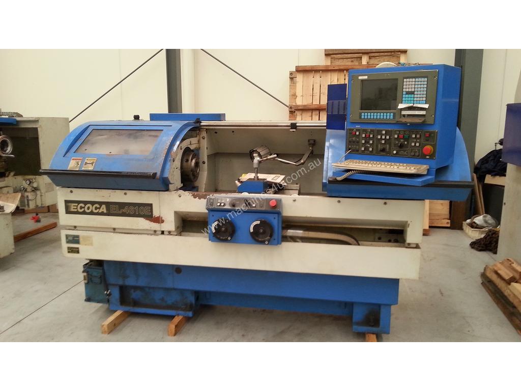

As the title suggests I am trying to decide if Kflop is for me. I am
looking to retrofit an Ecoca EL4610e lathe. It is currently equipped with
Mitsubishi M64 control system that I have been trying to get running for
the past few months. Clear one set of error codes only to be introduced to
another set, seems to be a trend. Previous owner let the memory batteries
go dead flat and all parameters etc. were lost. Time for an upgrade.
The Mitsubishi servo drives are B models which means the only communication
options are through SSCNET. To my knowledge there are only 2 adaptors
available to interface with this system. One is made by a Russian guy
(can't be posted) and works with Linuxcnc and the other is by a company
called Adlink Technologies, not sure that one will help me either. If can't
suggest an alternative I'll need to go plan B.
PLAN B
I have a set of DMM servo motors and DYN4 drivers that were slated for a
future project, retrofitting my mill. My mill is currently running so I can
use that equipment if I need to on the lathe. I will also need to replace
the Mitsubishi spindle motor as it is also a servo motor with the same
series driver. Current system is absolute, closed loop with battery pack
for holding position. Not sure if the DMM's will do this, not the end of
the world if they don't.
There are a few features on the current lathe setup I would like to retain.
Firstly, the current system controls and monitors all of the oiling duties
including a heat exchanger. It has sensors (most likely switches) to
monitor temp, pressure and level. There are numerous safety switches,
automatic door open and close, monitoring of gear range. Current spindle
setup uses 2 encoders (1 on the motor, 1 in the headstock) There is also a
set of controls on the front apron comprising of 2 handwheels (MPG), a 4
way joystick, speed select rotary switches and a few other buttons. Plus
down the track I would like to fit an ATC.
I believe Kflop will run offline (no PC), this is what I want. Am I right
in saying apart from the Kflop I will need to add a monitor (touchscreen
most likely), keyboard & mouse, power supply/s plus wire, fuses, relays
etc.
Possibly my biggest concern is in the programming (might be the wrong word)
side of things. Here I am not exactly savvy and I'm little worried I may
get stuck
Any and all advice would be greatly appreciated :) If you need any pics or
documentation I'll be happy to assist
Thanks, Mick
