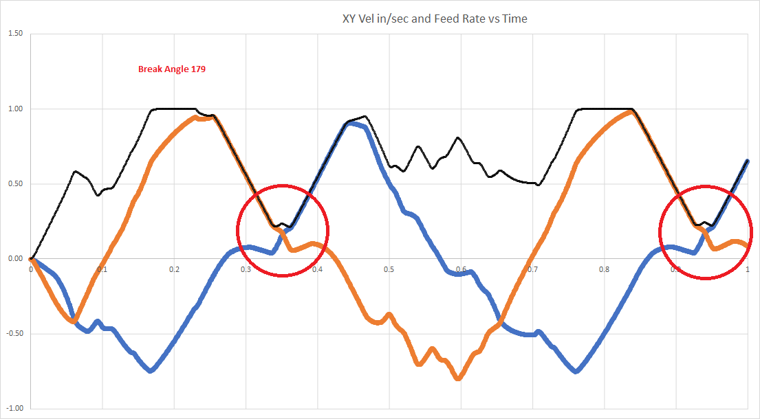

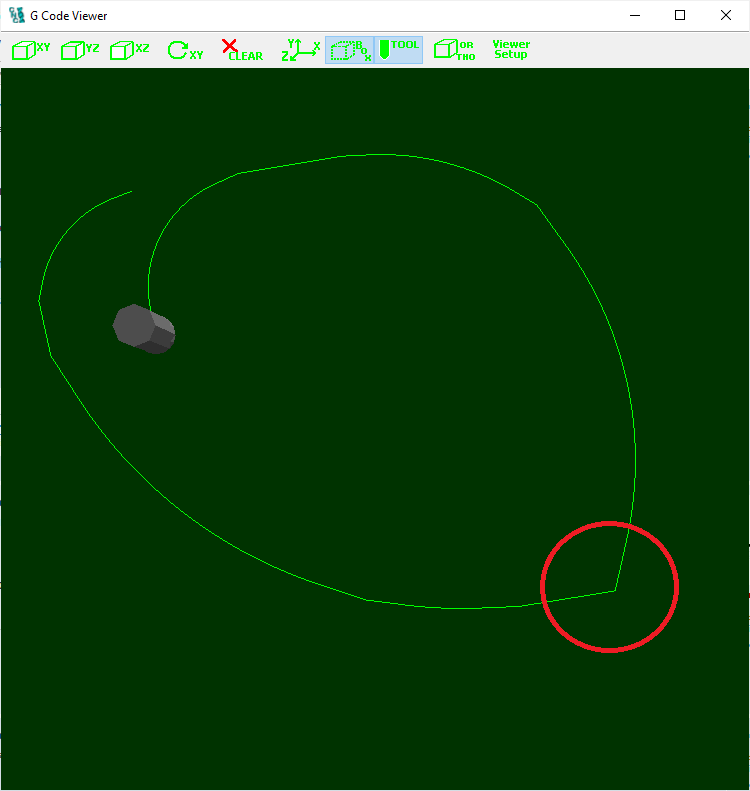

The GCode has a sharp angle every loop of probably about 70 degrees:
With break angle of 179 degrees the sharp angle is rounded (Corner Tol = 0.001) and the feedrate slows way down to ~ 12ipm. Basically full deceleration of X then full acceleration in Y:

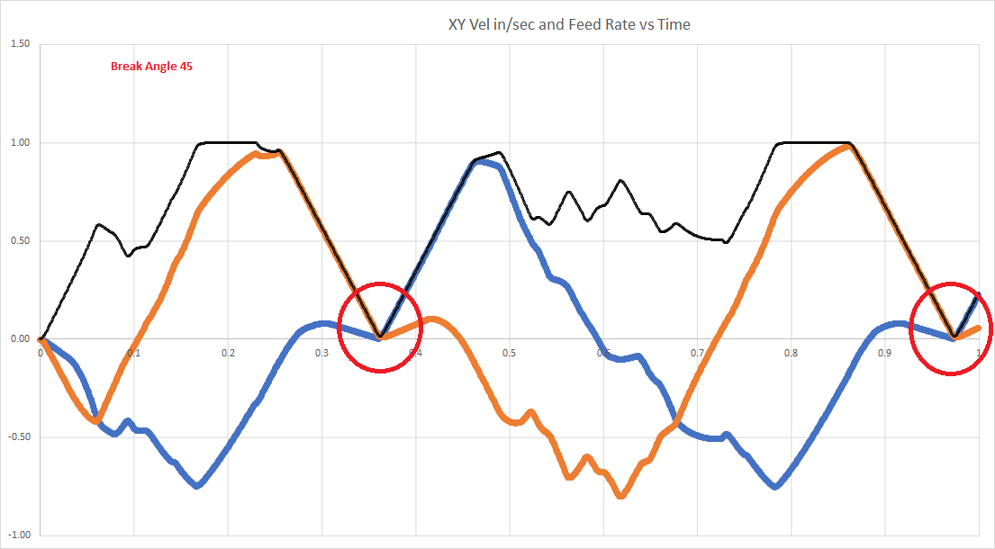

With break angle of 45 degrees there is a complete stop:
Its not clear to me why Break angle 45 would be so different or not worse actually.
Can you do something in CAD to avoid the sharp angle?

I tried all that I can think of. The default lead in/out radius for a 1/4" tool in the CAM software is .025, I increased it to .125 which didn't make any difference as far as the dynamics go, it just moved "where" it happened; neither did increasing smoothing substantially, turning it off, changing to a much looser tolerance or applying a slower feedrate to lead ins (what the arcs are). It's a 3D HSM roughing strategy so it kind of just does what it does with some adjustability. I would describe the motion as almost as harsh as using "step" in the step response screen at maximum motor velocity when it's at the worst portion of code.

Regarding Video: Its sort of hard to tell. I suppose I do hear a slight banging sound. You might have recorded with the Spindle off. We might also capture data including the XY Positions so we can see how the servo is following the different trajectories. It might be a quirk on how the servo is tuned where that trajectory start/stop rate excites some dynamic. Or maybe some mechanical cross talk between axes? Where some force on one axis induces a disturbance in the other? So decelerating one axis while accelerating the other cause an issue where when happening separately there isn't? Otherwise I have no explanation.
