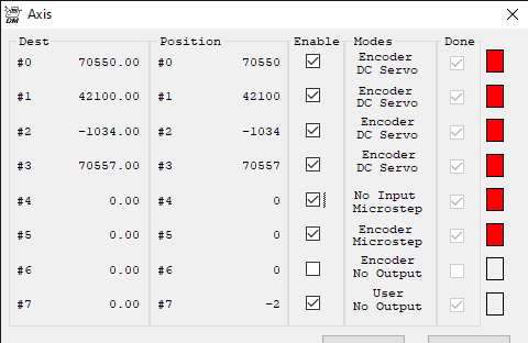

I built a plasma table about 4 yrs. ago which until now has worked flawlessly
I have a problem that started recently where the SNAP AMP faults out and will not reset itself. It acts like it is trying to drive all of the servos on reset and faults out over and over, but the destination and position are the same. Even after the power has been removed and reapplied. The only way I can get it to reset is to reboot the KFLOP. Then it works as expected. I replaced the SNAP AMP with a new one and it does the same thing. Is there a command to reset the snap amp without resetting the KFLOP so that I don't have to rehome? I am using a KFLOP with a KANALOG and a SNAP AMP with the encoders going to the KANALOG. Should I be using the encoder inputs on the SNAP AMP, or does it matter?

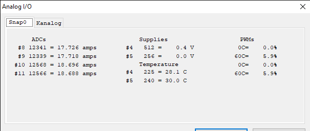

Re: Snap Amp Fault
Sometimes the Snap Amp analog screen shows red in the current monitors. They continue to show red until the KFLOP is reset, even with power disconnected. Sometimes they show nothing, even though the SNAP AMP is in a fault state. You can hear the servos pulsing as the snap amp tries to reset even with all axis disabled.

Re: Snap Amp Fault
Sorry,
That was the axis screen.
Here is the analog screen.
- KMotion - Connected 4_29_2020 10_27_56 AM.png (9.16 KiB) Viewed 4857 times

One issue I see is that on the Axis Screen Axes 4 and 5 are enabled and configured to Drive SnapAmp in Microstep Mode even though I don't see where they were ever configured. SnapAmps Output channels are all already used by axes 0-3. Do you have other programs? Did you Flash anything to KFLOP?
Re: Snap Amp Fault
Nothing has been flashed to the KFLOP. I now realize that at some point the operator somehow deleted all of the files and the backup file I had was incomplete. This was over a year ago though and it has been working. I don't know how they were getting configured to microstep, after reset they showed no input and no output. I added configuration for user input and no output on those two channels and it appears to be working now.
Thank You for your help.
