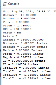

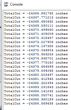

Re: Rigid Taping - DAC closed loop Spindle
Still not good,
This time program starts tapping but virtual thread over the material. It's mean starts cycle from CCW Spindle rotation and Z axis going in positive direction. Also Console buffer loops up gathering lot of data even after killing threads and Reboot! command. To get out from this state I have to restart KMotion and KMotionCNC.
Mateusz

- Posts: 2901
Hi Mateusz,
Oops, No peck case wasn't handled properly. Please try this.
- RigidTapMultiPassJogM119_v4_Jim.c
- (4.2 KiB) Downloaded 1108 times
Good one, it does work now I think now it is tested fully
Appreciate your help. You are first Company I know which is able support within hours ...on Sunday
Mateusz
