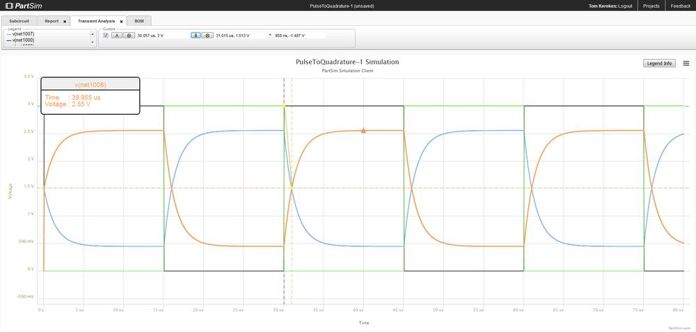

BTW I found this old Thread on cnczone.
It shows a spice simulation on how a 3V differential signal (black/green square wave traces) can be converted to a delayed 2.5V differential signal (gold/blue traces) using two 100ohm resistors and one 0.01uF capacitor.
Note that the delayed signals switch polarities ~1us (vertical dashed lines) after the original differential signal switches polarities.

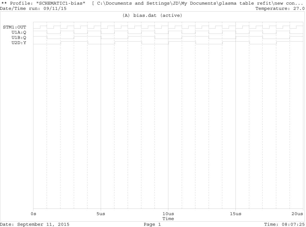

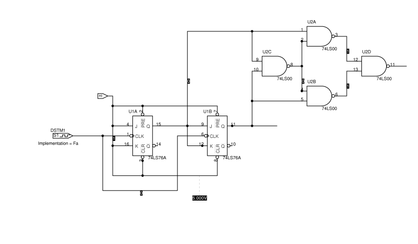

The OP describes a digital circuit design which is basically a two bit counter with exclusive-or logic to convert the counter bits to quadrature. The advantage here is the full 1MHz could be used as the circuit would naturally convert the frequency to quadrature counts/second.
