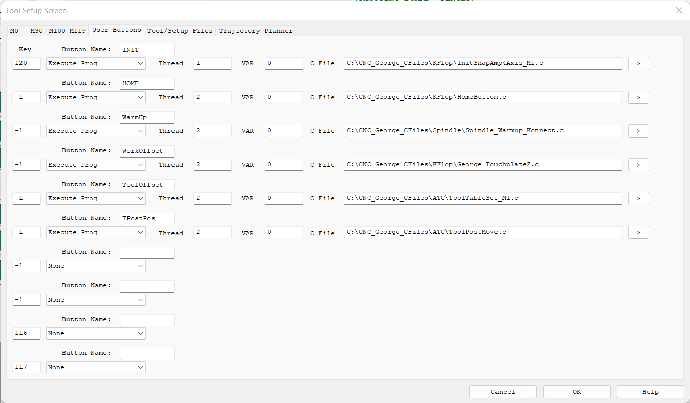

Tom, Not sure where that file is coming from. This is my setup screen which you can see references InitSnapAmp4axis_M1.c

The Data folder you sent has a GCodeConfigCNC.txt with the references to KStep. Did you send the wrong Data folder? The folder you sent is named CNC_George_CFiles copy. But your Screen references CNC_George_CFiles. Or are you using a custom, non-standard configuration file when launching KMotionCNC? I'd like to be sure I have everything matching what you are actually running before investigating.
Re: Snap Amp Faulting
Posted: Sat Feb 15, 2025 4:05 am
by axeman
Sorry for the confusion. The folder sent was copied, it should be the exact same as original but to be safe, here is the original folder.
CNC_George_CFiles.zip
(1.57 MiB) Downloaded 906 times
The init file (InitSnapAmp4axis_M1.c) is in the KFlop folder. I am not sure how you pulled up the old KStep init file reference.
