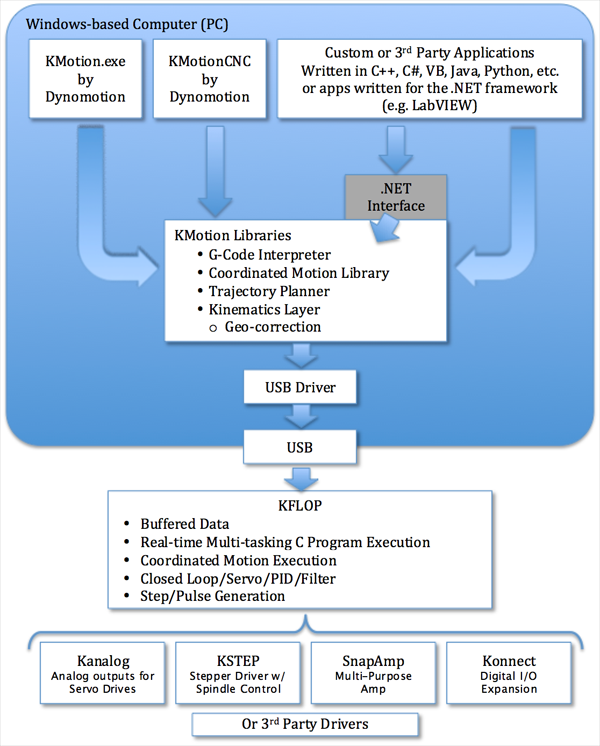

HI Tom, yes I have looked at what I would need to do to build the libraries. Unfortunately I do not have
that much programing experience to digest all of that at once. I am assuming that KmotionCNC connects to
the Kinematics program . Can you explain in plain English what the order of operation takes place between the
different programs for this to happen. Also it would help if you would tell me what language each program is written
in. Eg. .C is C, .h ? .dll ? As I said this is new to me. I will be able to get help with this but I would like to have a better
understanding before I do that.

The Kinematics are part of our Coordinated Motion Libraries, specifically GCodeInterpreter.dll, which are written in C++, Compiled with Visual Studio 2015, and execute on the PC. You should really only need to change that one number and select "Build". Maybe the diagram below may help taken from here.
