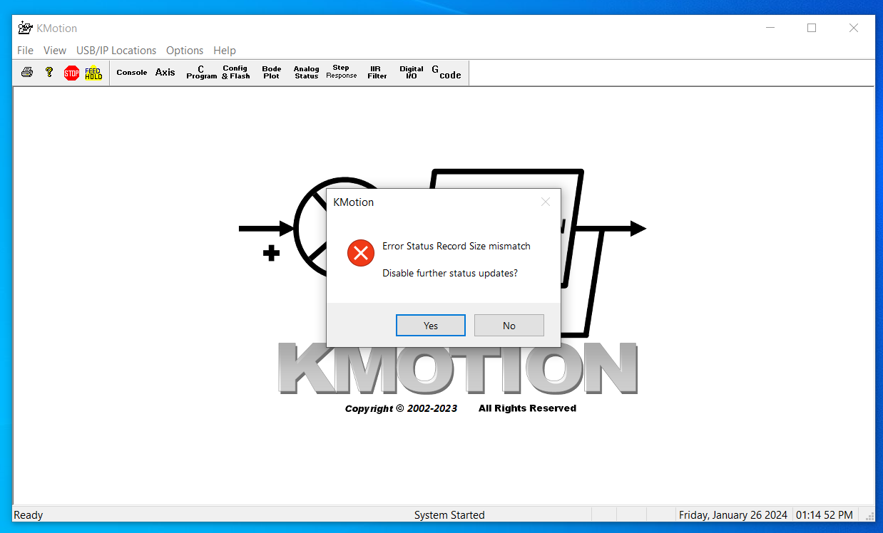

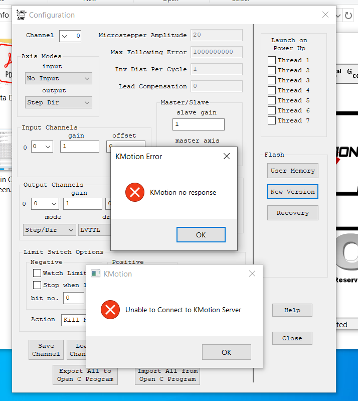

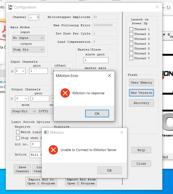

Hi Tom trying to update to 5.3.1. I get two errors
mismatch yes or no ?
Will not connect to kmotion server? please check attached.
Also help will only work on line. Do I need to remove 4.34h?
USB driver 4xx
George

Re: 5 axis CNC Router/3d printer
You'll need to ensure the KFlop/Kogna is updated to the same version of Firmware, however there is an issue if you're going from 4.xx to 5.xx - https://dynomotion.com/forum/viewtopic.php?f=9&t=1706
And also see viewtopic.php?f=12&t=1708
I used the Recovery option to update the KFlop that I'm using for testing just now.
