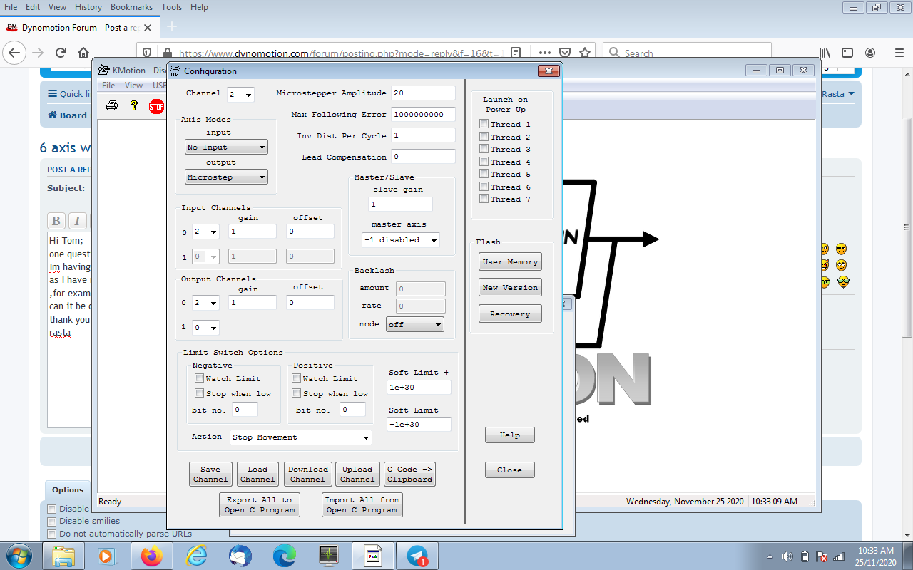

one question on microstepping setting
Im having problems with my stepper motor not being as smooth as I would like with the 10 microstep setting in the driver
as I have no other available setting ..Can you please tell me if I can use the microstepping setting in kmotion, so I can combine both
,for example , 10 microsteps in the driver multiplied , by 10 microsteps in the Kmotion setting =100.
can it be done?
thank you
rasta
can it be done?
thank you
rasta
- Posts: 2892
Re: 6 axis wire edm
Hi Rasta,
No. If your Driver has a certain step size there is nothing the Controller can do to move less than 1 step.
"Microstepping" mode is for use with our SnapAmp Driver where it controls motor coil currents directly in a sinusoidal manner that achieves very high effective microstepping.
