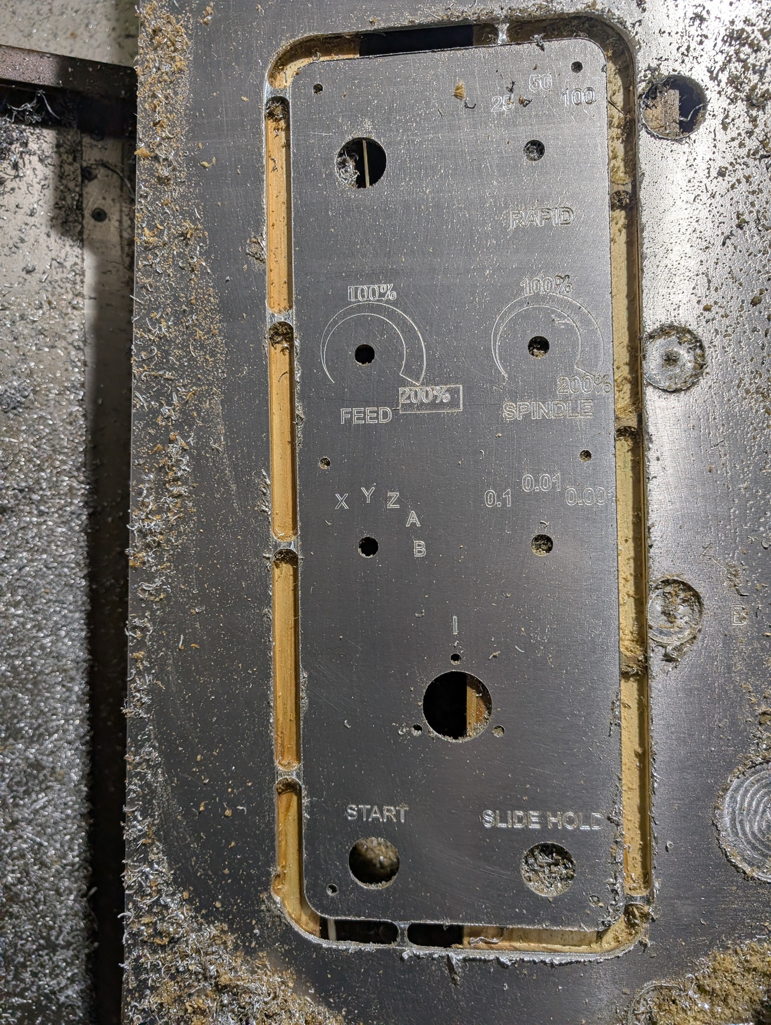

I've got it mostly running (although I had almost everything mechanical disconnected, I tend to be very anxious with new code until I've tested it thoroughly), I tested the spindle motor without air - that sure startled me (the belt slips like crazy that way, I didn't quite want to go through the trouble of getting my air compressor running [it's running now, it was broken at the time - I'm a little shop that normally doesn't need air]), but I was rather happy my Baldor VFD works. I've yet to make my keyboard as I'm getting buried working on my customer's machines (and unfortunately a few cars), but it's better than not being busy - though I'd like to finish this project to add to what I can do with the business.
