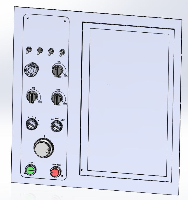

I've attached a couple images of my first draft for the operator panel (it essentially mimics what's there currently with the 88HS control) - I'll admit I'm not sure if I'll want to keep the switches - I don't really know that I have a use for them. I'm thinking I may just remove them and add an unclamp / clamp buttons as I believe BattyZ mentioned he would like to add to his machine. You'll note that I've got a 19" monitor built into the operator panel - I can go with either a touch screen or non touch screen with only a $100 difference in price (I'm leaning towards the touch screen). I would like to add the load meter into the design, though I don't yet know where I need to tie the wires into yet (I haven't looked at the wiring schematics for that specific thing yet).

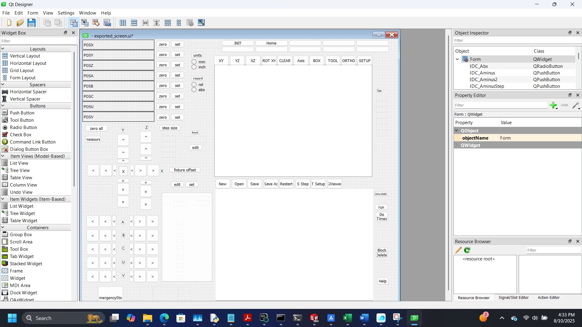

Since I've got the monitor oriented vertically I've been developing a little bit of code for playing around with the screen layouts, thus far my code converts the scr files to a ui file that I can modify in Qt Designer - I've yet to write a bit of code for converting the layout back to scr, nor have I finished developing it so it's potentially not as pretty as it could be (nor do I think I'm getting everything yet either).

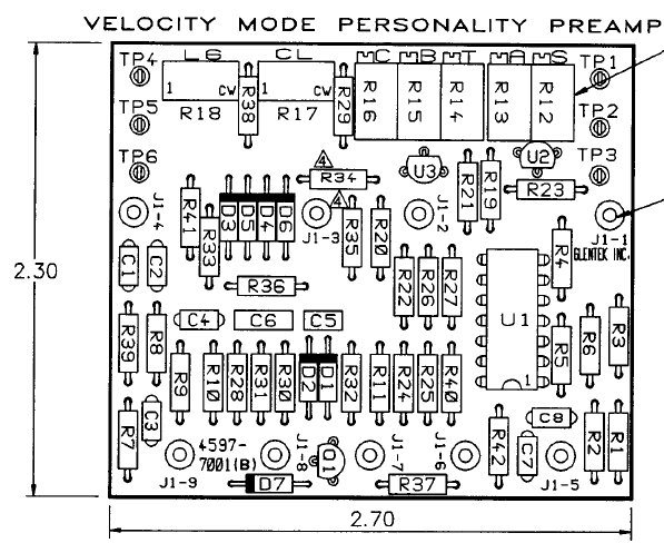

So, tomorrow I get to testing the modification Drassk had done to his amplifiers when he had his machine. I did do it a little differently though. I've attached images of a velocity personality module, in it you'll note the L6 or LG (I honestly don't know which it is) potentiometer. In the images Mmurrey or Drassk provided of the amplifier the resistor they soldiered a wire to was next to this - following this logic I assumed the equivalent one would be R18 on the schematic. When I took my multimeter to check where R6 (R6 is the resistor it looked like they soldiered to) was in relationship to the potentiometer I found it was connected to the middle pin, thus the variable output of the potentiometer. There was a resistor above that one (I'm not at the machine so I can't say what the number was), instead I cut that one (I wasn't able to desolder it unfortunately, though I didn't try hard) and soldiered to it, the reason being that it appeared as if soldering to R6 (in the current control circuit the equivalent would be R9 or in the velocity control circuit it would be R33, I could be mistaken though, this is merely how I've interpreted it) would be the same as putting signal to TP2 in the current control circuit, thus bypassing the potentiometer, I'm hoping this is why it sounded like it was difficult to tune and that soldering where I did makes it easier, as this should make it where signal still goes through the potentiometer. I'll find out tomorrow when I start really digging into tuning.

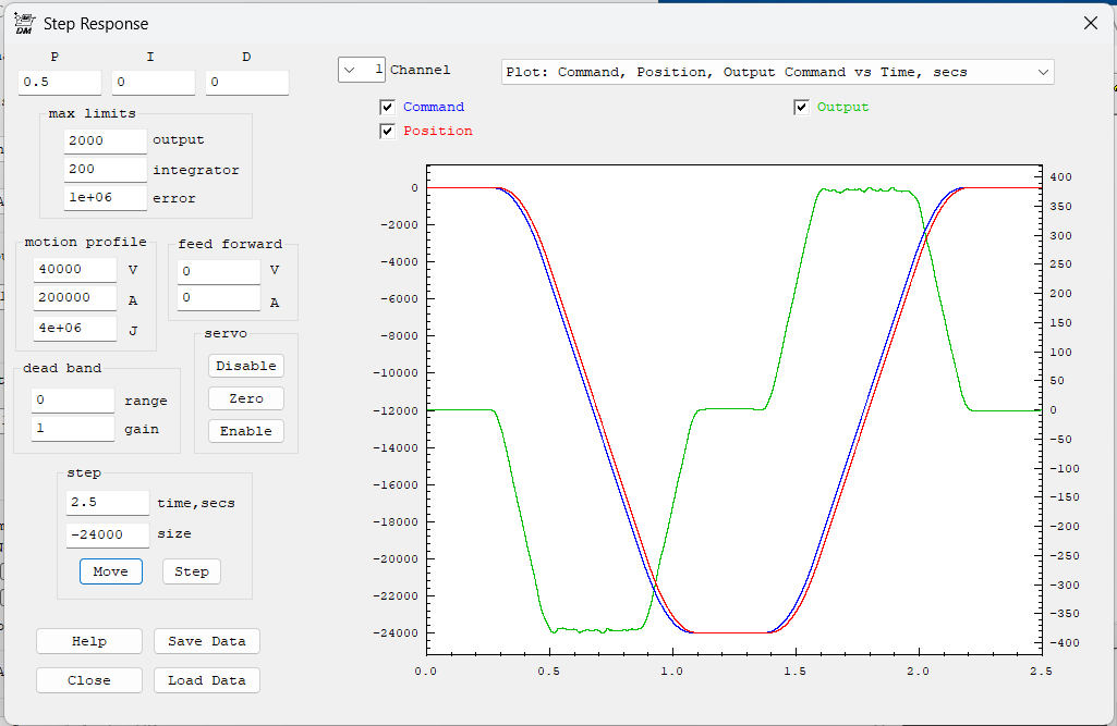

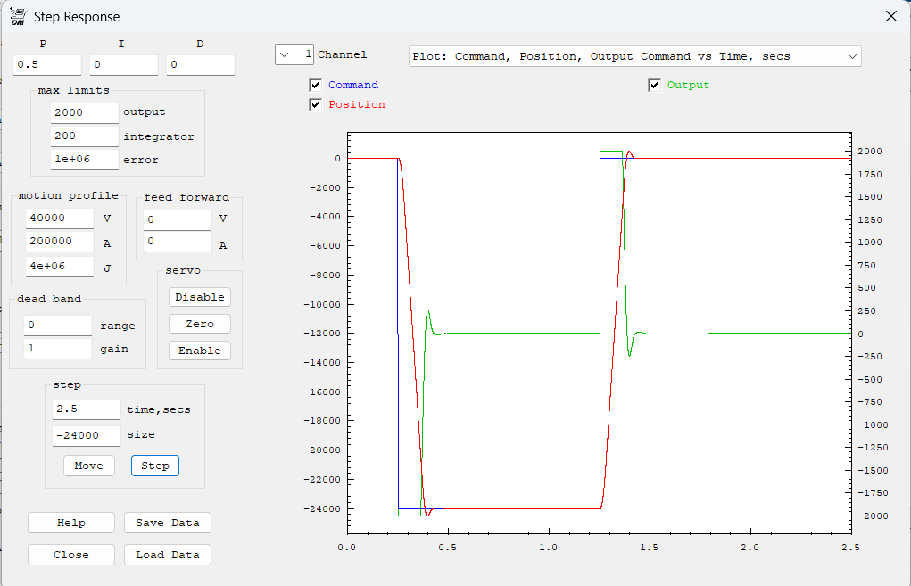

Alight, it took a bit to get it to be able to move the servos. Since everything is wired and I haven't written the configuration to the KFlop yet, I'll get to that after I confirm I've gotten the servos running decently, I had to disconnect one of my wires and connect it to ground to get K18 (on the 1100-1, it goes through one of the breakout boards I've wired, J7-5 or J1-5 [depending on which end of the cable you're looking at] is the wire number in question on the schematic) board to turn on so that K1 and K2 enabled power to the servos.
Also, I put one of the servo amplifiers back how they used to be, so no longer in Current / Torque mode (note I was able to make a motor run in current / torque mode, but I haven't tuned that way yet) and instead in the default Velocity mode. The images I've added here are for velocity control, and honestly it wasn't bad to configure, the only difference here is that I've got a programmable encoder attached to the back of the motor (I've yet to see if this will bite me later, but I'll find out). The only thing to note is that I had the tachometer wires connected in reverse originally and thus when I enabled the motor it immediately started running away - that's why it's worth doing this with the motors disconnected from the ballscrews.
I did play around with the integral and derivative portions of the PID a little, but wasn't able to really improve the performance much over just using proportional gains (it was very easy to set a gain that was way too high, the same for integral - adding a little too much integral gain had me oscillating slightly around my desired position, the same held true for proportional, though to a much greater degree). Ideally I'd like to get rid of the overshoot for the step response, but I'm a bit reluctant since I'm not sure if I want an over dampened system - I'm not sure what's best yet. I did like what I got for the move response.

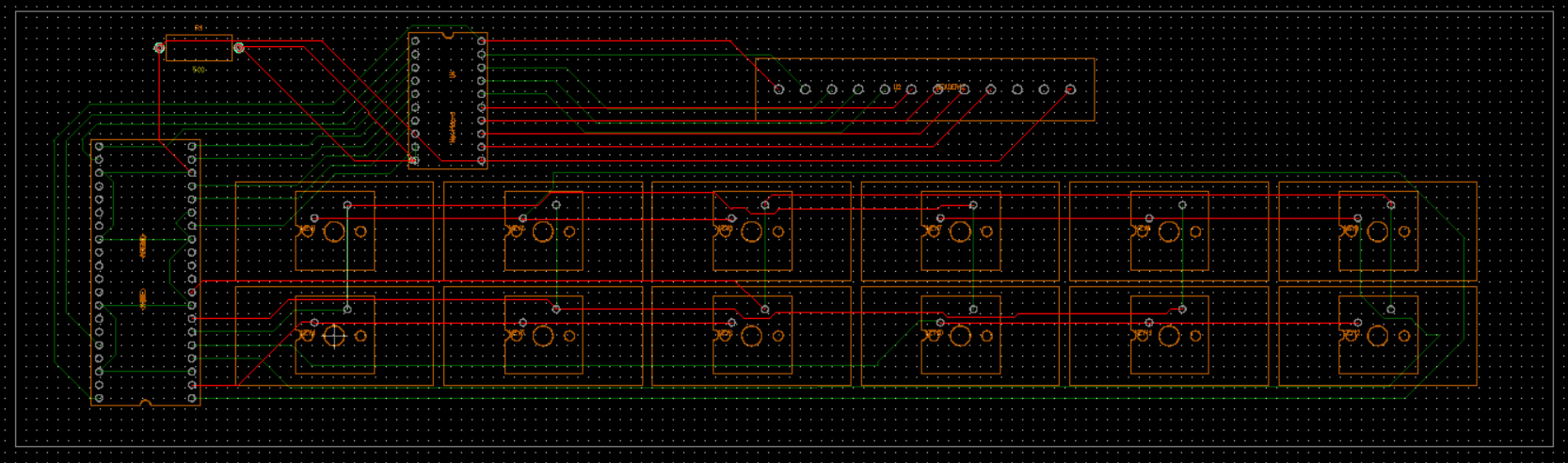

Oh, and I designed a pcb for the top 12 buttons of the keyboard, I've got the components to make a prototype and it's on my list of things to do - it's not likely as clean as it could be (as I normally don't deal with making pcb's). Yes, I still need to add screw holes for mounting it, but I figured I would test the circuit first as I've got all the necessary hardware to breadboard it.
