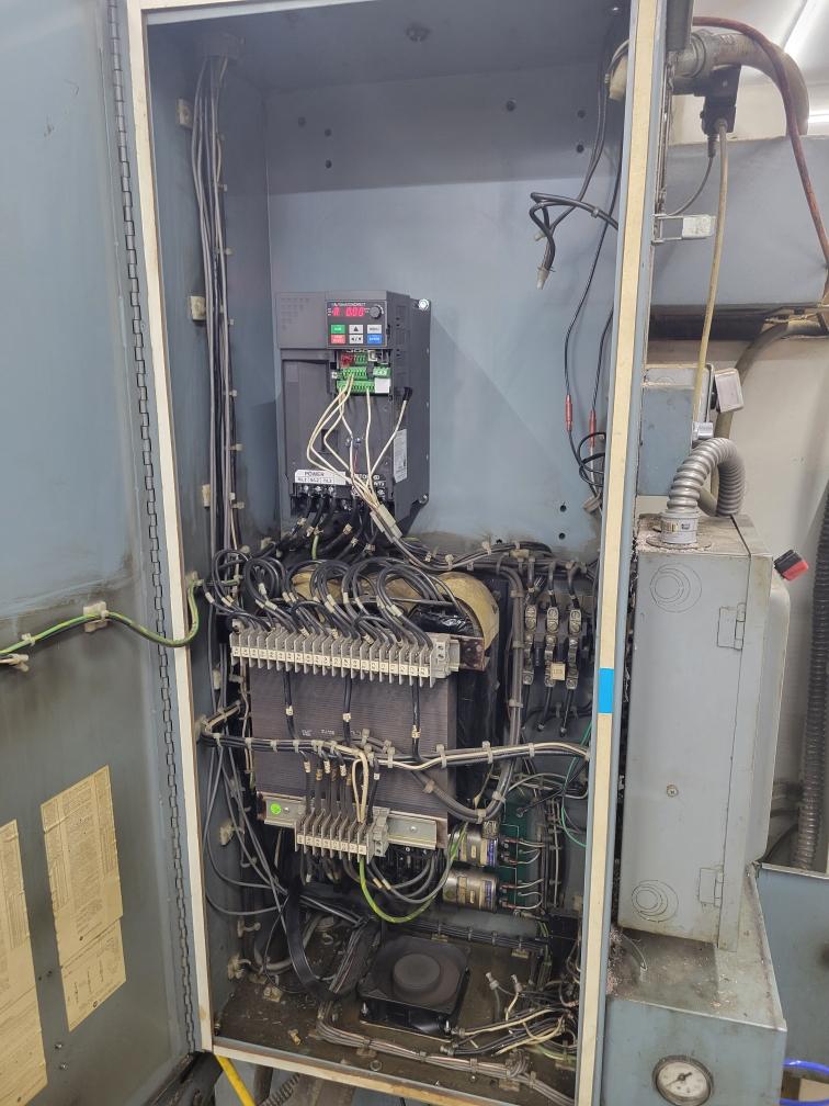

Went to start the spindle up. Dead. Fatal error on the Sweodrive...I had a feeling this day was coming.
Sourced a Durapulse GS20 drive from Automation Direct, $511.
Wired up. Tuned in via the "mx+b" line of code in the spindle.c.
Accurate +/-4 RPM from 500 rpm to 10k. (still only running on the high belt)
Nightmare of a situation turned into Daydream.
