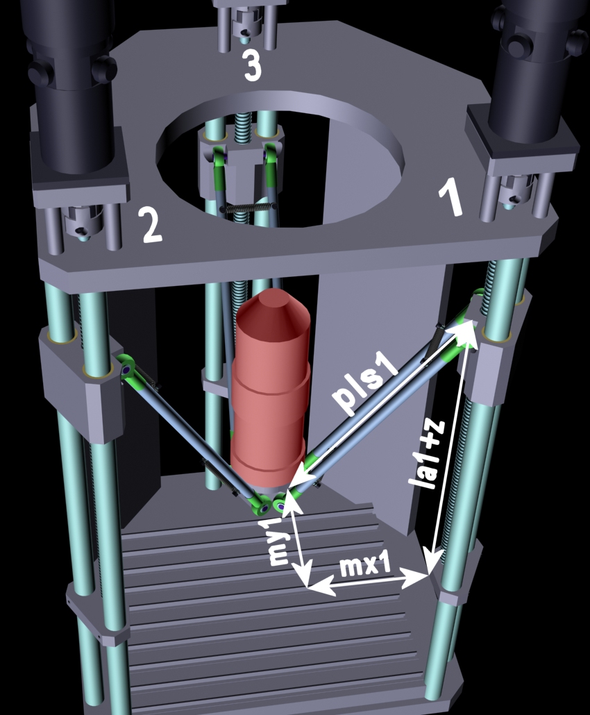

for better understanding two more files
kinematics.txt
(1018 Bytes) Downloaded 410 times
Posts: 2891
Re: tripod for miling
Post by TomKerekes » Mon Jan 14, 2019 8:40 pm
Nice illustration that really helps.
I'm curious. It seems the equations assume the mechanics are perfect. Motors mounted in perfect positions, guide rails perfectly parallel to z, link rods perfect length, etc. Do you have any idea what type of accuracy is achieved? Have you considered any further calibrations?

Post by Carsten » Wed Jan 16, 2019 7:43 pm
Well recognized Tom.
There are no geo compensation. For non linear systems it could be difficult to realize.
Therefor all parts was made on a Hermle C400 industrial milling machine.
The overall accuracy off the Tripods working space is better 0.05mm.
Dependent on travel distances I have made parts with 0.01mm tollerance.
The main reason for me to construct an build this machine was the the fascination
for nonlinare systems.
