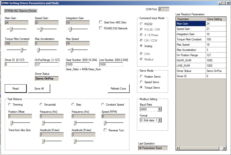

Servos.... DMM-TECH 750watt AC servos and Dyn4 drives configured to Analog Torque Mode.
Ballscrews... 25MM diameter,5mm pitch
Control Boards.... KFLOP/Kanalog/Konnect.

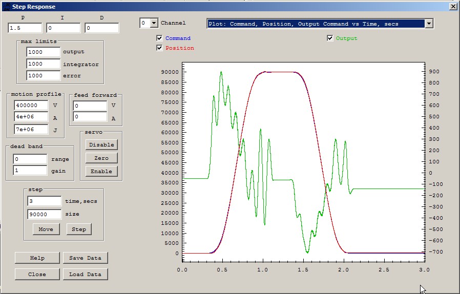

Current drive settings resolution and ballscrew pitch = 20320 counts per inch. (Drive resolution of 4000).
Attached are plots and screenshots of configuring windows.
Any idea what I need to change? I did get some better results when I had the drive resolution configured to 2000. But thought I could get better resolution than that.

So any ideas what i should change to get the plot smooth?
Troy
Posts: 2949
Re: DMM-TECH Analog Tunning
Post by TomKerekes » Tue Sep 18, 2018 10:18 pm
Hi Troy,
Torque mode servos are unlikely to work well with only P Gain. Please read this wiki article.

A couple of times I did try adding some "I" value of .001 and got runaway conditions. Also tried a value of .0001 which cause some oscillation. But, am going to start over with tuning and follow the steps in link. For some reason i always forget where that tuning info is. :roll:
In step 4 it talks about Reducing Max Following Error Limit to small value. Is this the parameter on the Config&Flash window? Or, the Max Limits Error on the Step Response window?
Thanks again,
Troy
Posts: 2949
Post by TomKerekes » Wed Sep 19, 2018 2:04 am
Hi Troy,
That article attempts to explain that a Torque Mode system like yours is inherently unstable with just P gain. If it weren't for some mechanical friction somewhere it wouldn't be stable at all. I Gain makes the system less stable so no surprise that doesn't help. The first thing to do is to add the D Gain with a helpful Low Pass filter to stabilize the system
Max Following Error on the Configuration Screen triggers a Fault/Disable if the following error ever exceeds the specified value.
Max Limit Error on the Step Response Screen causes the servo to treat errors larger than the Limit as if they were only the value of the Limit.
BTW if you ever want to see a description of any parameter click "Help" and then click the Parameter.

Just to compare things. I tried step,dir signal. But have a issue. in closed loop step, the green output line in plot stays flat. I show encoder counts.
Any idea?
Troy

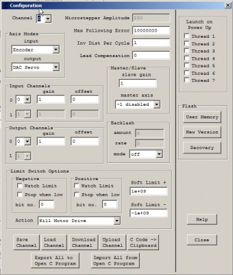

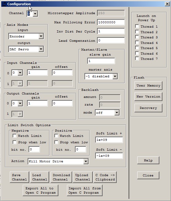

Any idea?
In "CL Step" there should be servo Output (green) for whatever the correction to the commanded position is. Were your PID gains all zero? Max Limits Zero? Please Post your settings from the Step Response, Config/Flash, and Filters Screens.
