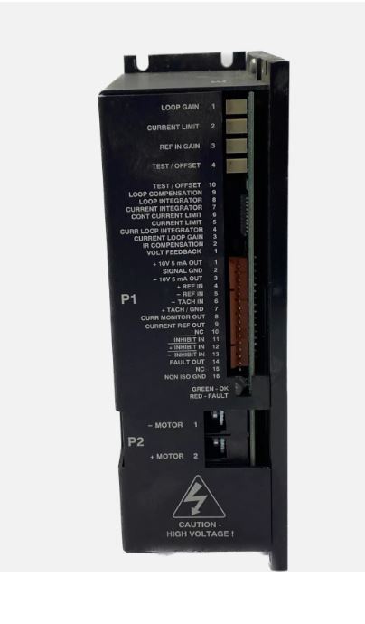

1 should be torque drive i believe
"Advance Motion Controls 30-125VAC Brush Type PWM Servo Amplifier 16A20ACT"
2 when i give it a lot of bolt ramming load it will DAC up to about 7 volt output
