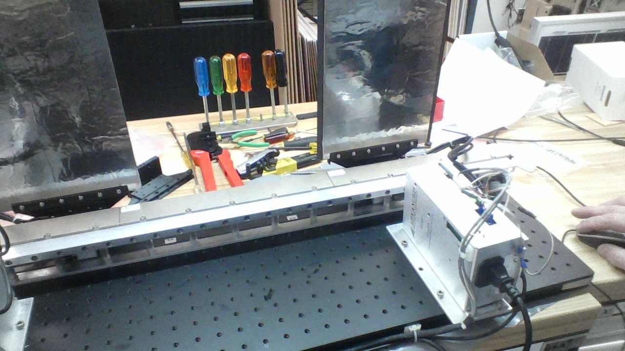

The system is as follows: an H2W Tech BLDM-B02 https://www.h2wtech.com/product/brushle ... r/BLDM-B02 linear motor driven by an AMC AB30A200AC servo amp https://www.a-m-c.com/products/?page=pr ... AB30A200AC, using +/-10V inputs and Renislaw LM10 magnetic encoders https://www.rls.si/eng/lm10-linear-magn ... der-system for feedback. This ensemble is driven by a KFLOP/KANALOG through the DAC output using the encoder feedback (differential RS-422). I can move the stage manually and see the position counter change properly on the configuration screen nicely.
The task is simple: move the stage from point A to point B. Right now things are pretty much at the default setting, although I had to increase the output limit significantly to get the acceleration I need. Using the Step Response screen, I can feed it a position step and the stage takes off nicely. However, it doesn't stop when it reaches the commanded position! It doesn't even slow down. Obviously, I'm missing something, but haven't a clue as to what it could be. Any suggestions would be appreciated.

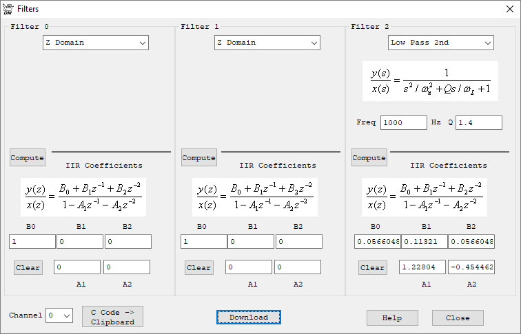

That seems low. Consider trying 500-1000Hz Q=1.4Now I can't get this thing to stop oscillating. I have the following settings:

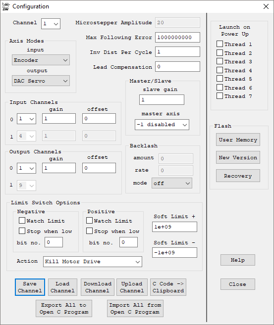

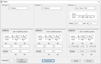

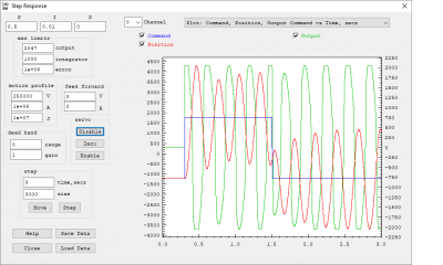

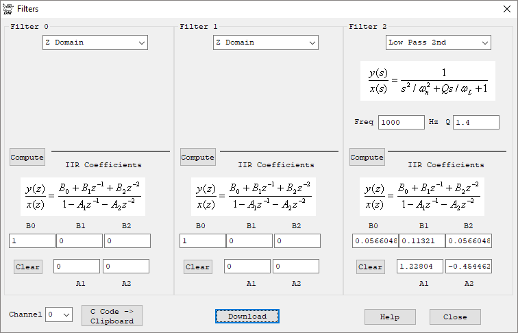

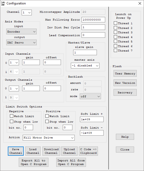

Here are screenshots of my setup:
Configuration IIR Filters Step Response Setup The deadband is due to stiction in the bearing carriages.
- Posts: 2946
Re: Step response doesn't stop
Hi pblase,
Unstable.
It seems your amplifier is in torque/acceleration mode as the Position (red) is 180 degrees (2nd derivative) out of phase from the command (green).
Did you read the previous link explaining why D Gain is needed in this case? It would be helpful if you explained what you have read, what you understand, and what you have tried.
Note it is usually best to test "Move" not "Step". Especially steps of thousands of counts that put the amplifier in saturation, which wouldn't occur in normal operation.
Unstable.
