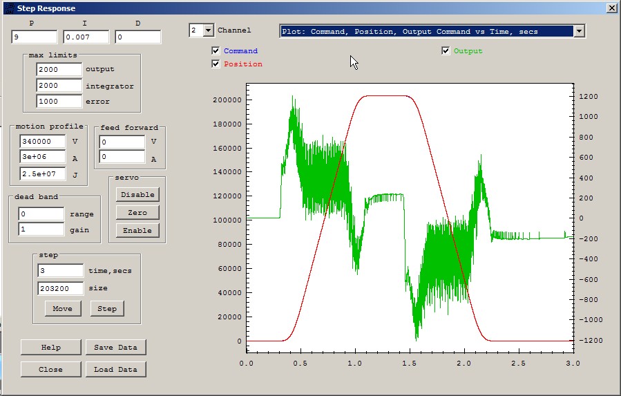

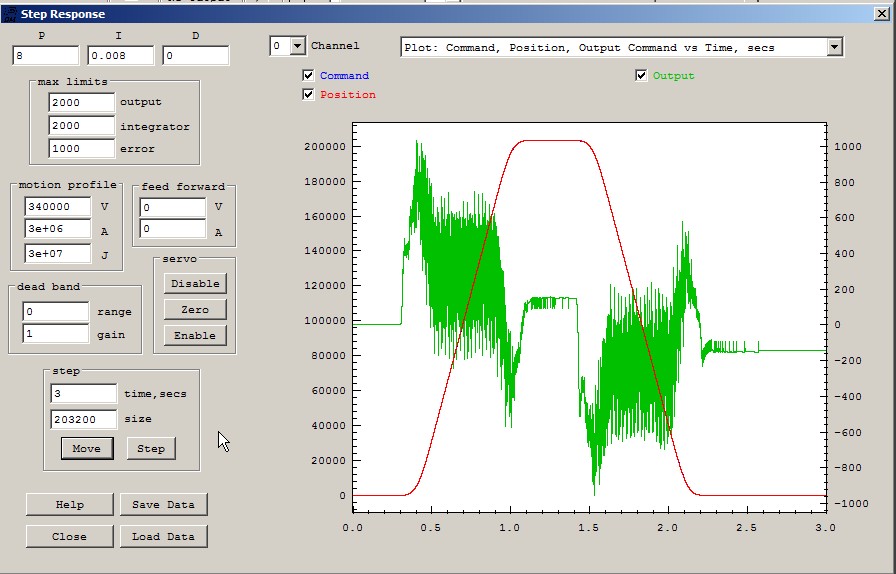

So i made some changes as you said and checked voltages. The voltages looks like the highest is 5V and average around3.5-4v on the Analog screen with DAC highest at 1100 and average about 550-650. This was done running a test move of 5" or 203200 counts.
I have also made some other changes. The drive resolution is now set to 40640 counts per inch.
And after you said earlier about the 886ipm?? And mmurray pointed out the speed for this small of machine. I figured it takes a few inches to reach the 800IPM i was shooting for which means slower ramp up and down.And that it WOULD be best to lower rapid rate and shorten the distance to hit top speed, decreasing the ramp up and down time. Unless iam missing something this would actually make the machine faster, especially on short moves, which is what the most of this machine is.
Then i did some more tuning .Attached is the results of latest configuring and tuning for X and Z.
What do think of the results?

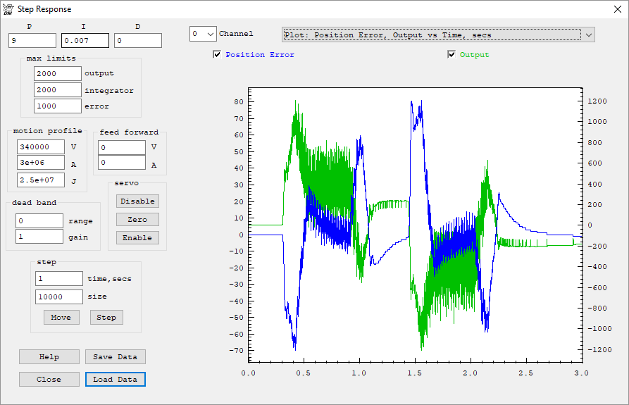

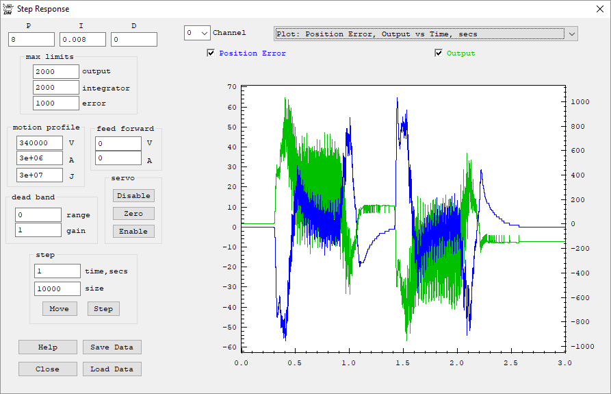

Hi Troy,
Here are the error plots. Not bad. You can probably use Feed Forward to reduce the errors further.
I noticed you have a 1st order Low Pass filter at 500Hz. Normally we use a 2nd order 500Hz Q=1.4 to suppress the spikes in the output a bit more.

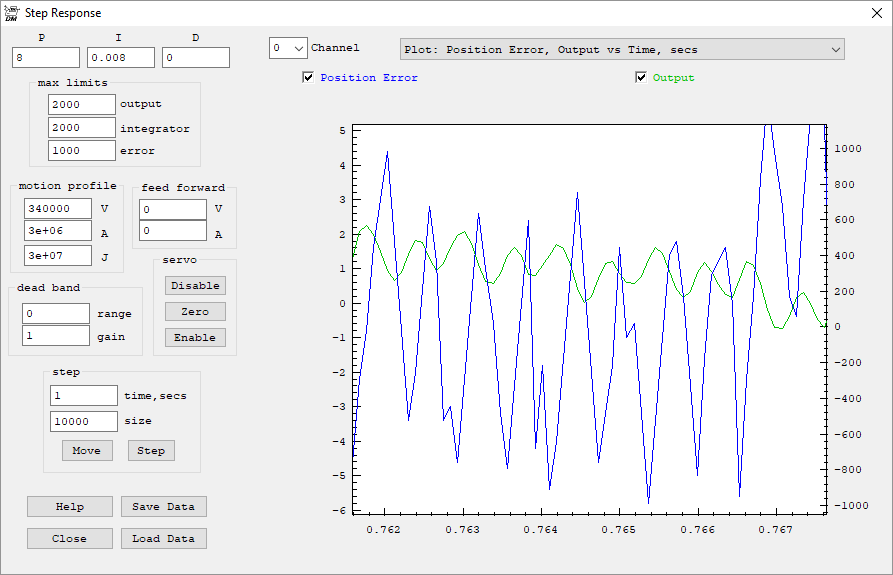

I noticed both axes have a strange, small, ~1500Hz oscillation. Probably not a big issue as the Motors/Drives won't respond at that frequency. I suspect that is a quirk with the drives. They might be reading their absolute encoder every so often and output a burst of pulses periodically to simulate an incremental encoder or something.

When reading the error plot which should i focus as the overall error, the height of tallest spikes or the difference between the 2 lines on the graduation at 0 on left of window? If iam figuring it correct i have between .0002" to .0005". Is this what you get?

Hi Troy,
I see +/-80 count which would be +/- 80/40640 ~ +/- 0.002 inches
Again Feed Forward should reduce the errors during the accelerations.
Well the plot is of the error so the value is how much the axis is out of position (according to the encoder). So when the value spikes to +80 that means your axis is in the wrong position by 80 counts. So you might want to consider the biggest spike the biggest error. But it all depends on your requirements. Maybe you don't care about when the axis starts and stops. Or maybe since this is a rapid you don't really care at all as long as it is in position and settled at the end.When reading the error plot which should i focus as the overall error, the height of tallest spikes or the difference between the 2 lines on the graduation at 0 on left of window? If iam figuring it correct i have between .0002" to .0005". Is this what you get?

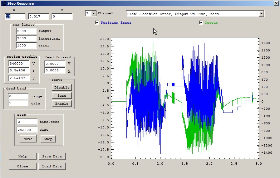

Did some more tuning now that i know i was looking at the error plots wrong. Added the Feed Forward and replaced filter with 2nd order. This filter made motors quieter ,idle and running. Feed Forward helped a lot.
Now i figure it is within .0005". This is what i was expecting out of this machine, before its been hand scrapped and glass scales on each axis.
Attached is of Z axis.
