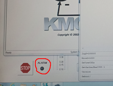

Most likely noise on the EStop or MPG_Estop inputs were disabling all the Axes.
Tarasevih
Posts: 101
Re: Reset kflop board
Post by Tarasevih » Wed Mar 27, 2024 6:57 pm
In this case, the bit (Estop_Bit) should have been triggered.
if (!ReadBit(Estop) || !ReadBit(MPG_Estop))  //!chan[AXISX].Enable || !chan[AXISYA].Enable || !chan[AXISYB].Enable || !chan[AXISZ].Enable ||
			SetBit(Estop_Bit);
			ClearBit(ENABLE_MPG);
			ClearBit(Spindle_CW);
			ClearBit(23);        //Поднимем датчик поиска меток
			ClearBit(1055);      //Отменим готовность датчика к поиску метки
			ClearBit(19);        //Поднимем щетку
			ClearBit(1040);      //Выключим режим New Tool
			ClearBit(1041);      //Потушим бит освобождения шпинделя
			if (ch0->Enable)DisableAxis(0);
			if (ch1->Enable)DisableAxis(1);
			if (ch2->Enable)DisableAxis(2);
			if (ch3->Enable)DisableAxis(3);
With appropriate indication.
But this was not the case.
Posts: 2948
Post by TomKerekes » Wed Mar 27, 2024 7:49 pm
Hi Taras,
Is the ALARM Estop_Bit 1030 ?
If so, then I think when the noise glitch went away the bit would be cleared before you could ever see it on the screen.
			SetBit(Estop_Bit);
		else ClearBit(Estop_Bit);   //<<<<<<<<<<<<<<<<<<<<<<=======================
Tarasevih
Posts: 101
Post by Tarasevih » Thu Mar 28, 2024 5:43 am
Hi Tom.
Tom you're right.
In order to notice this it was necessary to remove it (else)
Can you tell me how to programmatically filter out short pulses at the Estop and MPG_Estop input?
I will be very grateful.
Taras.
Posts: 2948
Post by TomKerekes » Thu Mar 28, 2024 7:25 pm
Hi Taras,
Its better to eliminate noise in hardware. But you might look at the Debounce function in the ExternalButtons.c example. It samples a value each Time Slice and outputs +1 or -1 when the value has changed and been stable for N samples.
